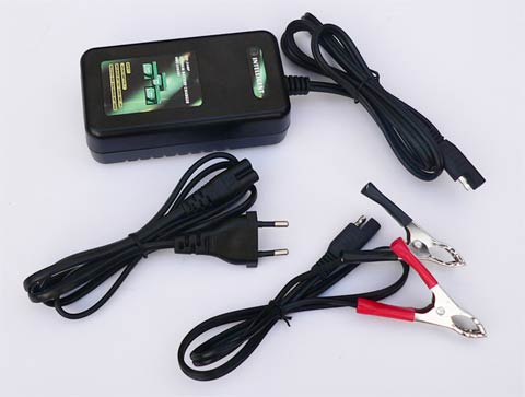

    My Anniversario came with a change to the standard battery normally reserved for the standard 1299, in that it came with a Lithium-Ion Battery. The bike also came with the cheapest feeling and looking charger you could imagine and because of this it concerns me somewhat leaving the battery on charge for extended periods of time.
    I have an Optimate4 Dual Program charger and used this on my previous 11/1299 but this was on a normal battery. The dual functionality of this charger means I can connect it through the CAN-BUS connector however, can someone confirm that "this doesn't mean I can charge the Lithium-Ion Battery through the CAN-BUS". I'm guessing not, and I should invest in the Optimate Lithium or similar.
    Thanks in advance of any responses. :upyeah:
  2. The limiting factor for the Shido lithium battery is the charging voltage which must not exceed 14.9v so theoretically any charger that in any mode charges at less than that should be okay. I use a CTek 0.8 on my lithium battery but not to maintain it, only charge it. For the winter I will be refitting the OE lead acid battery and using the Ducati maintainer charger which has been fine on the Multistrada and Diavel. Andy

  5. CTEK do a Lithium specific charger ...
    LITHIUM XS

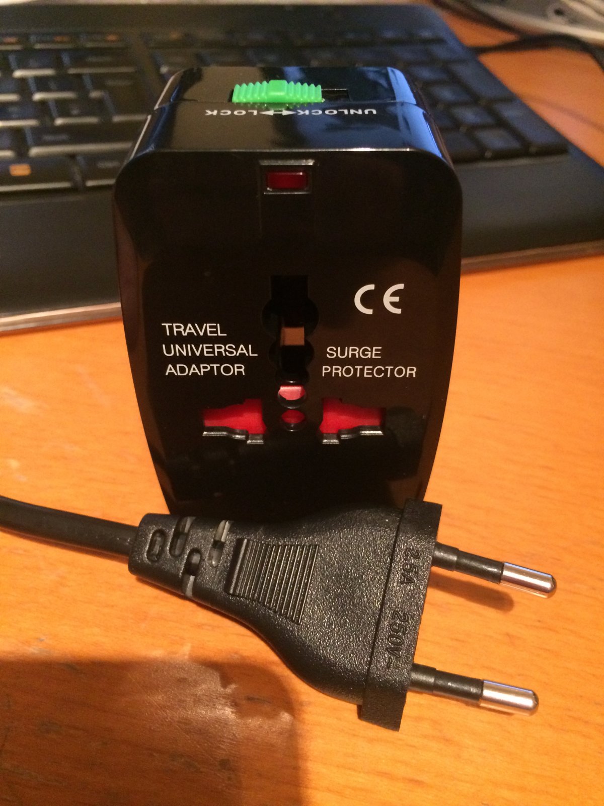

  6. Yes it did come with the bike. And yes, one has to assume it is designed to be the right piece of kit for the bike. Albeit I don't think it was "designed" for the bike, rather it was sufficient for the bike more like. The charger itself looks okay to be fair, it's the adapter that comes with it which is terrible. The main charging unit comes with a shaver plug on the end of it and that plugs into a poorly made multi adapter, which then plugs into a 13amp socket . The shaver plug connects very loosely into the adapter and only makes a positive connection 25% of the time. When it finally makes a connection and lights the LED, if you breath near it, it looses connection. Basically, the adapter makes it look like it's a poor quality piece of kit.
    I'm a fairly relaxed and easy going bloke and don't get wound up by much, but some things do annoy me and when you pay a lot of money for a bike you'd like to think the same amount of effort goes into sourcing the right components to be used with the bike as the bike components themselves. It is a premium brand by all accounts so I don't think I'm being unduly unfair. I guess there is a reason why none of the documentation told you what charger it was that came with the bike. Becasue of this I'm taking the view that something of better quality and doesn't look like its going to burn the house down would be in order. :)

  9. Mine fits really tightly. In fact at first I'd have said really tightly. But now I've got the hang of connecting it so it snaps in. And it connects all the time.
    Either the bike connection is gash or the charger one is. Get it checked when it goes for its first service.

  12. Cut the end of the lead with the two-pin power outlet. Add a normal uk fused plug, job done.

    I charge them with the Opitmate LiFeP04 chargers, which are also excellent and condition them best to optimise their life span. Just don't let them discharge fully - you can save them, but it's hit or miss!!
