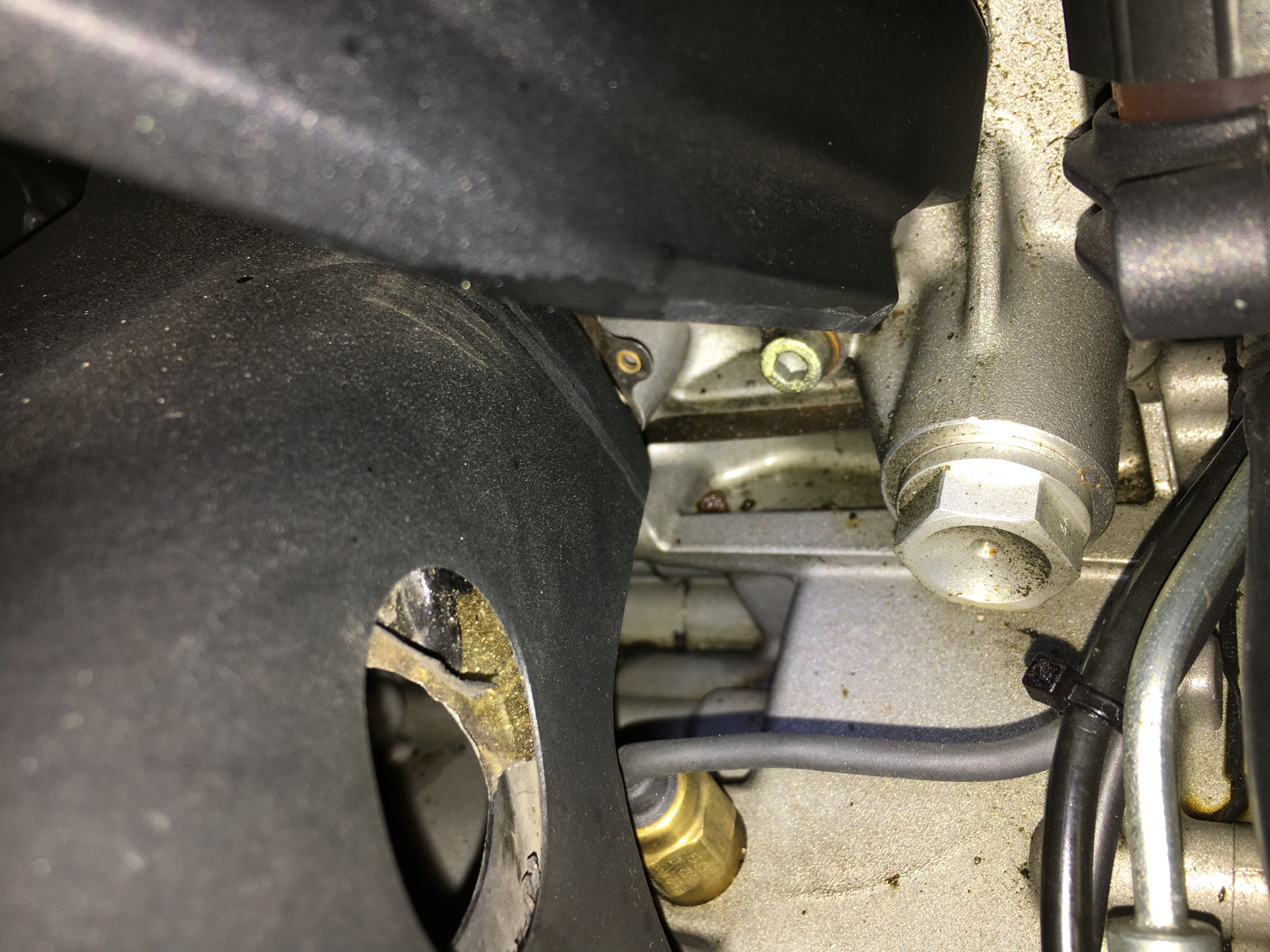

  1. I've got got a small oil leak on right hand side of the bike but where's it coming from?

  3. Is that big nut
    Your
    Timing chain tensioner ?
    Maybe from the alloy washer under it?

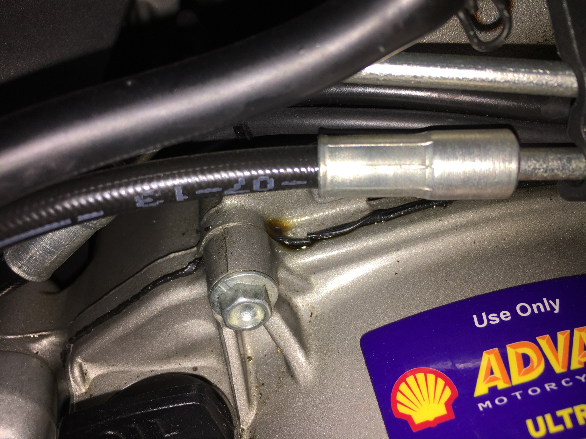

  4. It was the rocker cover gasket that was leaking I replaced the gasket and used three bond where the leaking was coming from, it was not a difficult job although you have to take the rear sub-frame off.
