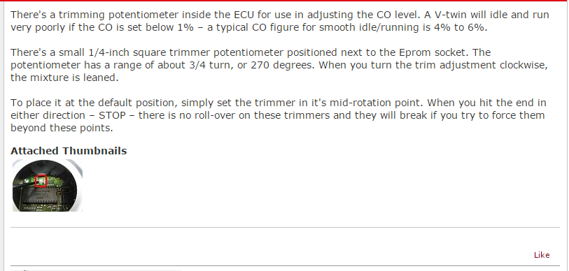

  1. In my view, you don't NEED a power commander or a remap.
    Ensure you've got the correct EPROM fitted (DP08054/11) get the balance and CO set up correctly and I guarantee that if there isn't air leaks or some other underlying problem it will run very well!
    One other thing - TPS value on 996 should be 423 mvolt

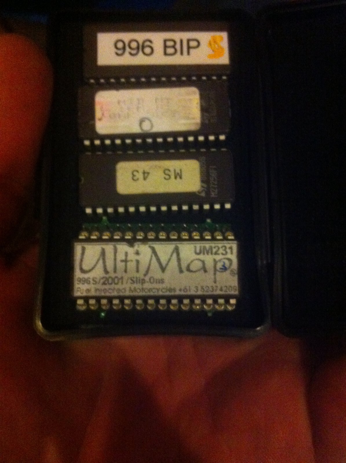

  7. DP08054/11 is for a 2001 996 with 50mm Termi's?
  8. Yep, part nr was G08 054-11 or maybe find a s/h FIM EPROM
  9. Is it the 1.6m ecu?
    My old 748R did exactly as you describe. I enriched it up as below and it was good as gold...

  13. I have one sat here amongst my spares from my 996. If CR is interested I'm up for selling. Also have a set of sps cams that would go in nicely ;-)
  14. For a bog standard 996 2001 with the 45mm to 50mm system?
    Don't want the cams thanks.
  15. Yeah, will dig out the ultimap number if you want to double check
  16. Looks like it's for a 996s, so unless you had the sps cams it'd be wrong. Sorry!
    UM231 ultimap
  17. Thanks anyway.
  18. Um, not sure, I get a bit confused with the ECU's. It's the older type I think :-/
  19. So you just turned it up a bit? Did you actually set to a level and measure or just turn it a little bit and try it?
