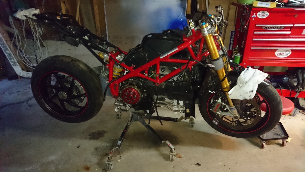

  4. Airbox off last night. What a pain to remove that! So many connectors, and clamps! I'm not looking forward to replacing it!
    New throttle cables installed (old ones were damaged in a crash)
    Frame tab (where the brake side clip on installs) welded on. Bought the motoholders tab and had it welded on (I suck at welding). As a bonus it gives me some adjustablilty with the rearsets.
    Couple more bolts safety drilled.
    Not bad considering it was pretty cold over here! (-2).
    Heres the new rearset tab. Still have to clean it up and paint but slowly getting there.

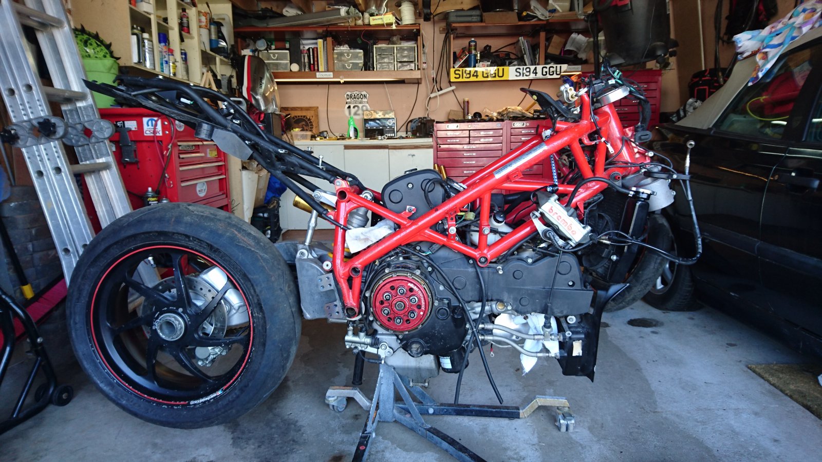

  7. Awesome weather finally here. 23c and sunny.
    Installed the 70mm Termi race system. WOW it looks huge!
    Installed racing stay and cluster.
    Reinstalled airbox (NOT FUN). Brute force and ignorance works best.
    Installed PZracing GPS and gear indicator. Took forever to find the connector for the GPS! I would never have found either if it wasnt for the Ducati forums!
    Fitted the traction control module and new rearset on brake side.
    Removed and replaced old oil sight glass (was damaged in crash). It was WAY easier to replace compared to my BMW.
    Drilled the oil plug (had to drill on an angle) and oil/filter change.
    GBracing engine guard installed.
    Its way more fun seeing her getting put back together! I can't wait to finally get to reprogram and hear her fire up!

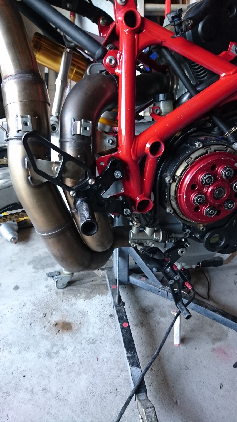

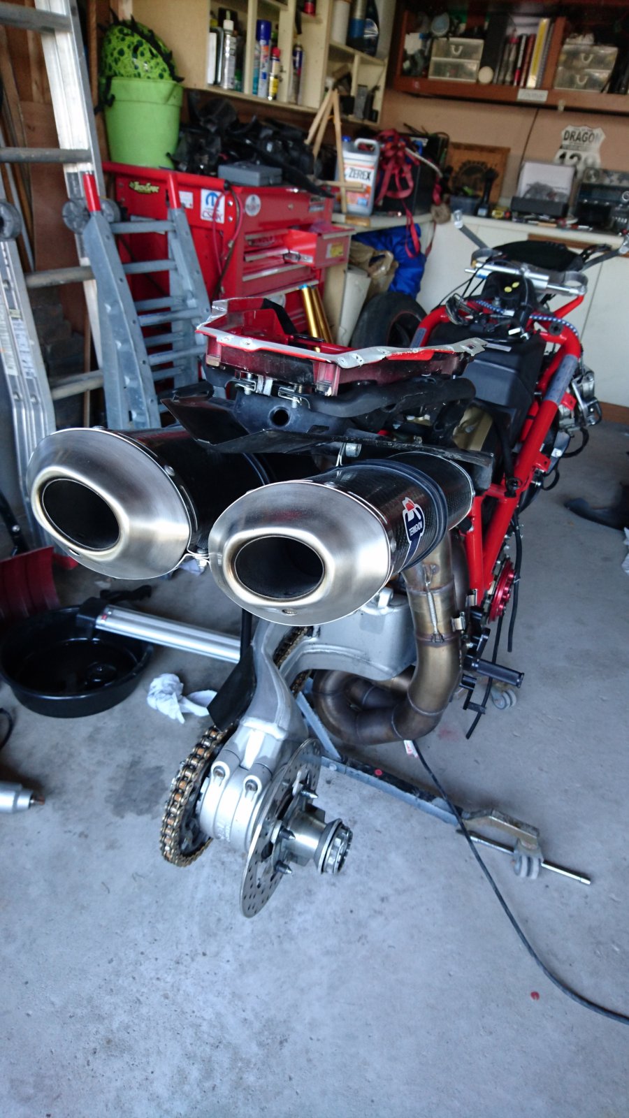

  13. Pics
    Shot of exhaust (baby got back)
    Shot of brake side rearset mounted on new tabs. As a ghetto side note, I used tractor/farm implement red spray paint. The color was pretty close! The paint on the frame had a lot of chips out of it so I just wanted to get it covered.
  14. Tractor yep sounds about right :upyeah:
  15. When ever I see a 70mm pipe i'm always struck by how big it looks. That pick doesn't change that feeling. huuuuge.
