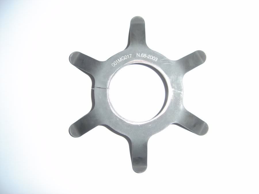

  9. Take the pressure plate off and check the spider spring isn't broken, you should be able to tell without having to remove the drum nut.
  10. spider spring being the copper coloured thing? thats looks slightly like spiderman?

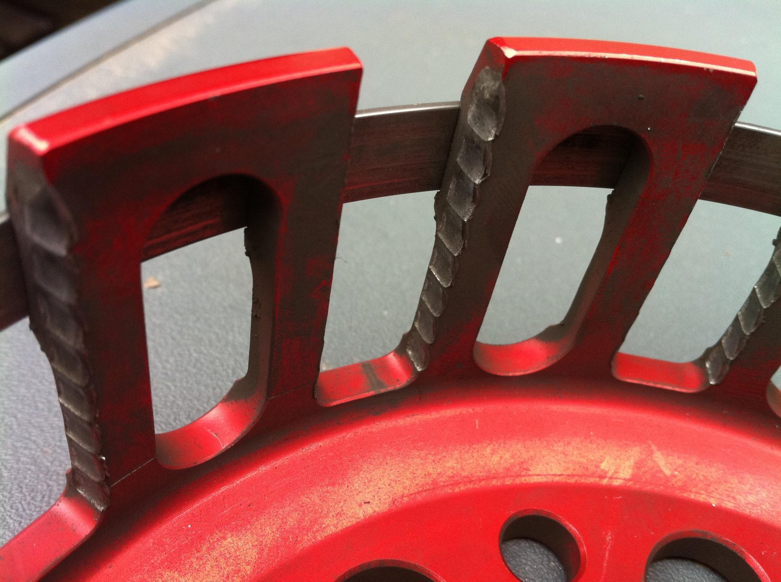

  16. Check the basket slots aren't badly ridged/worn, if they are they can grab the friction plates preventing a nice smooth operation

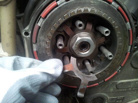

  17. Yeah this bit, check carefully notice this one has a crack in it .... not good, when mine went it was in 3 pieces
  18. Yep - what he said....i think mine are starting to get a bit "ridgey" - got a spare though....
  19. And this is what a worn basket looks like
  20. wow thanks guys. ill maybe take a look myself, maybe go to a garage. im good with tools, but dont want to make it worse [emoji16] i mean, torques etc i just have no clue. but i can have a look if i grow a pair.
    you think theres somthing wrong then. its definatly not suppose to do it
