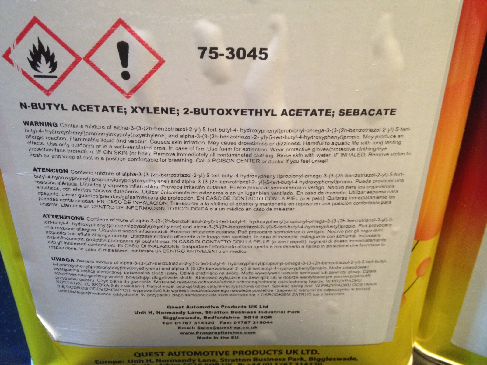

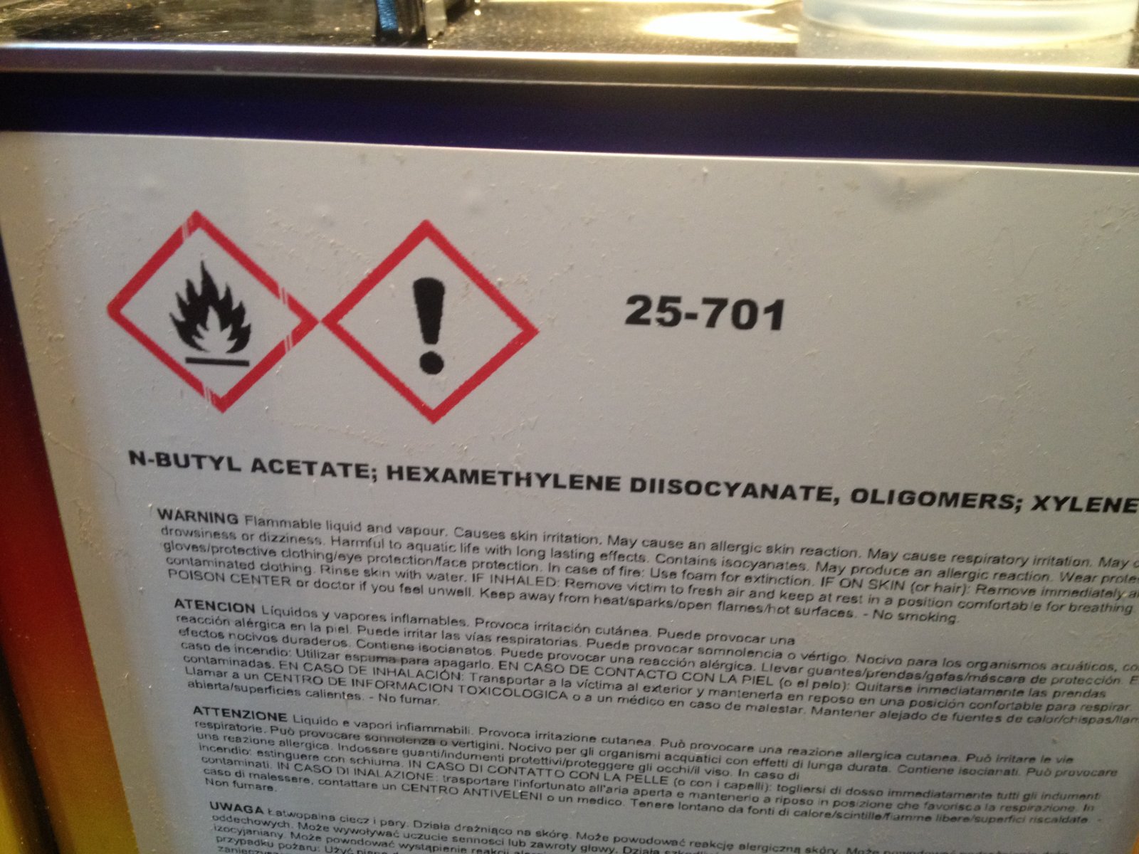

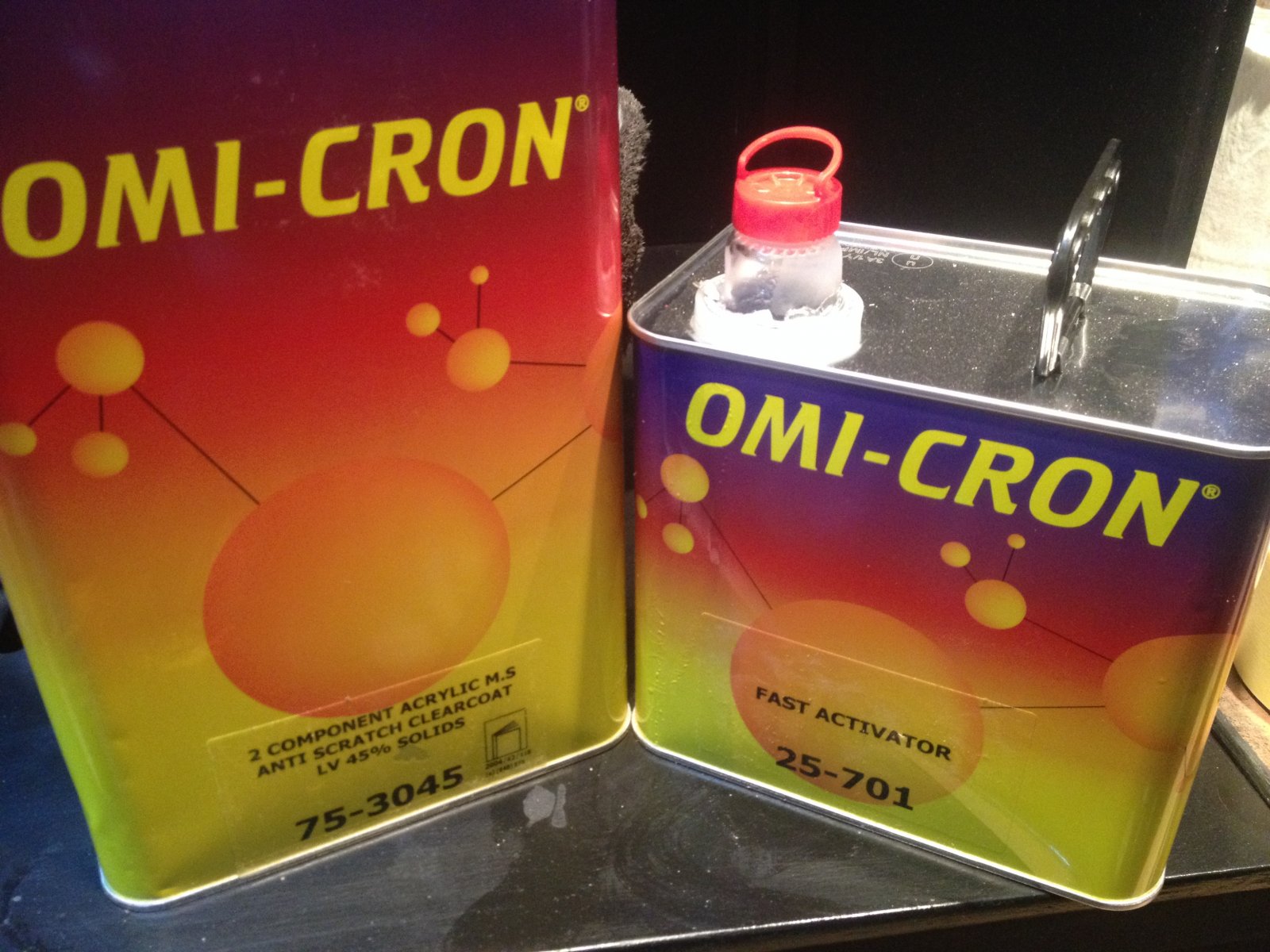

  11. Hi Red
    No pressure drop .. 3 hp comp with 15 l tank..
    Clear coat above
    Gardner above.. Rec. ratio 2-1 .. Didn't mention thinners although Ive tried it..

    Yes I weigh out my clearcoat at a 2-1 ratio.. And yes I'm using the omi-cron ... Ive also got the G10 and G3 fareca and before that I rubbed down with P600 and then 2000 and then 3000 all was good until I used my fareca foam compound mop.. Using that it ripped off the lacqure..
    Again no data sheets provided with the omi-crom... Poor really ... I will try a little more hardener and leaving it in a warmer place... Thanks Red

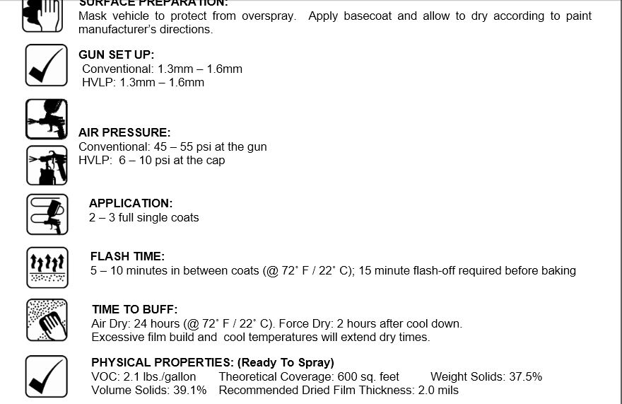

  19. Try doing it by volume and get some plastic mixing cups to see if that helps.
    Here's a link to the data sheet you will note the instructions state to mix it by volume as opposed to weighing it. This could be where you are having problems.
    http://uschem.com/products/docs/SS_Omi_Cron_7200_Euro_Clearcoat.pdf
    You will also note that the suggested gun tip is in the 1.3mm to 1.6mm range for both HVLP and Suction guns.
