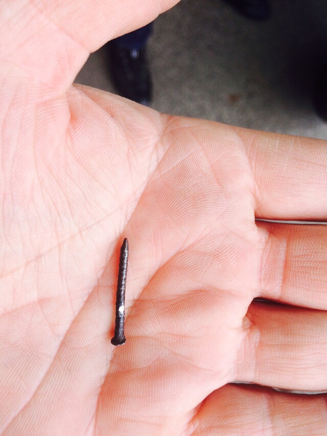

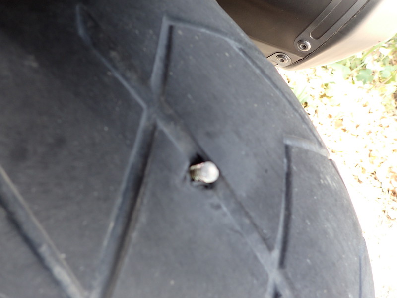

  3. i had the goop ( blue water based) stuff in my tyres as a just in case for my 2 week euro trip. Yesterday whilst loading the bike onto a stillage for its trip from Glasgow to Nice I spotted a small nail in the nearly new Rear. Decided to pull it out and expected the magic to happen. Nearly went flat without filling the hole !!!!
    In the end I've plugged it with the sticky rope kit I had and it held. (Tested for leakage with water)
    Now my worry is do I want to do 3k on it in the south of France n Itally with this 'temp' fix or risk it.
    Here is the nail. Not exactly massive yet the goop never sealed it. Nail did have some goop on it when I pulled it out.
  4. Depends how much you place on your own safety; value of been safe & or monetary outlays on other 'lifestyle' things. If you ride steady the sticky-rope should be fine then again you could buy a new tyre & remove all doubt!?

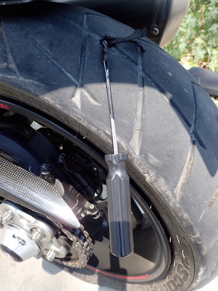

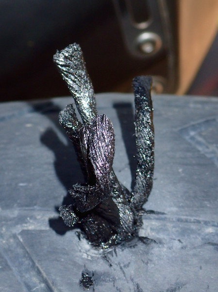

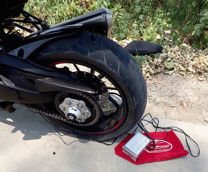

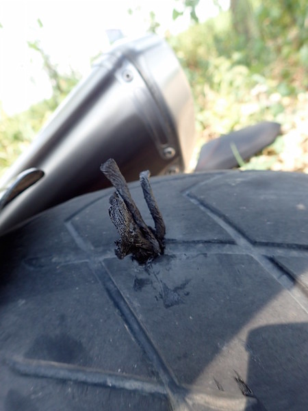

    Well ~ the proof is in the pictures right here as my trusty and reliable tire plugging Neale kit http://www.tirerepairkit.com got me once again back home safe + sound earlier in the week.
    Shall use the rear tire till its really ready to change (entire thread gone)....
    Ride on, keep on pluggin' - keep on cruising as the roadside repair takes just 10-15 minutes.....
  7. Some confusion here. You are using the words "mushroom plugs" in a different sense from everybody else, I think. Your photos show the "black sticky string" method. By contrast, the "mushroom" method involves taking the tyre off the wheel and inserting the rubber mushroom from the inside. Just so we are clear ...

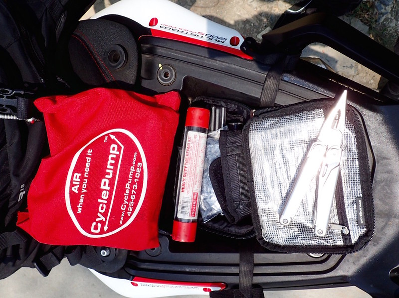

  11. been good reading all you guys reviews and comments. I know its always at the back of my mind, "what if", so relied on RAC break down cover. However, I think it makes sence to also carry a quick repair kit as a get out of jail card. So thanks chaps,. I just bought: 'TYRE REPAIR KIT' by AUTOart. Look small enough to carry under the seat. So far, the only puncture had has been rideable screws through the rubber..........not bad for 30 years of biking :)
