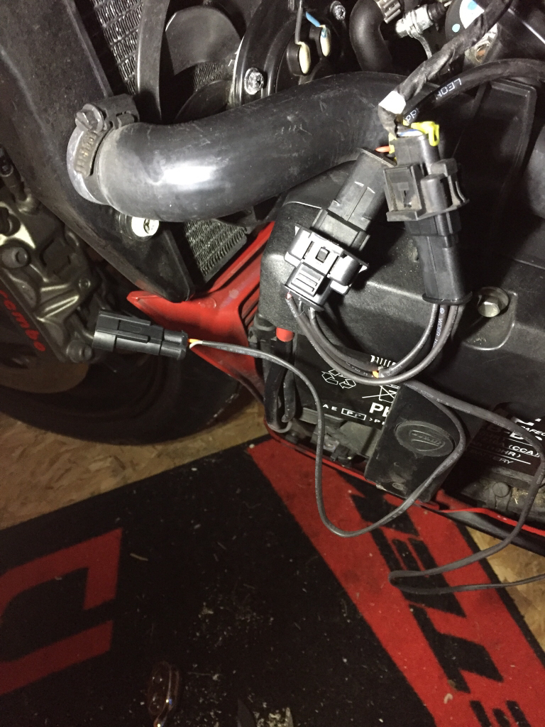

    Currently fitting my HM Plus SS quickshifter to my 848 as I type[​IMG][​IMG]
    And plugged in the new loom tired to start it up just to check it's correct and it won't fire up
    Plugged the OEM loom back in and fires up

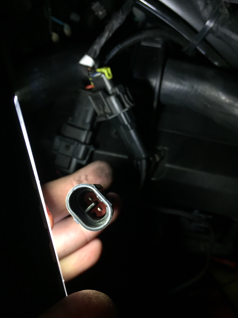

    1 question I have is what is this extra lead I have at one end??? Does it matter if this is on the rear cylinder or front ? Can't see where else it plugs into
    Cheers for a quick response

  8. That 'spare' connector look like it was the one the shifter goes in.
  9. Yeah I realised not long after posting ....'bangs head off the wall'
