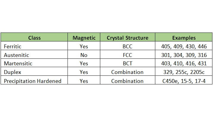

  5. The speeds sensor is basically a "Hall Effect" sensor. As a bolt head passes over it, it induces an electromagnetic field in the sensor, the frequency of which (the interval between each passing bolt head) is calculated as a speed through a pre-determined calibration. Stainless steel has a lower ferrous content than ordinary steel and therefore does not induce a large enough change in the electromagnetic field to allow the sensor a reliable reading.
  6. Common stainless steels like 304 and 316 are often (but not always) austenitic in structure due to the nickel content, this effectively makes them non magnetic or at most slightly magnetic. You can check with a magnet how weak the effect is. Most mild steels (including the steels used for common nuts and bolts are ferritic which is magnetic, the sensor is reading a magnetic effect as the bolt passes it chart1[1].jpg
