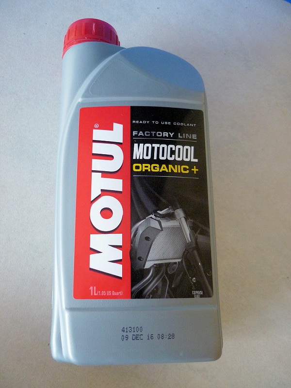

  7. This is what I ended up with after some pretty patchy advice :smile:. Motul Motocool Factory Line Organic+. The bottles look nice, and the coolant is red. Hopefully it doesn't rot my engine.
  8. We use Motul Motorcool Expert, never seen any evidence of corrosion on bikes filled with it.
