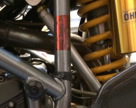

    Has anyone tackled removing the old type of datatag sticker, the ones which seemed to be on every bike from the 90's.....I don't mean the numbers.
    Before I tackle this has anyone tried before.
    I've tried ringing Datatag but they said they're on there for a reason and you'll never get them off, surely it can only be stuck with glue and they've been on for 20 years !!
  2. I've never tried to remove Datatag stickers but for other limpet-like stickers I use a hot air gun to soften the glue, then try and peel off. Hair drier would probably do. Take it easy with how long you blow hot air at it and how close you get to the surface concerned.

  7. Can also "saw" them off with dental floss or fishing line which will not mark the paint. Sticky stuff then can be taken care of with white spirit, Autoglym tar and glue remover or lighter fluid (stuff you use in a zippo not the aerosol can ;) )

    I've got these I want to remove which I guess is the same thing?

  19. I've just succeeded with a hair drier, a Waitrose loyalty card ('cos i'm posh like) and 1 hour of my time. No paint fade underneath for me, it was on black and had been on about 14 years but spent most of that time under a cover.
    Removed the sticky residue (don't, just don't - you know who you are :Watching:) with chain cleaner, which is basically clutch/brake cleaner and it came straight off. Not sure how good that stuff is on paint but i'm going to be respraying so don't really care. I can't see any damage.
  20. I removed one last week, easy job hairdryer then use connector cleaner for the sticky residue,
    ( Thats connector block cleaner as in on your wiring loom) it was on the tail piece no paint fade.
