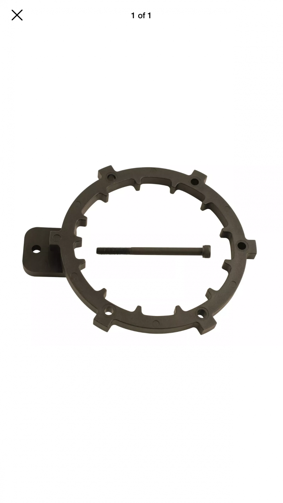

  1. Ordered a slipper from sigma on Friday and it arrives Monday Will this lazer holding tool do the trick as I can have it Monday from Amazon?
  2. They are only made of some type of plastic, put under load they break.
    Steve

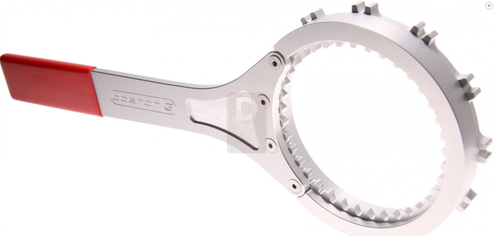

  3. I had something similar Scott and it wasn't brilliant to be honest. I ordered an Oberon holding tool, which was spot on. Their website says it will work with the 12 tooth standard basket, the 48 tooth aftermarket clutch and EVR clutch.
    They aren't cheap, but you only buy them once.
    Ducati Dry Clutch Spanner Tool Essential Oberon Performance
    You can buy a cheaper version here for the sigma clutch especially, but you'll need a tool to get your standard clutch off too. Hence why the Oberon one is useful.
    Ducati 48 teeth Sigma clutch Holding Tool | eBay

  4. If you have an old steel plate laying around and access to a welder just weld a handle onto it, that's what I did and it's lasted years.
    Steve

  7. Correct me if I'm wrong. But that's fine with the standard 12T clutch, but won't work with the Sigma 48T clutch. You'd need to weld a handle onto one of your new Sigma steels.
    That's why the Oberon tool is constructed with the outer teeth the way it is to fit the 12T & 48T baskets.

  8. Haven't had access to a 48t clutch hub to check whether the spacings interlock with the 12t holding tool, obviously it wouldn't work the other way around.
    Steve
    I have never seen the 48t close up, is the hub the same as normal with just a 48t basket and friction plates with the same steels as normal?
    #8 Birdie, Jan 28, 2017
  9. Yes. '+title+' Andy
  10. So my welded steel plate would still hold the center hub of that 48t slipper.
    The only difference is the outer basket and friction plates.
    Steve
