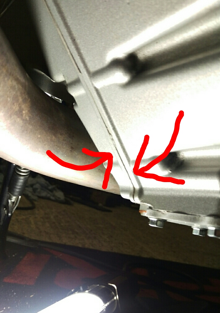

    Right, Oil leak seems to come from this join, there's oil up to the bigger blob of gasket (higher arrow) but dry above and only this side, completely dry on the other side . Dont seem as much liquid gasket on that part by the looks of it. Definitely no splits or cracks ........ please dont say the engine needs to be split ffs :(
    Or should i try and retorque the two lower bolts first?

  9. I would check those bolts if it were me. Is that leak after standing or after a ride, If after a ride wind force might be blowing it back from the sump plug area. Never heard of a leak there before if it's coming from the case join itself.
  10. All wiped clean Saturday and checked tonight.... so its definitely after standing .... all dry everywhere apart from that join ... I'll need to remove the lower down pipe to get access to the bolts so that will be friday on my day off.

  11. Managed to get an allen key on those bolts to tweak them up .... I'll check later if its still leaking .... splitting the cases to add new liquid gasket is the last thing im prepared to do tbh ... haven't got all the tools or knowledge to do that :(

  18. Tweaking the lower bolts has reduced the leak by 90% I'd say ... still a tiny bit of oil when i wipe my finger down the joint though, i dont think i dare tighten them anymore tbh as dont want to ruin the thread ... will see how it is at the weekend
  19. Still a tiny amount leaking :( ... will order and try that oyltite stick ... failing that its a fooking strip down i cant afford at the moment :(
