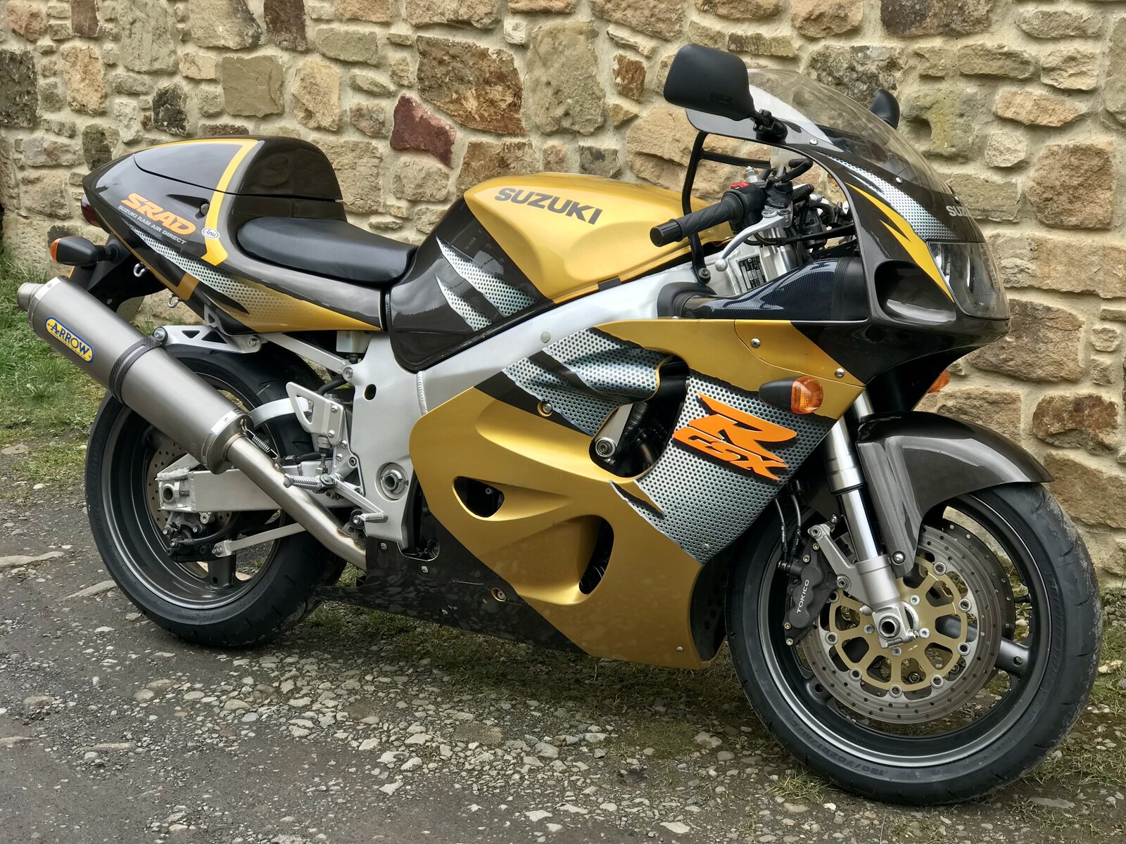

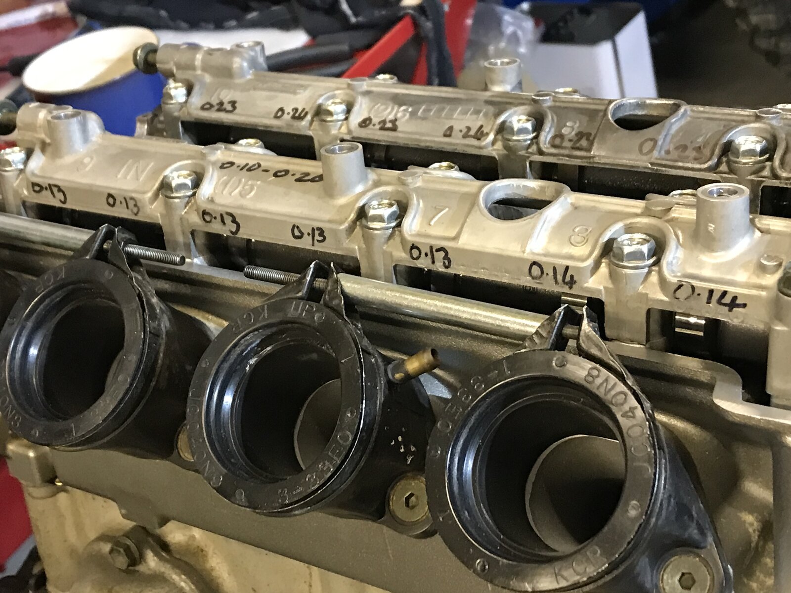

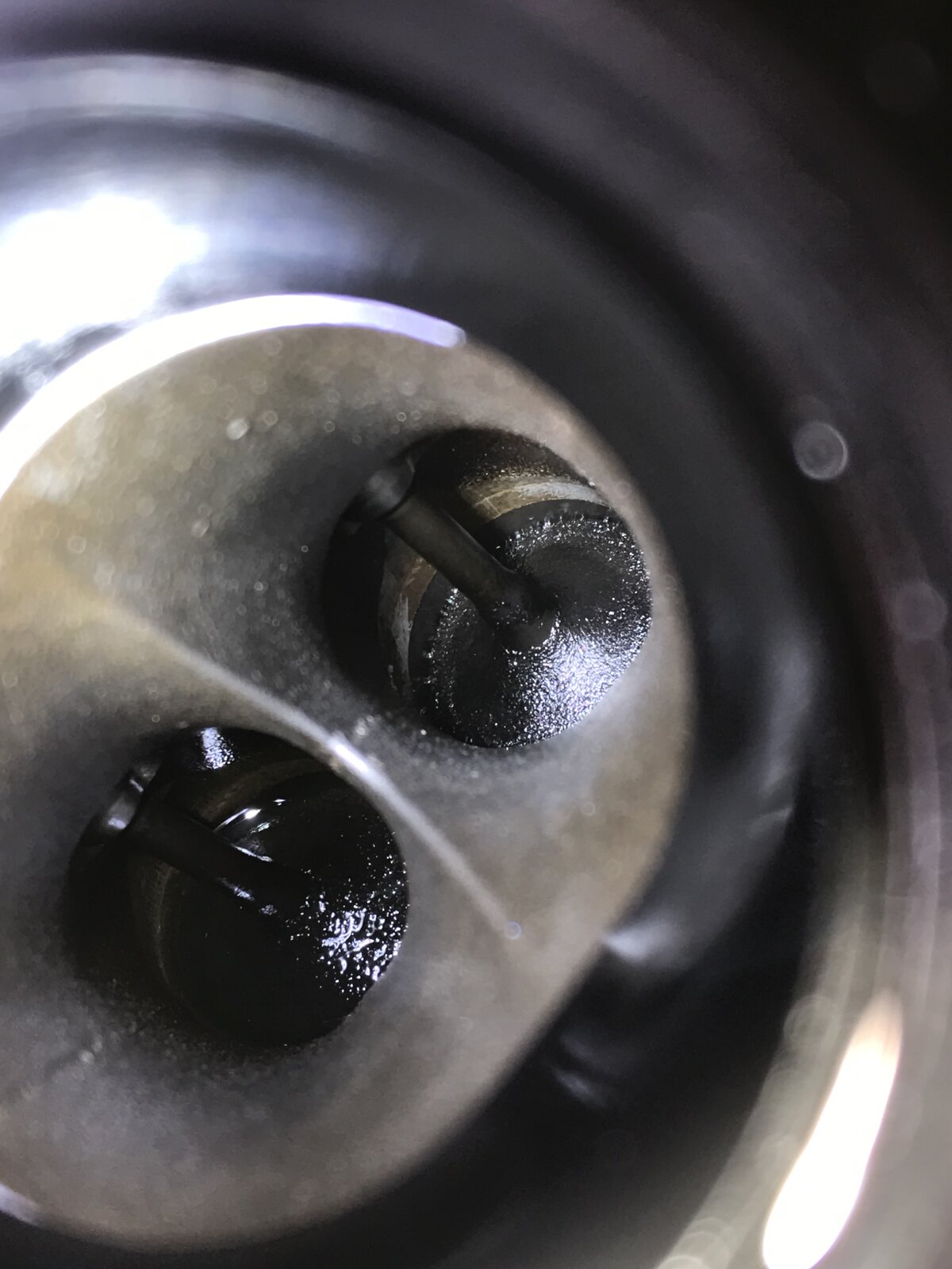

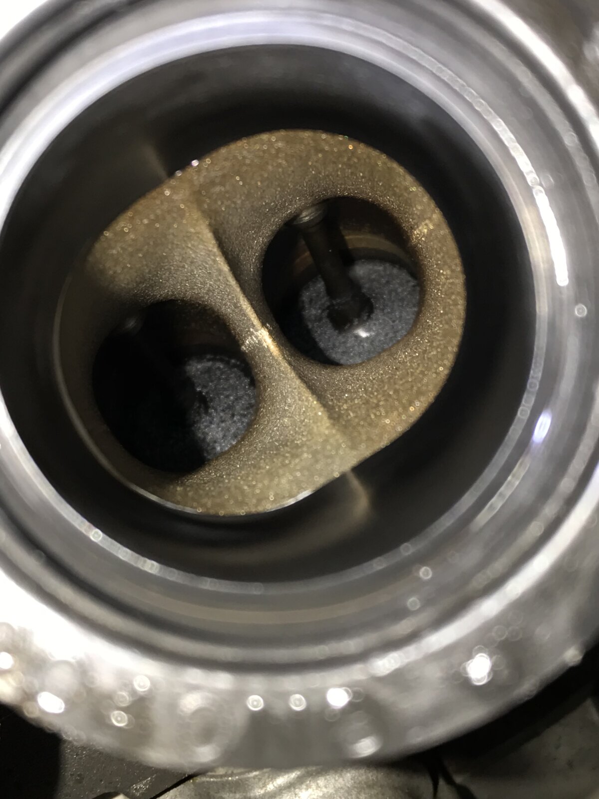

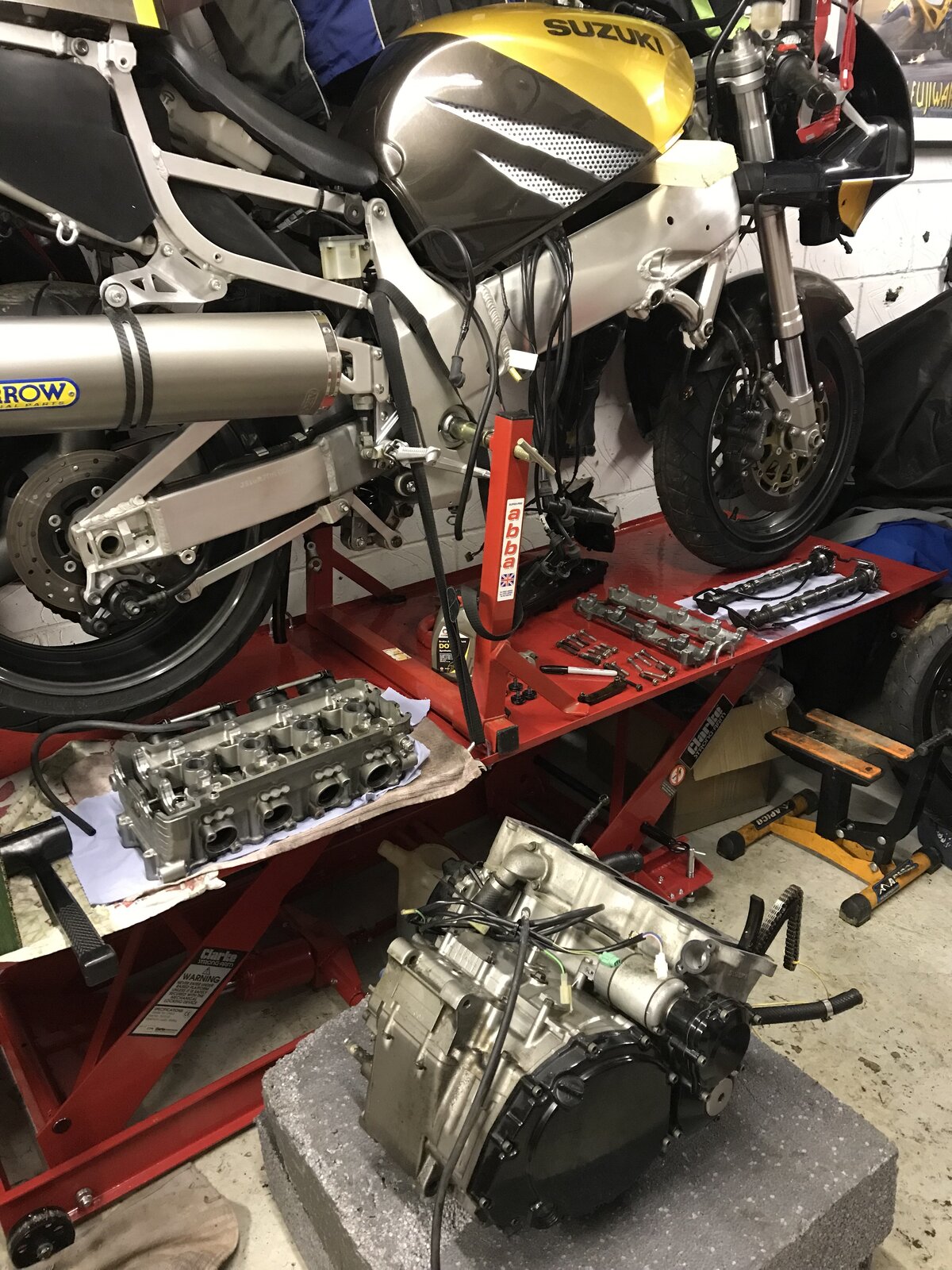

  1. Wouldn't start when I bought it as a winter project.

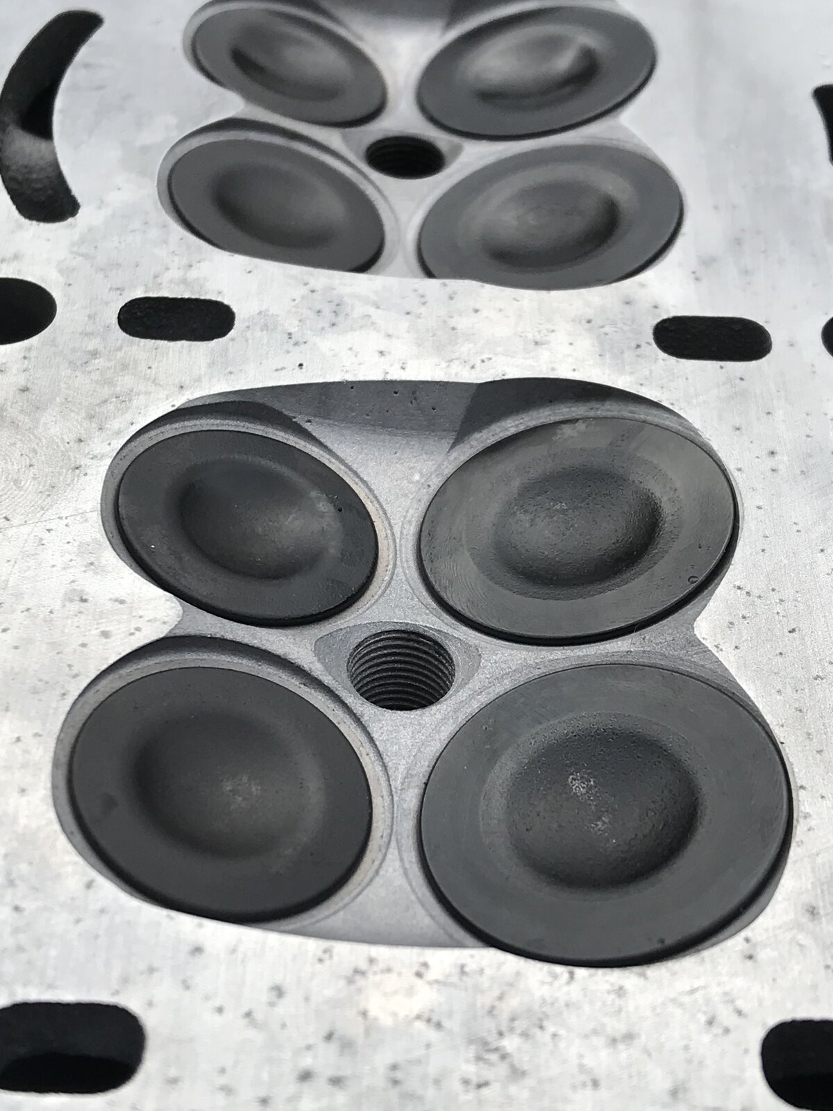

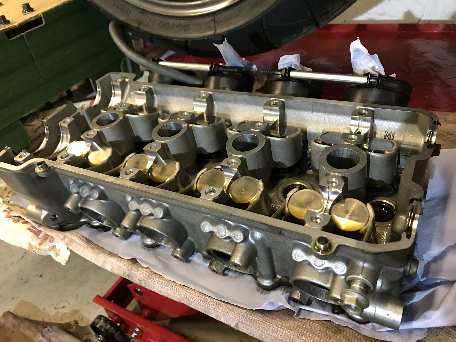

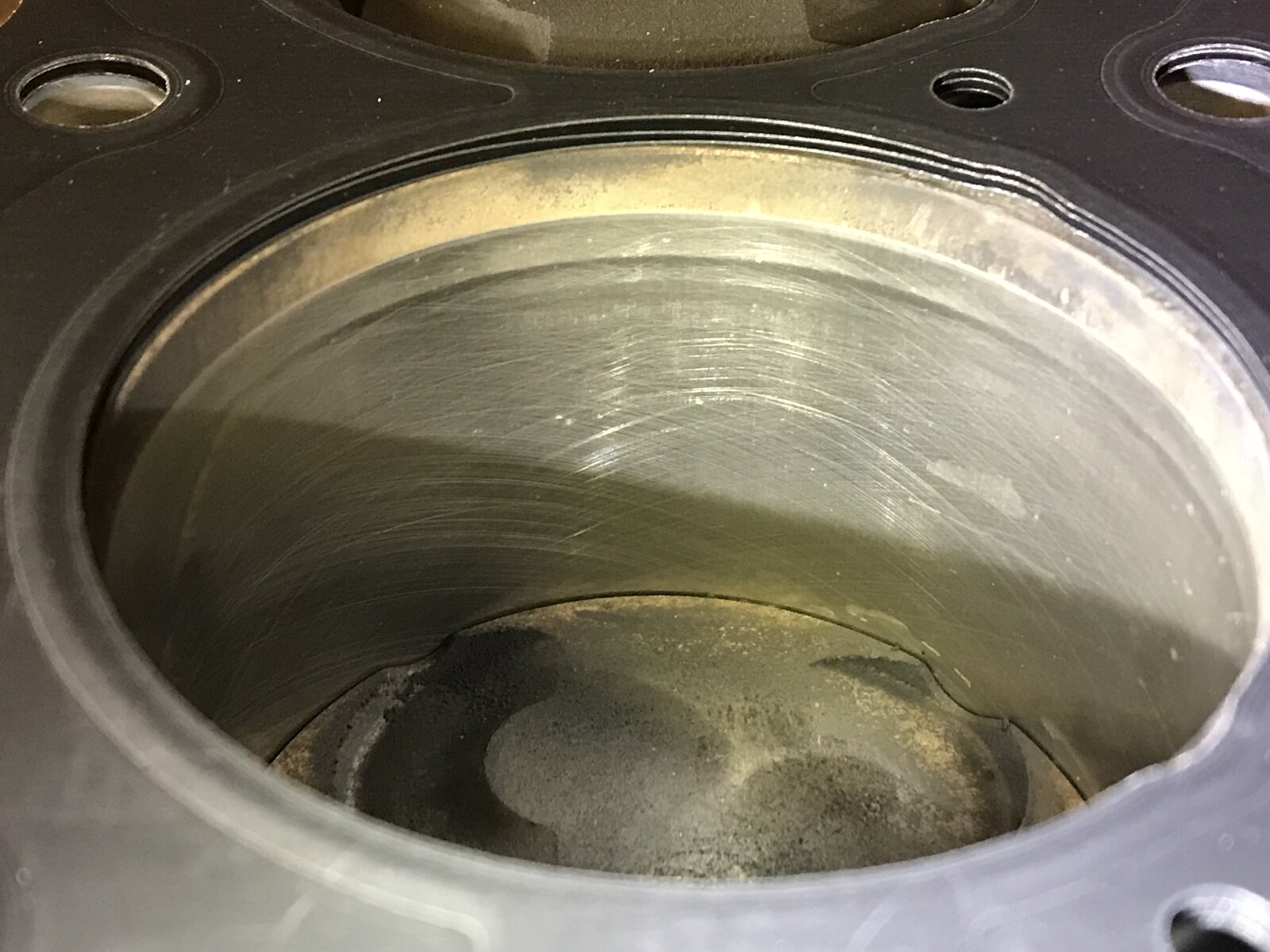

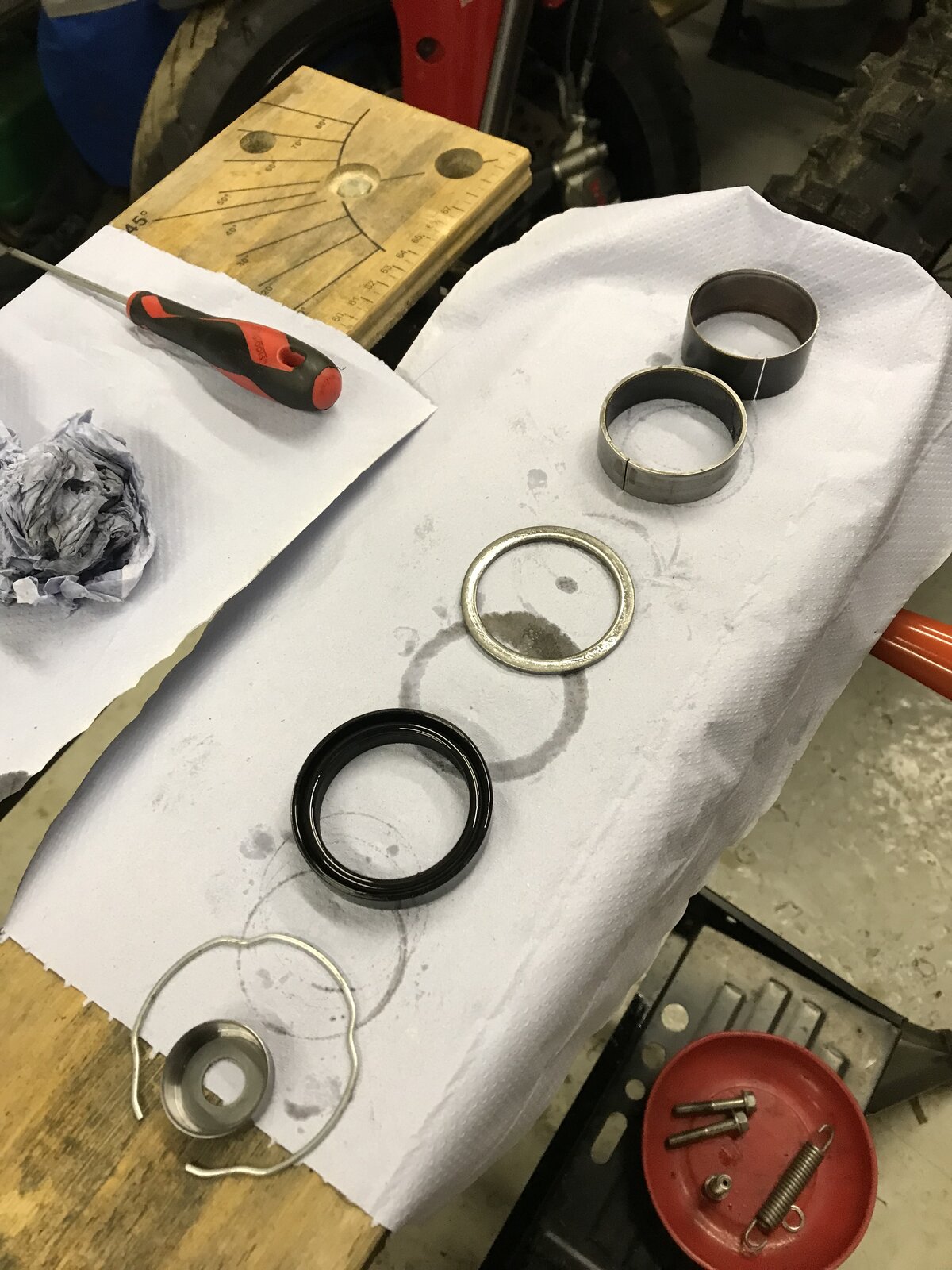

    Stripped down to component parts, cleaned everything until its bum squeaked, replaced lots of perished items, fork seals, old fork oil, coolant, filters, caliper seals, brake lines........ on and on an on. Valve stem seals had gone hard due to it sitting unused allowing oil onto inlet valves and baking on to valve seats giving very low compression. Not what I expected from a one owner 7000 mile bike, but proves they don't like sitting unused. Head cleaned-up, valves lapped and shimmed and she started on the button. Runs brilliantly and has been a fun summer alternative screamer, reminds me of mad times in the 90's when we got away with so much. Prefer a V twin though. IMG_8504.jpeg IMG_8505.jpeg IMG_8424.jpeg IMG_8422.jpeg IMG_8426.jpeg IMG_8434.jpeg IMG_8235.jpeg IMG_8234.jpeg IMG_8123.jpeg

  2. Welldone Mary! How old is it?
  3. Lovely had a blue and white one as did my son.Absolutely loved it.
  4. 1996. WT model, carbs not FI. Looked for a good one for ages.

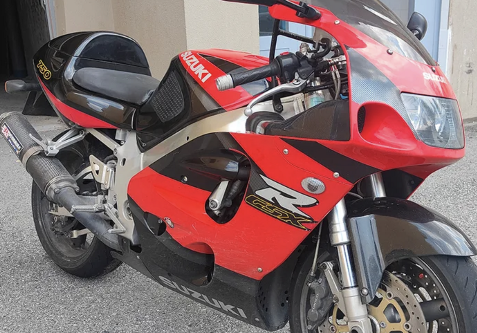

  8. I had the first of the fuel injected in blue/white. Absolutely hated it, the Zx7r was a much better bike albeit slower. The colour you have no body wanted at the time so is very rare now. I actually like that scheme.
  9. Not mine, must have photo Gsxr 750 srad - Motos.png somewhere, but this is the same colours. Think it was an import..

  16. All-in the bike owes me around £4K I guess. I do as much of the stuff as I can, the way I see it if I need to buy a certain tool then I will by weighing it up against the cost of getting someone else to do it. It wasn't in a bad state to start with, low mileage, one owner, cosmetically a few scratches, just hadn't run for ages and been left unloved and dirty. Sourced paint from RS bike paint to to blow-in a couple of bits on the lower belly pan area. Forks, linkages, brake lines, pads, engine removal etc all done in the shed. I got a guy I know that builds motors for classic endurance race bikes to clean-up the head, it cost less than me buying all the shims etc and came back perfect. Carbs all done on the kitchen table where it's nice and warm and close to beer. It's the hours and days that go into getting these beauties back running that you never get back financially, but if you paid someone to work all those hours you'd be massively out of pocket, plus it keeps me relatively sane during the winter months. Found the Arrow system brand new, boxed. It been on a shelf for 26 odd years.

    Got any pics of how you collected it?
  18. Yeah, and that's what it's all about really... :)
    Unfortunately not...I picked it up in the pissing rain in december and it went straight in to the house. I have an understanding mrs. The inlets looked like this though:
