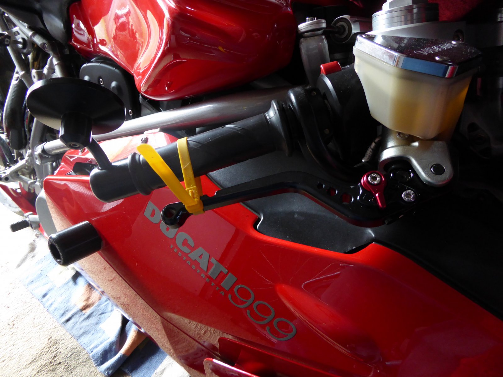

  15. [​IMG]
    There you go, the banjo has a bleed nipple on top, this forms a high point on the slave making it easier to bleed both the slave and the line, I'd get an SS one, but maybe that's just me
    HEL and a shedload of others do them, I cannot remember the size and pitch of the banjo on the slave but it should be a dawdle to find out
    Here is a link to the HEL fittings, if it helps
    Fittings
