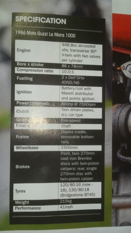

  8. Faster than a Le Mans Guzzi methinks!

  13. my speedo shows around 140 to 150 ,when i am doing about a ton ,bike must be ok as everyones 600 seems to do same speed,also re old guzzi le mans top speed ,speedos were made by same ones as ducati ,had one regularly did 150 on local bypass,got a v max did 150 on same road & realised guzzi was reading about 33% fast.the good old days ,i had cash & the bottle to max out quick bikes ,nowadays my 600 slug special is fast enough for me ,ha ha
