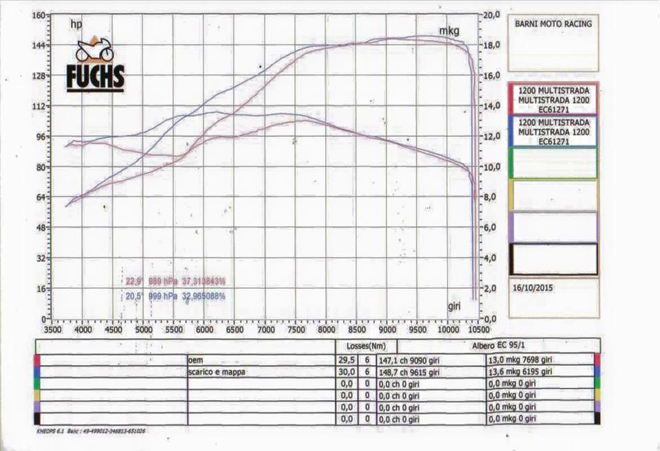

  8. sorry, but I'll be waiting for the Rexxer upmap rexxer_mapping.jpg :grinning:

  9. Wow. Is that for the DVT?
    And with exhaust etc or standard.
    Looks a significant improvement
  10. Yes, that is a stock DVT with stock exhaust and 5000 miles.
  11. yep, that's for a full original DVT :fearscream:, they are waiting for a SC full titanium system to do another mapping and check what's left :sunglasses:.
    found this on the REXXER facebook page.
