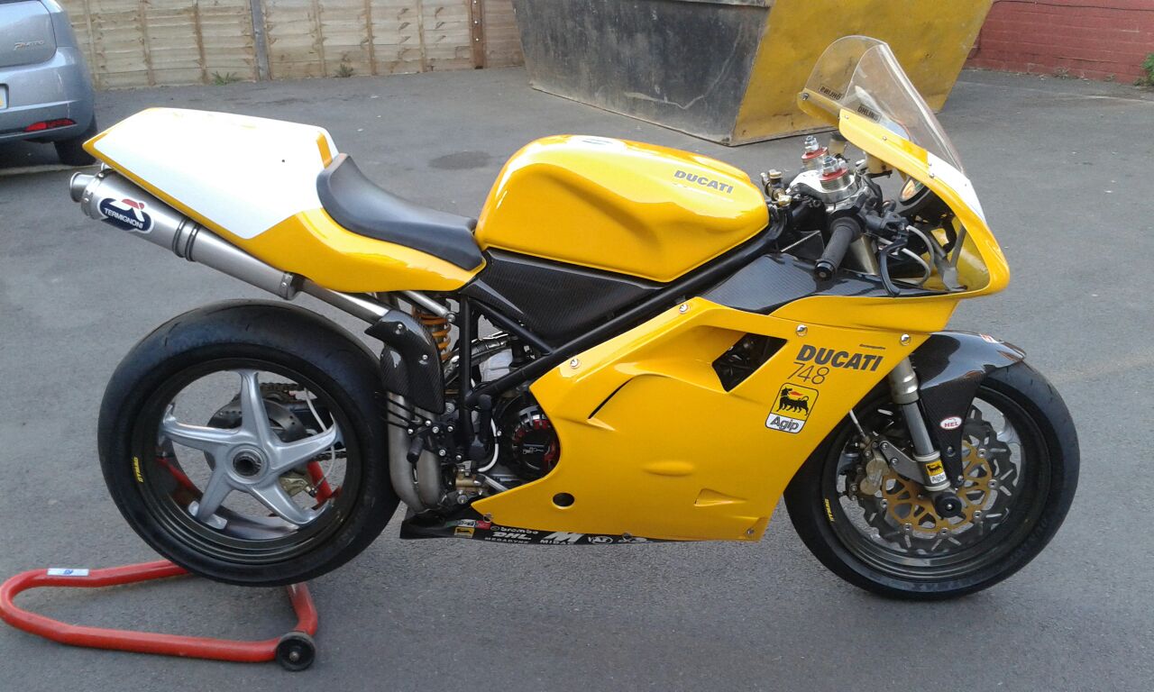

  11. evening gents, @Outliar i am selling my carbon/magnesium dymags they are in amazing condition i had them refurbed at csa wheels which is now tpcs magnesuim refurbishers. have the paper work to go with them, they have silver inners with bare carbon rims. I had them on my 748r which did about 1000 road miles them put them on my track bike which did 3 track days before i broke it for parts. pm me if your interested.
  12. Thanks Cookster, I'll PM you.
    Lovely looking bike by the way!
  13. Happy to vouch for the seller. Many of the parts from that bike are now with me....:upyeah:
  14. Me too :upyeah:
  15. Yeah - flipping fairings...:tearsofjoy: Missed out there!

  18. yellow track bike doesnt exist any more im affraid, nelson got 60% of the bike rest got sold in parts. It was a nice bike though.
