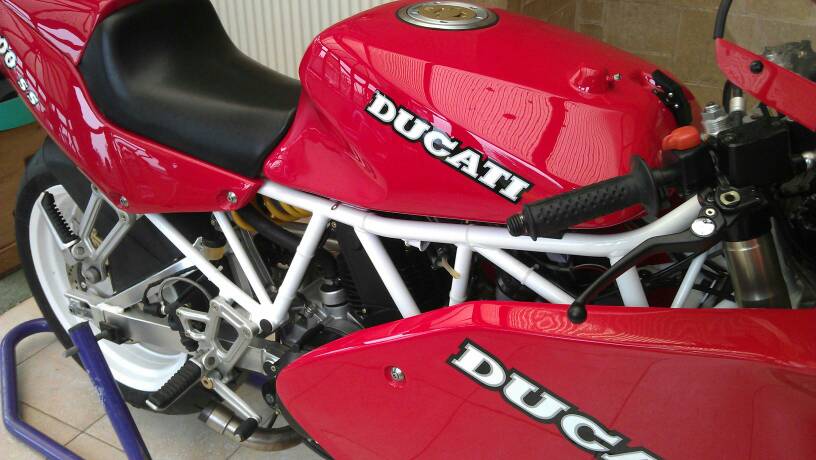

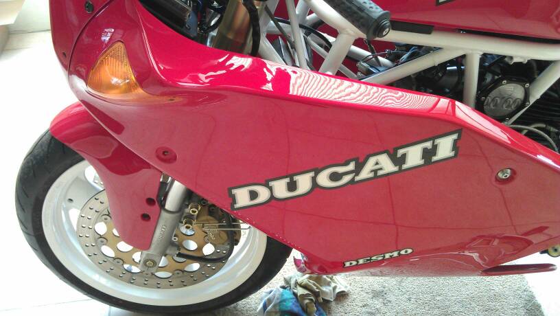

  7. It's a bit overcast today and this is indoors, but I'm pleased with the finished job.
