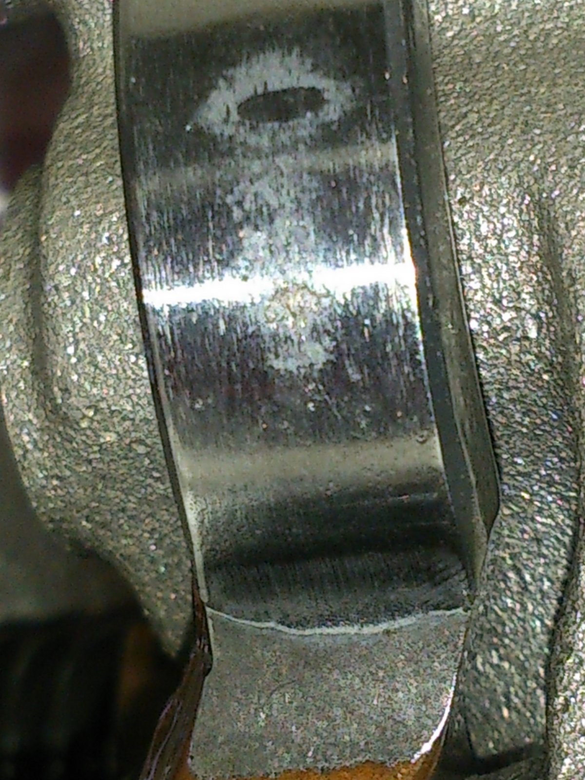

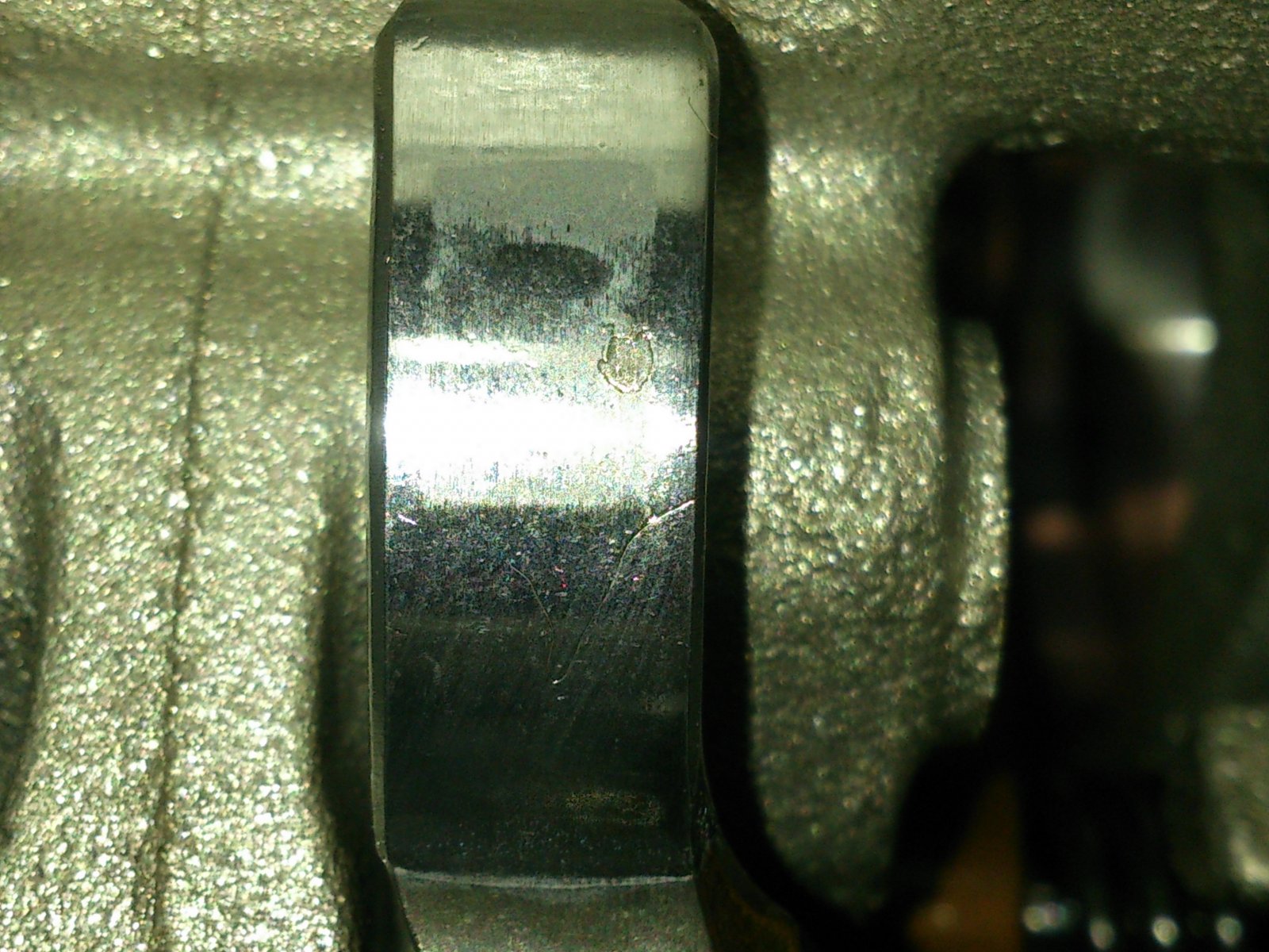

  14. Glad yours are still good but over the years I’ve read of a few folk that have had trouble. They appear MUCH less common than openers and even less so on the bigger motors. Here’s two of the offenders in mine, I can’t get the third to show up It’s such a small area.
    [​IMG] [​IMG]
    Absolutely! My reasoning as well. It’s good to know that NC have a good reputation and it appears I’m the only Desmo rider that hasn’t heard of them. I’ve always had it serviced at Gtec but his moving on has coincided with my building a work shop so at last I have somewhere to work. Some of the labour costs saved will help assuming I can get it put back together. I wasn’t planning on going this far for a first stab at it but if you don’t try you don’t know.:Wideyed:
