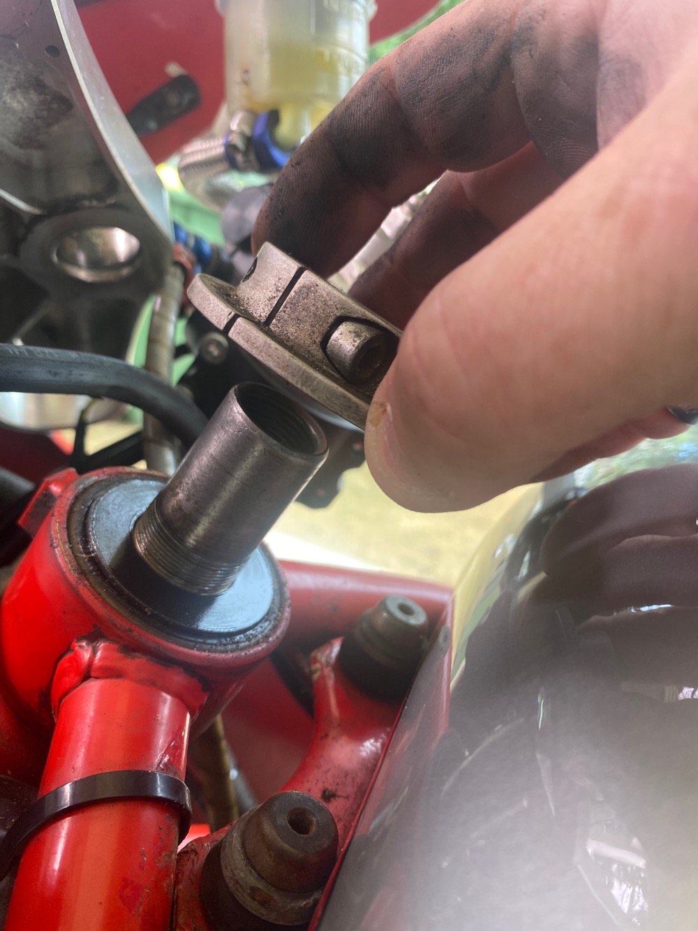

  12. A quick rant so bear with me.I’ve had this bike for over a year now but it’s always played second fiddle to my Laverda Jota. This is partly because the suspension was rubbish. I fixed the rear with a new shock but haven’t had the time or money to get the front sorted. I’ve played with preload, rebound and compression, and the position of the forks in the clamps but to no avail. The top triple was very slightly skewed and I’ve tried loosening the wheel and triples and bouncing the front, also without much change.
    On dead flat roads the bike was stable but any rough surfaces and it became a handful and the front skipped on rough surfaces and even twigs on the road.
    I realised that I hadn’t loosened the steering head top bolt (I missed the pinch bolt first time as well). Once I undid that there was a slight cracking sound and the forks regained a much better movement so I’m hopeful the ride will reflect that. I’ve moved from Perth to Sydney so there’s much more riding to be done!

    It’s taken me all this time to finally get the bike to a point where I could start to ride it confidently across the bumpy NSW roads. I replaced the rear shock and then struggled on until I realised the front forks were binding which was why I couldn’t get a comfortable setup. I freed them up and it was better but then I was able to tell the front springs weren’t right. Resprung the front and now its sooo much better. You would not believe how bumpy these amazing fast back roads are! They are amazing though! Tightened the steering head as well, made a difference.
