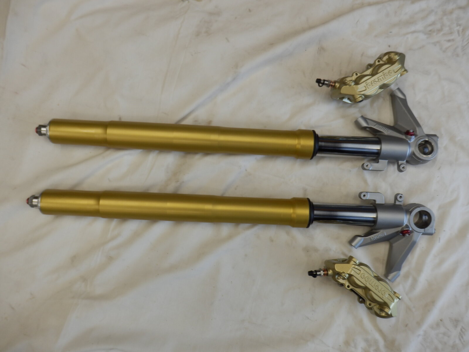

  9. As mentioned one of the things I want to do is put a better set of forks in it, cosmetically as well as functionally.
    The Ethos behind this bike is for people who think they know about older Ducatis to see it and start asking questions.
    It needs to look like a superlight from 20ft away, but then cause confusion close up.
    So I wanted to put a set of my Hybrid 848,1098/SS radial caliper forks in it, but refinish them to look similar to the SL colour scheme.

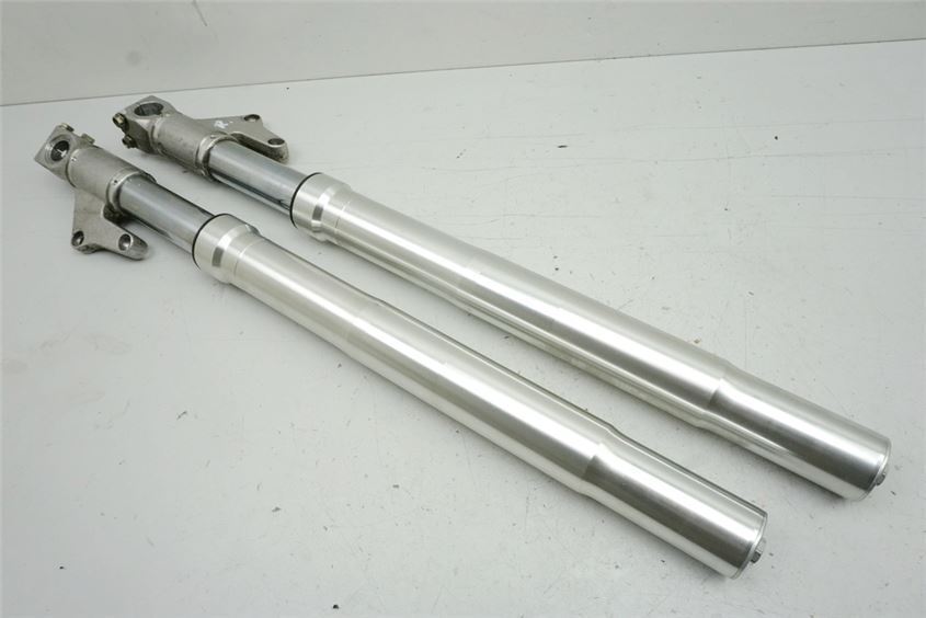

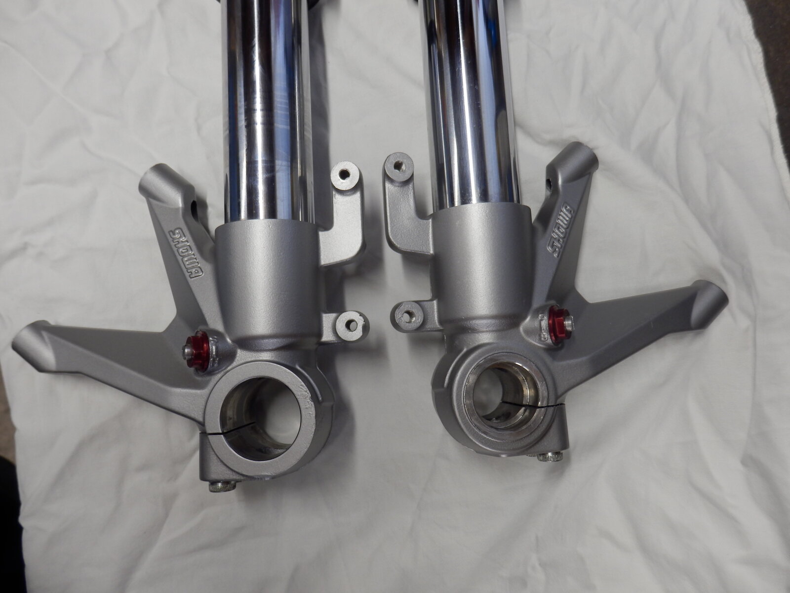

    For those who've not seen the other posts, I've figured how how to build all the internal parts from a set of 848/1098 forks with their Radial Caliper bottom castings into earlier SSetc Outers that then fit the earlier 50/54mm yokes.
    I brought a set of SS Showa non- adjustable forks:

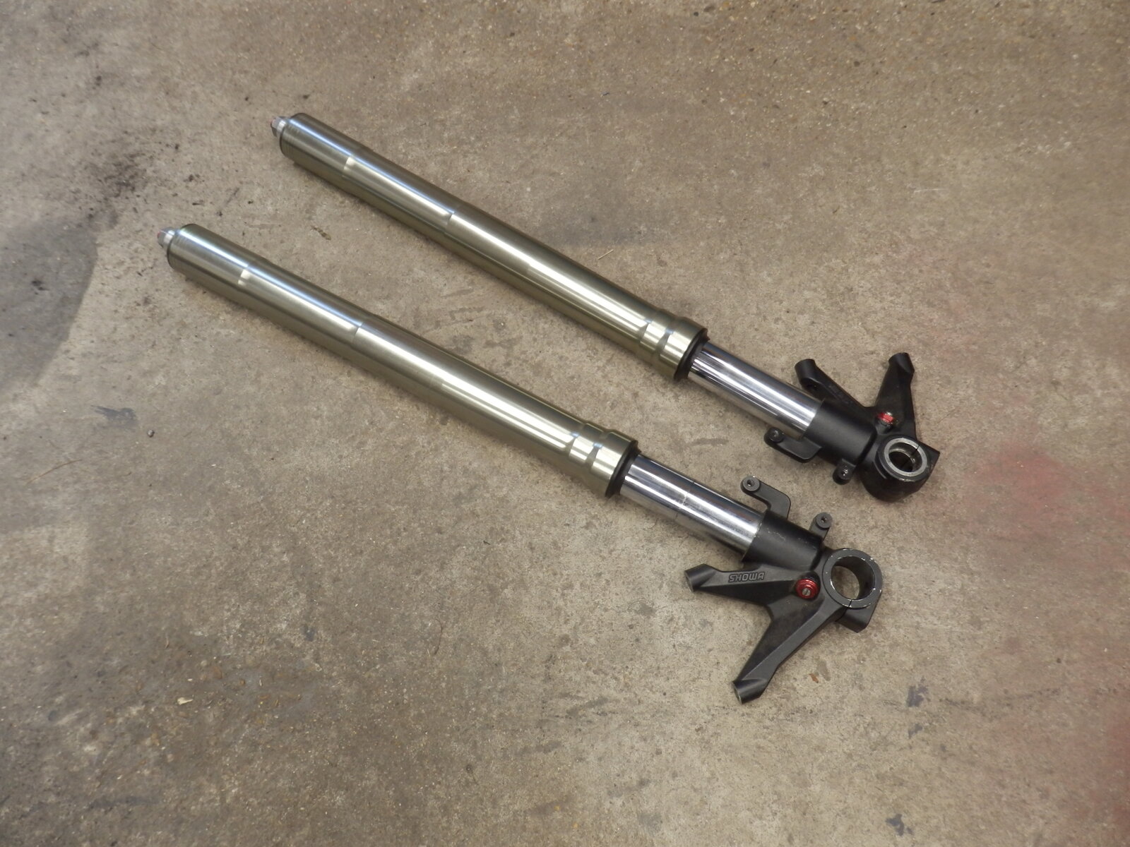

    A set of 848 Forks with corroded Outers:

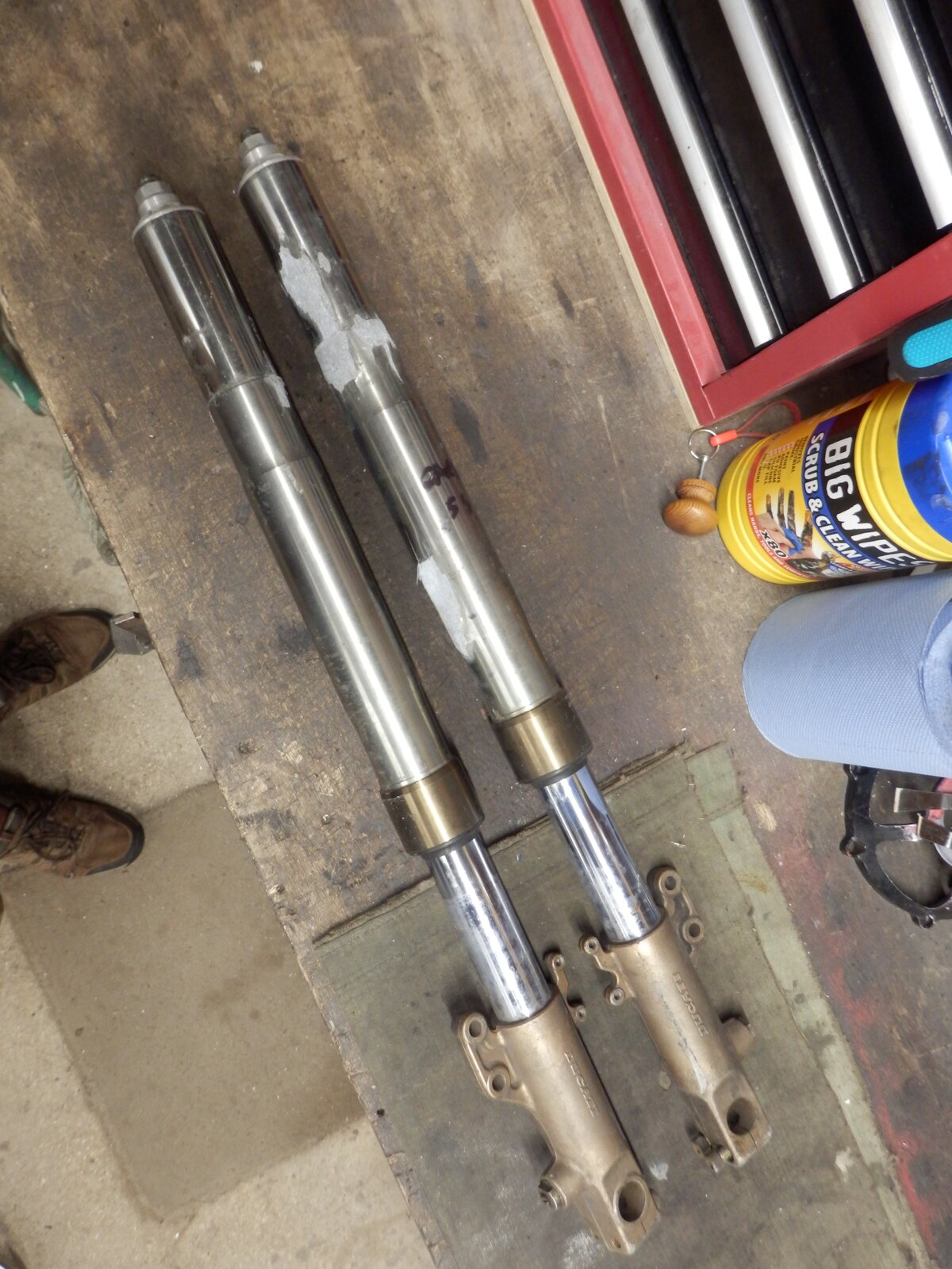

    Some old really corroded SS adjustable Forks:

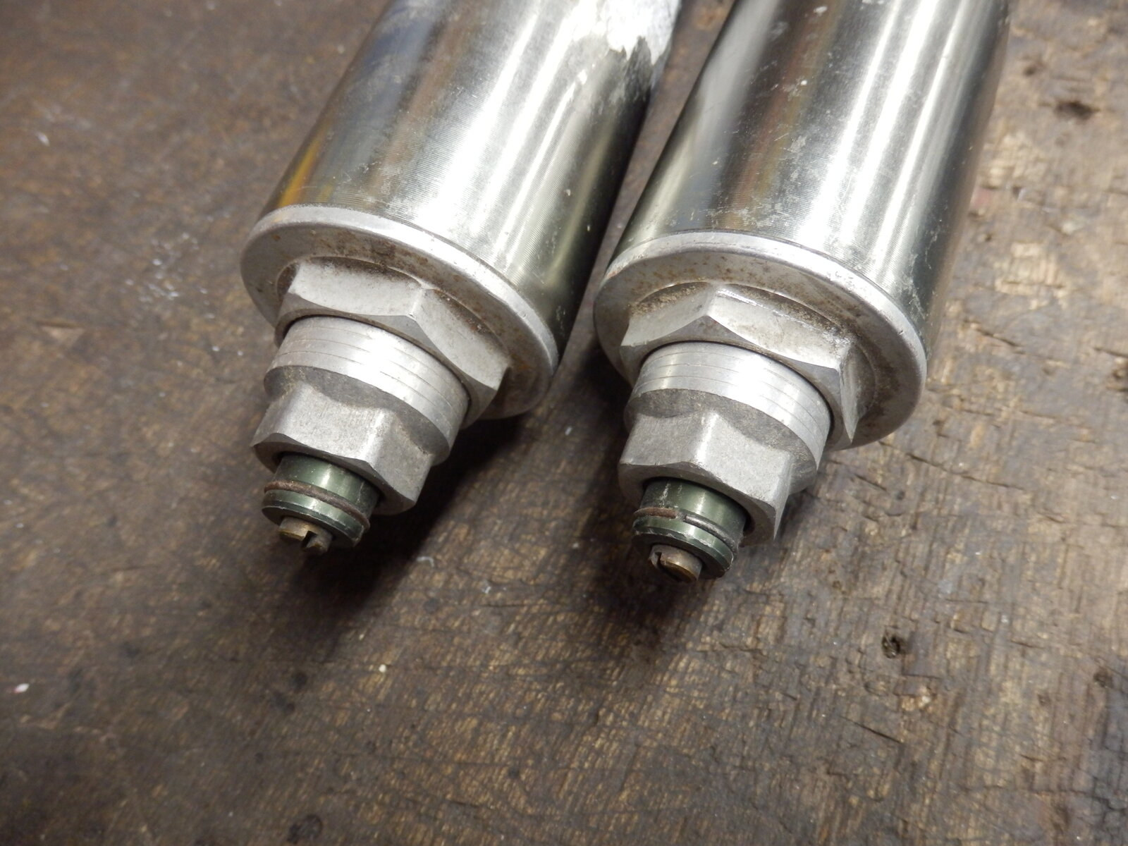

    That I just needed the outer part of the caps from:
    And a pair of Radial Calipers:

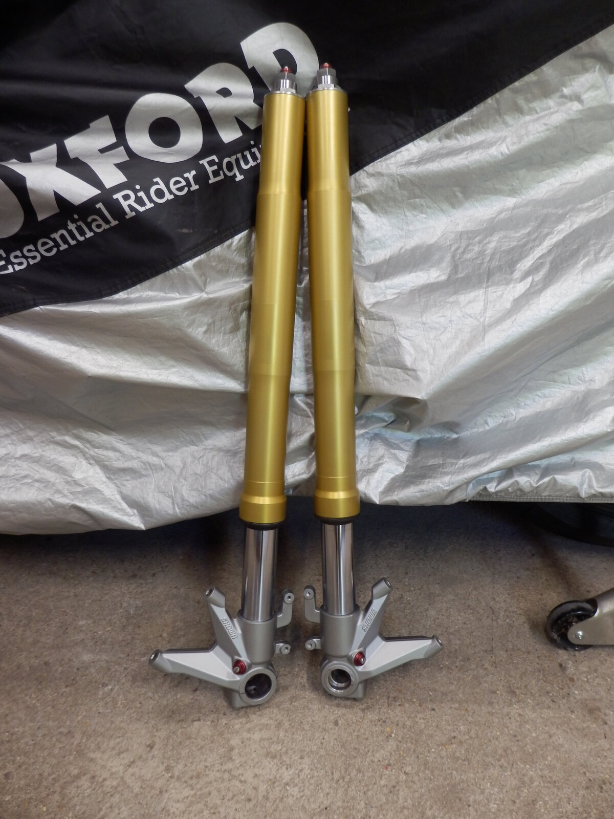

  10. I painted the 848 fork bottoms Silver:

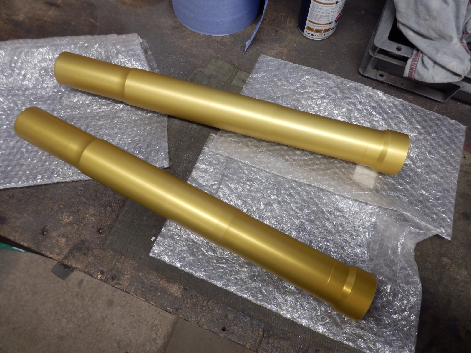

    Had the SS Outers Anodised Gold:

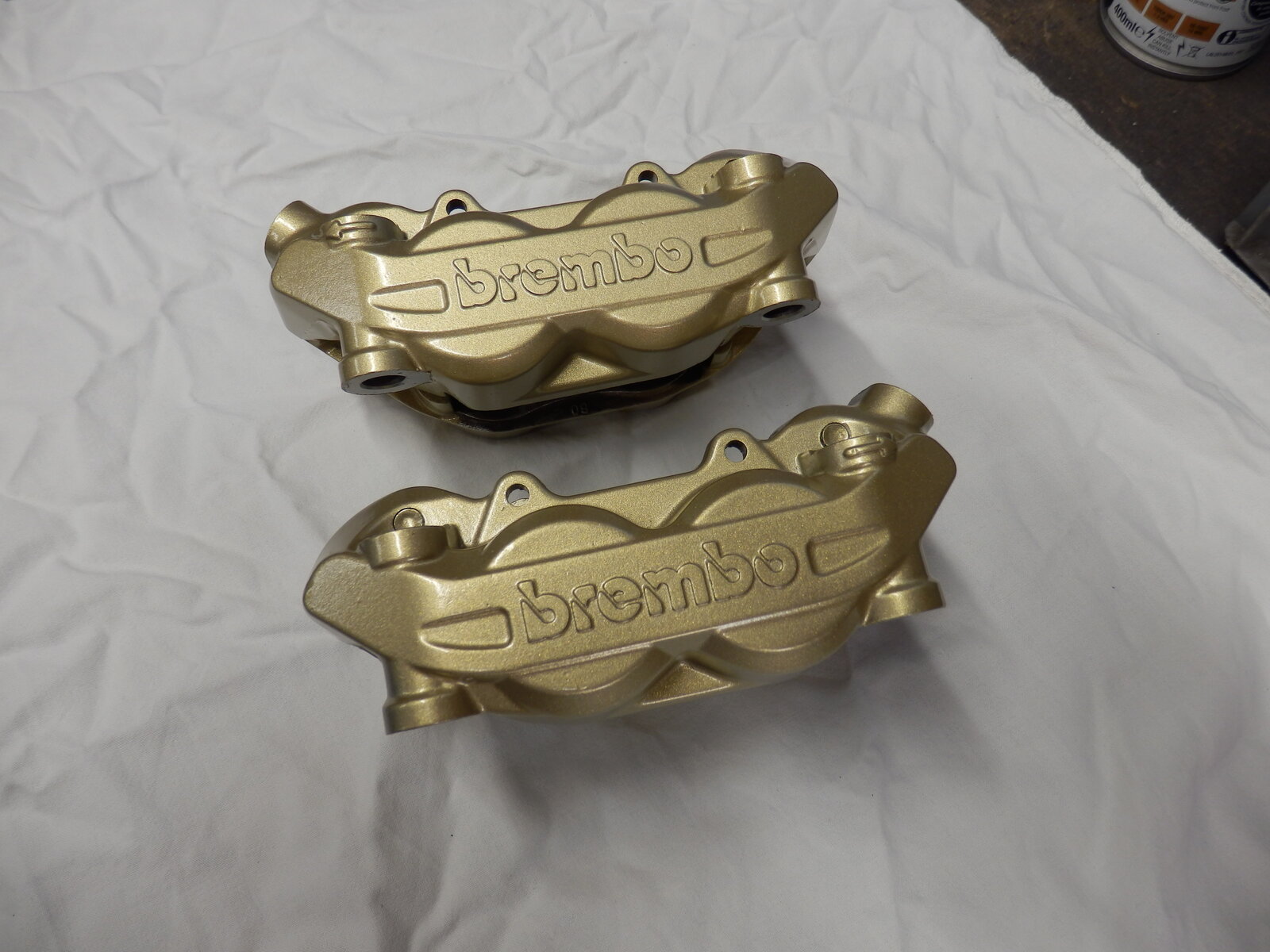

    Painted the calipers Gold:
    Then put it all together:
    These will be going into the bike over the Winter.

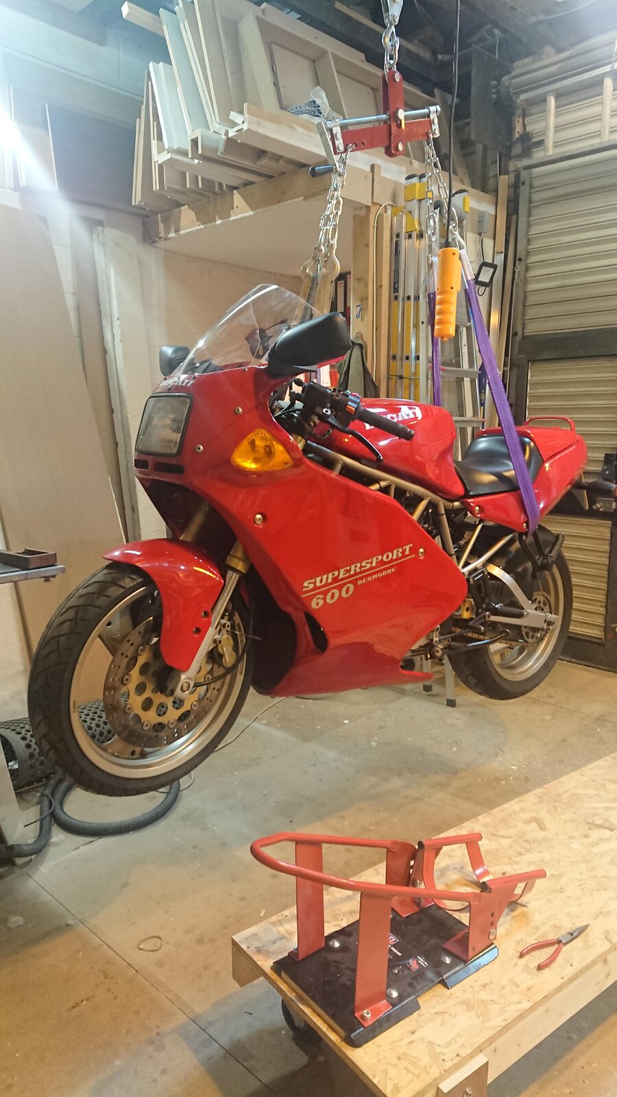

  11. Can you use a hoist to lift it straight up towards the roof?
  12. Thanks DanSS600, but my workshop roof beams wouldn't hold the weight.
    Also, I've found in the past that suspending Outboard engines to work on them always gives me an issue when trying to undo tight fasteners or do them back up to a reasonable Torque.
    I always found I was fighting to stop the engine moving rather than put all my effort and control into the task at hand.

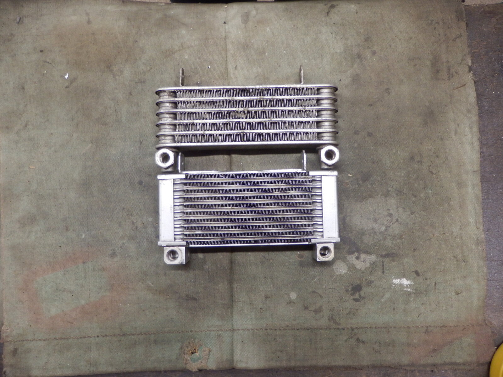

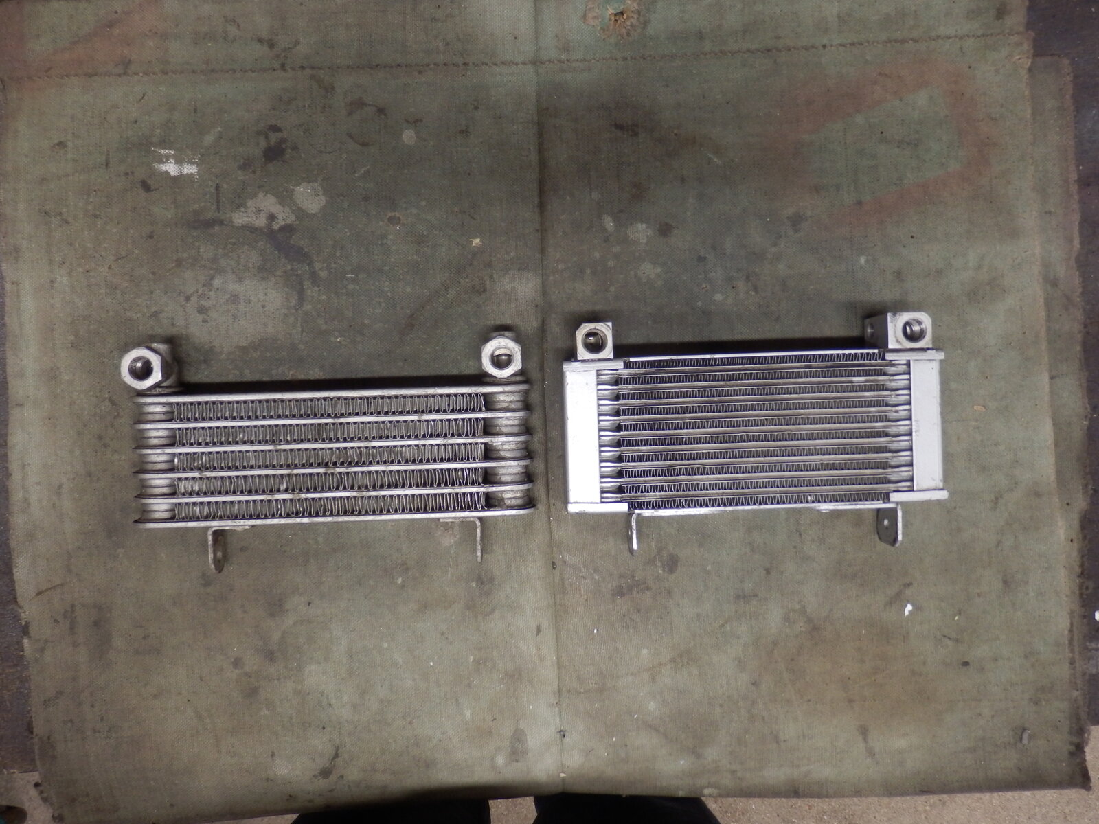

    But today I had a look at a couple of spare Oil coolers I have.
    The first is as used on the 1000SS and a whole range of other Ducati bikes.
    The second is an earlier 1990's 900SS one.
    The earlier Cooler looks to me like it would do a better job of cooling the Oil, but may impede the flow of air more.

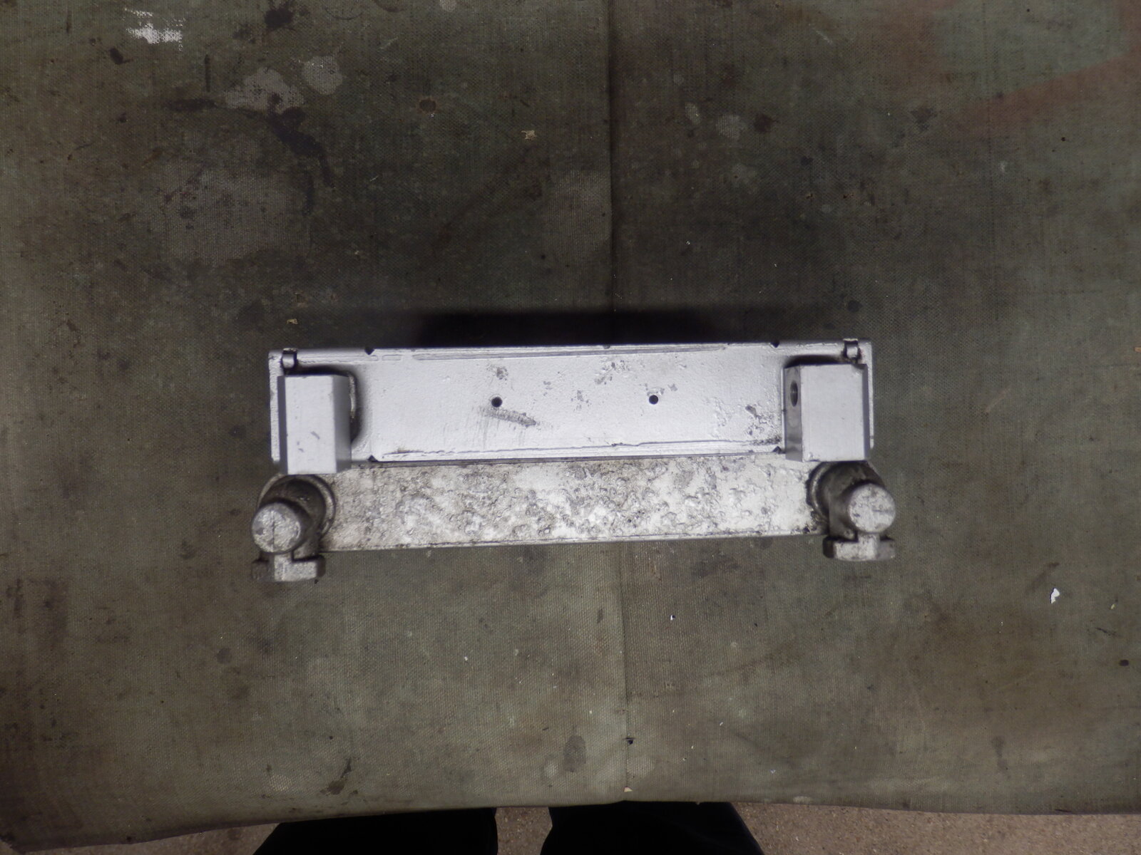

    As you can see the earlier cooler is slightly narrower than the later one 210mm to 225mm:
    But is taller 90mm to 75mm:
    And significantly thicker 40mm to 30mm:
    Earlier Cooler.
    210 x 90 = 18,900mmsq with 9 active cooling paths and 40mm thick.
    Later Cooler.
    225 x 75 = 16,875mmsq with 6 active cooling paths and 30mm thick
    But the Earlier coolers Oil filled galleries are more tightly packed with less surface area of finning between them.
    Does anyone have any evidence that the earlier but far more expensive to manufacture cooler is better than the later one?

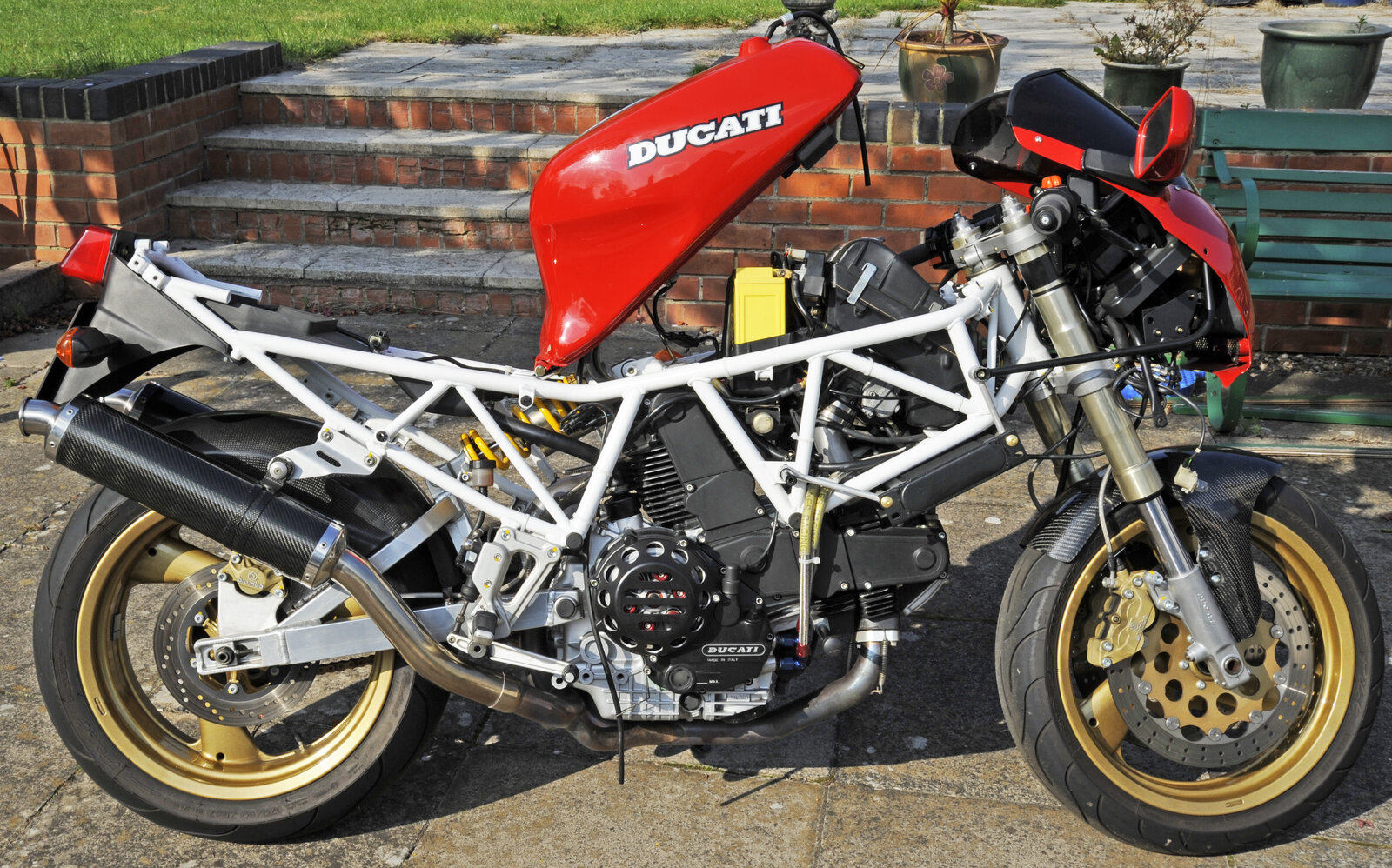

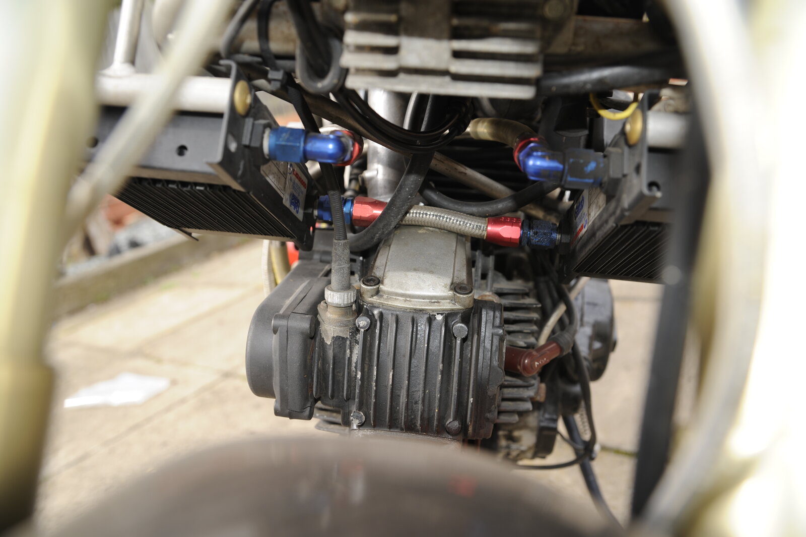

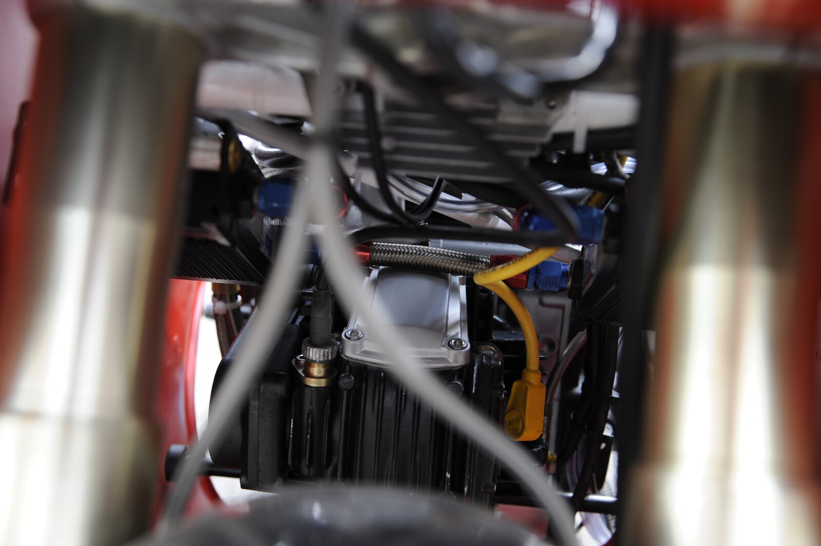

  14. My superlight has twin oil coolers on it. They are on either side of the engine mounted about half way up. It was modded like that when I bought it.
    Can take some pics if you want.
  15. Yes please.
  16. That was a mod Baines Racing developed wasn’t it? Certainly interested in seeing some photos, and details of the coolers (make and p/n) if it’s visible.
  17. Not oil cooler related but RSR Moto make some carbon ducts that direct additional cooling air to the rear cylinder on 91-98 900’s, although realise your issue was with the front cylinder...
  18. Yes they are Baines racing . These pics are from a CD I have from when the bike was restored a few years ago, I hope they are of some use/help! .
  19. That's the same double-cooler Baines kit that I put on my '97 900SS, though I set mine up vertically for better airflow.
    Sorry - too long ago to remember details...
  20. Thanks Doggy, interesting images of the Baines solution.
    It would appear to increase the Cooler area whilst opening up airflow into the V.
