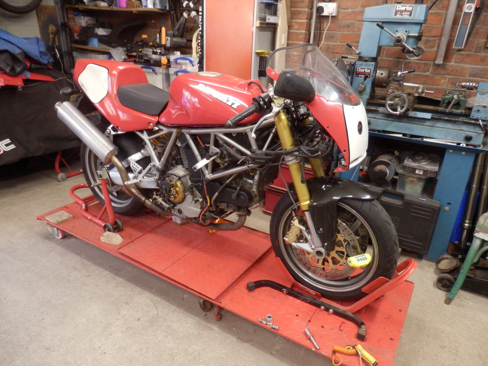

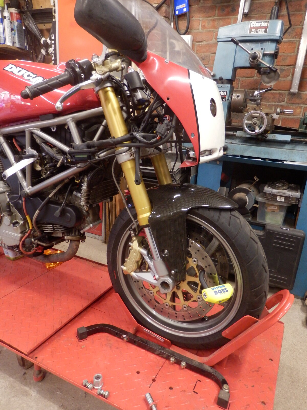

  12. Forks went in the bike today:
    • Like Like x 7

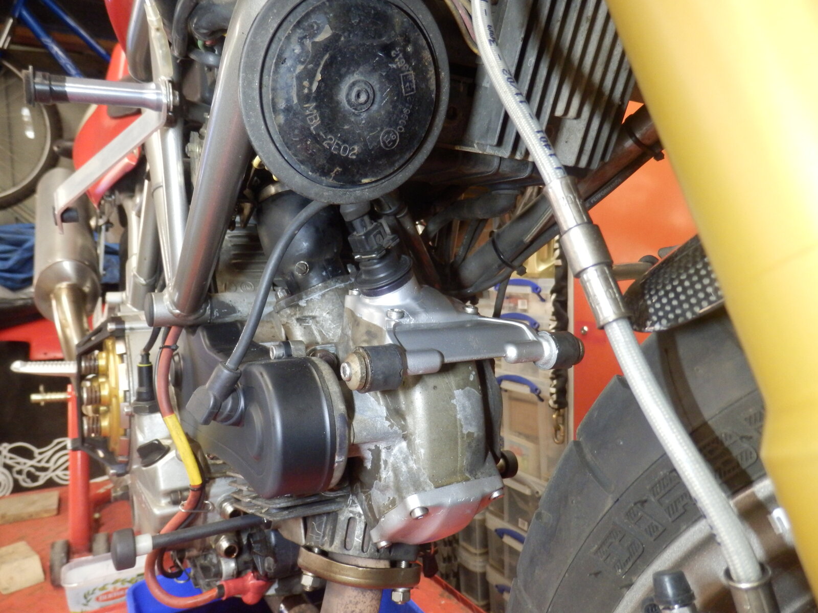

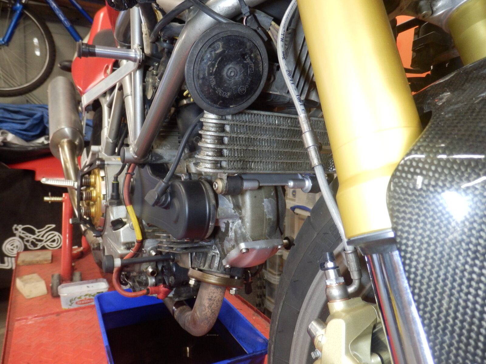

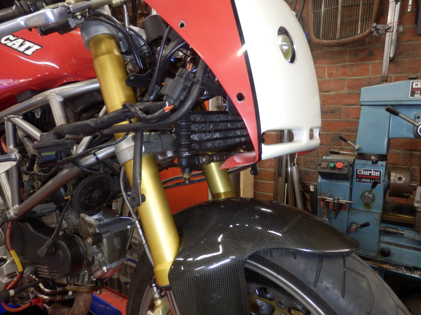

  13. I also managed to have another play with the Multi 1000DS Oil Cooler and Hoses.
    NOTE - Please excuse the state of the engine/bike in these images, it will be cleaned up properly and painted at some stage.
    The standard Oil cooler in position does block airflow to the centre of the V and Vertical Cylinder:
    It's easy to see how much better the flow of cool air would be with it out of the way:

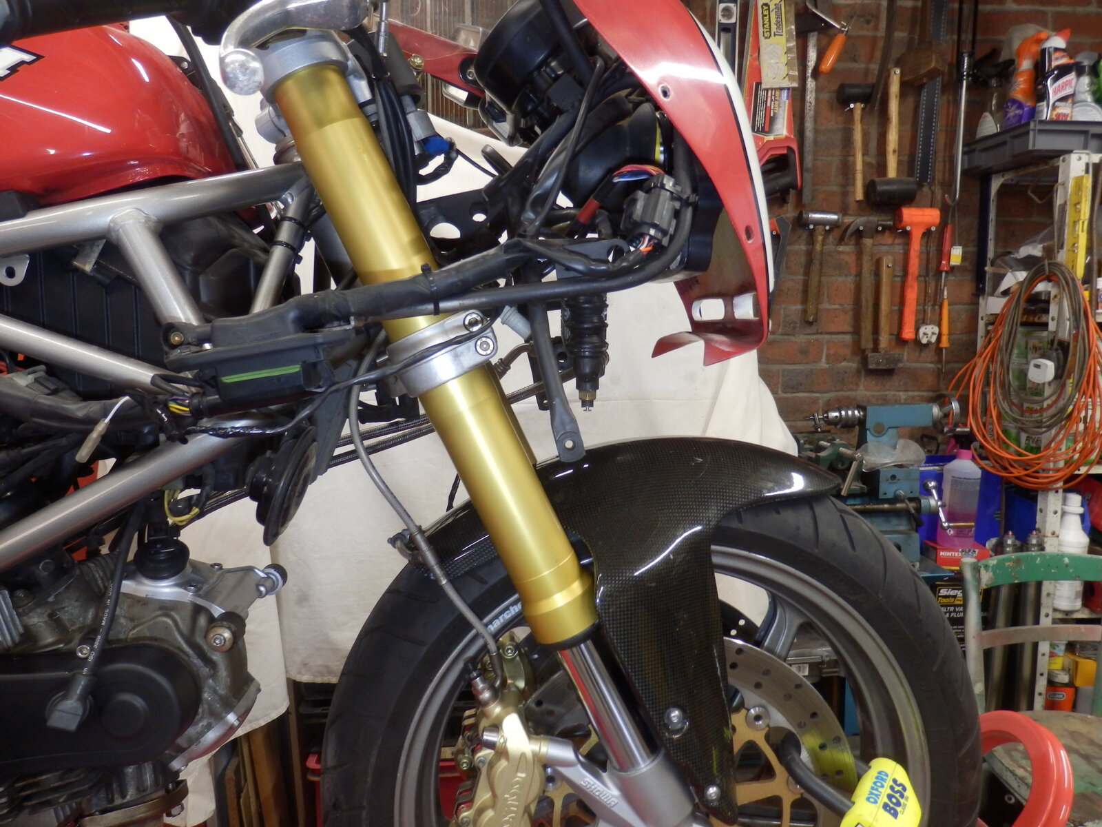

    So I fitted the Multi 1000 Hoses and cooler which was just cable tied in place to see how they sat.
    What I stupidly hadn't thought of until it was in place is that it needs to be high enough to allow full fork compression without the Mudguard touching it.
    So it ends up tucked right up behind the nose cone:
    It needs to come forward about 1/2 inch from where it is pictured to give better clearance to the forks on full lock, and in this position I could probably just get away with refitting the standard nose cone and headlight, something I think I'll end up doing at some stage.
    But, it would only really be fed with air by the two small slots in the nose cone, and I don't really want to cut any more and ruin the look.
    I could add some mesh and spray it White, but I wouldn't be happy.
    So need to cogitate on it a bit more.
    Although, looking at the images the airflow looks a lot better on screen than it did in the flesh.

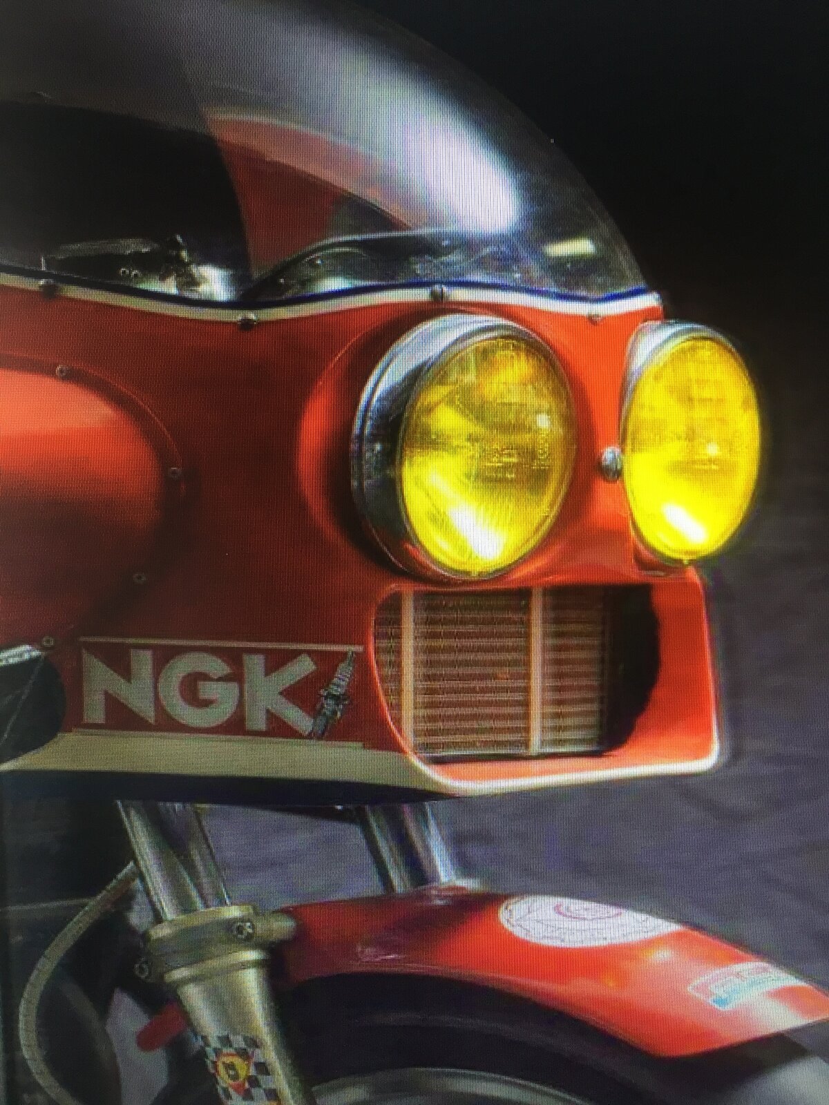

  14. Have you considered feeding the hoses through the slots and mounting the cooler in front of the fairing?
  15. Or go ‘Big Mouth’ to improve airflow and keep the cooler behind the fairing
    A59386A1-51E3-4284-88A8-1871EA203EC0.jpeg 1D55C948-A814-4869-BEC4-DECF3BCB5266.jpeg
  16. Thanks Borgo.
    I think if I was fitting the Cooler 'outside' I'd want to go aftermarket so it looked a bit better, and it would also need longer aftermarket hoses.
    But I really don't think I'd like the look.
    I know a lot of 80's/90s Endurance bikes had Oil Coolers exactly how you describe but I don't think it's for me.
    I need to spend a bit more time looking at the nose cone.
    Your images have made me think.
    Perhaps I could make the two slots a bit taller but keep the same style.
    Increasing their height by 50% would increase air flow massively.
    And perhaps some ducting.
