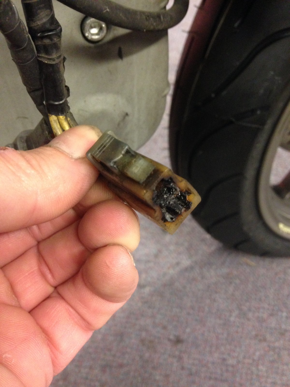

    This one from the r/r. This one's from my 998 but the 848 went exactly the same.
  14. Thanks bettes,
    Mine is ok, but needs a real good clean.
    Thanks ChrisW, the original one on it still then. Did Ducati not recall them all to change the regulator and add a heatshield? Mine has a heatshield fitted between the reg and the exhaust. I assumed they would have replaced the reg with a mosfet?

  16. For my 916 I always soldered the two yellow wires. I kept finding resistance burn outs on the wiring. The connector always seemed to melt etc. Thus I solder them. I always carry a spare electrex RR51 under the seat of my 916 as it loves to eat RR and batteries. Also dont start the 916 whilst its still plugged into an optimate. That chews RR's too for me. I also had my stator rewound by west country windings with thicker yellow cable. Still eats RR's though, the bitch. Ive just put it down to one of her foibles.
