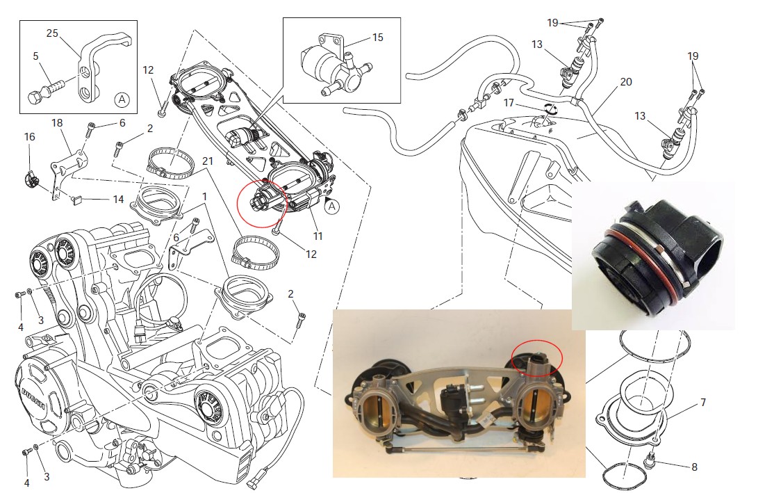

    If someone could tell me where the TPS lives that would be lovely. The Internet stubbornly refuses to say. I've even asked with an accent AND whilst smoking a candy cigarette, but apparently it's refusal to give up this precious, precious secret is not even motivated by racism. Just once I'd like to be discriminated on the grounds of racism. Being thick just hasn't got the same cache.

  6. That's the one in my watch list! Wow- this is liking meeting a celebrity!
    Tell me where the TPS lives and I'll buy one this very instant. 'In the bike somewhere, near all the rats' is not enough enough info, by the way.
