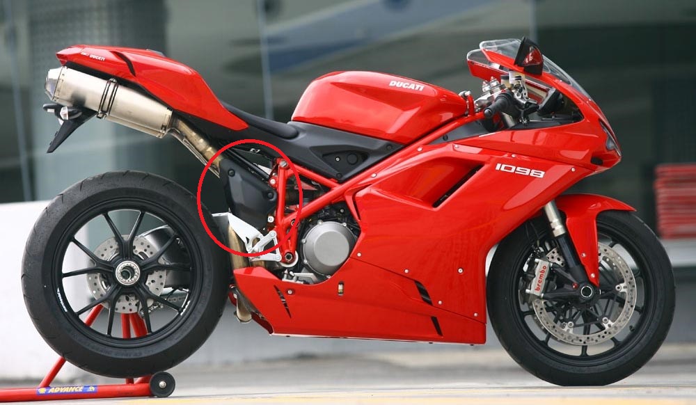

  9. Does it have the oem exhaust? Is the flapper working?
  10. That was my first thought and question to ask. Sounds typical of the same fault with the Multistrada. Andy
  11. It has a Leo Vince system. It's a full system, I think. You think I'd know by now the amount I've had the thing apart.
    Where is it? What should I look for? How can I check it?
    I'm so sorry. I'm well aware the romance is dead for us all. I'll keep trying tho.
  12. Does it have this tray thing?
  13. I don't think so, no. Does this mean no simple fix?
    Oh.
  14. Not the flapper then. :Banghead:
