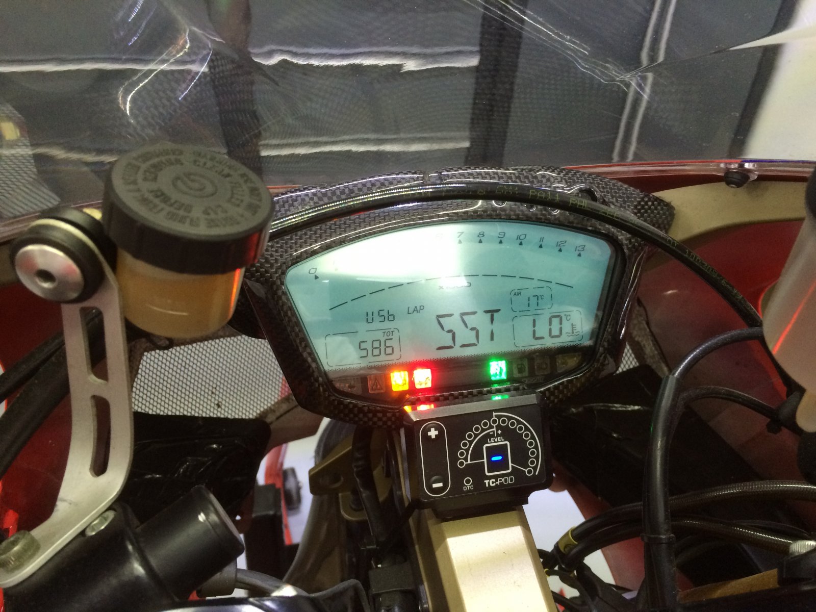

  4. My Multistrada dash has a similar type of message, MRR *** and it is made up of the custom mapper's chosen initials (in my case Moto Rapido Racing) and the map reference, 626. Now you all you need to do is find out who's initials they are. Andy
  5. That's interesting. The map that's on the power commander is made by pro twins so I'm guessing that's what the code refers to.
    Does the fact that the dash is still showing that code without the PC3 connected suggest that the original ECU has been reflashed, or does that code just stay logged in the dashboard no matter what? Am unsure as to whether it's 'live' or not.
  6. Fingers crossed fella!
  7. Although I prepared to be corrected, it looks like you have an ECU that has been previously flashed with a non standard map. I do not gelieve the PC3 has anything to do with the dash message. It is very possible the PC3 has been added as a "cheaper" option to a remap after the engine had been played with either up or down in specification. Andy
  8. If it helps at all, I'm pretty confident this is the same message that was coming up on the dash when the PC3 was connected.
  9. 1098 SSTK 626 is the Superstock 1098R ECU
  10. I feel more impressive to women already.
  11. That's what my google search told me as well. No reason why it still shouldn't run?
  12. It runs fella. It's in my post. I'm just making sure now I'm not too lean etc etc.
  13. Hilariously, when I googled it, it brought up this thread.

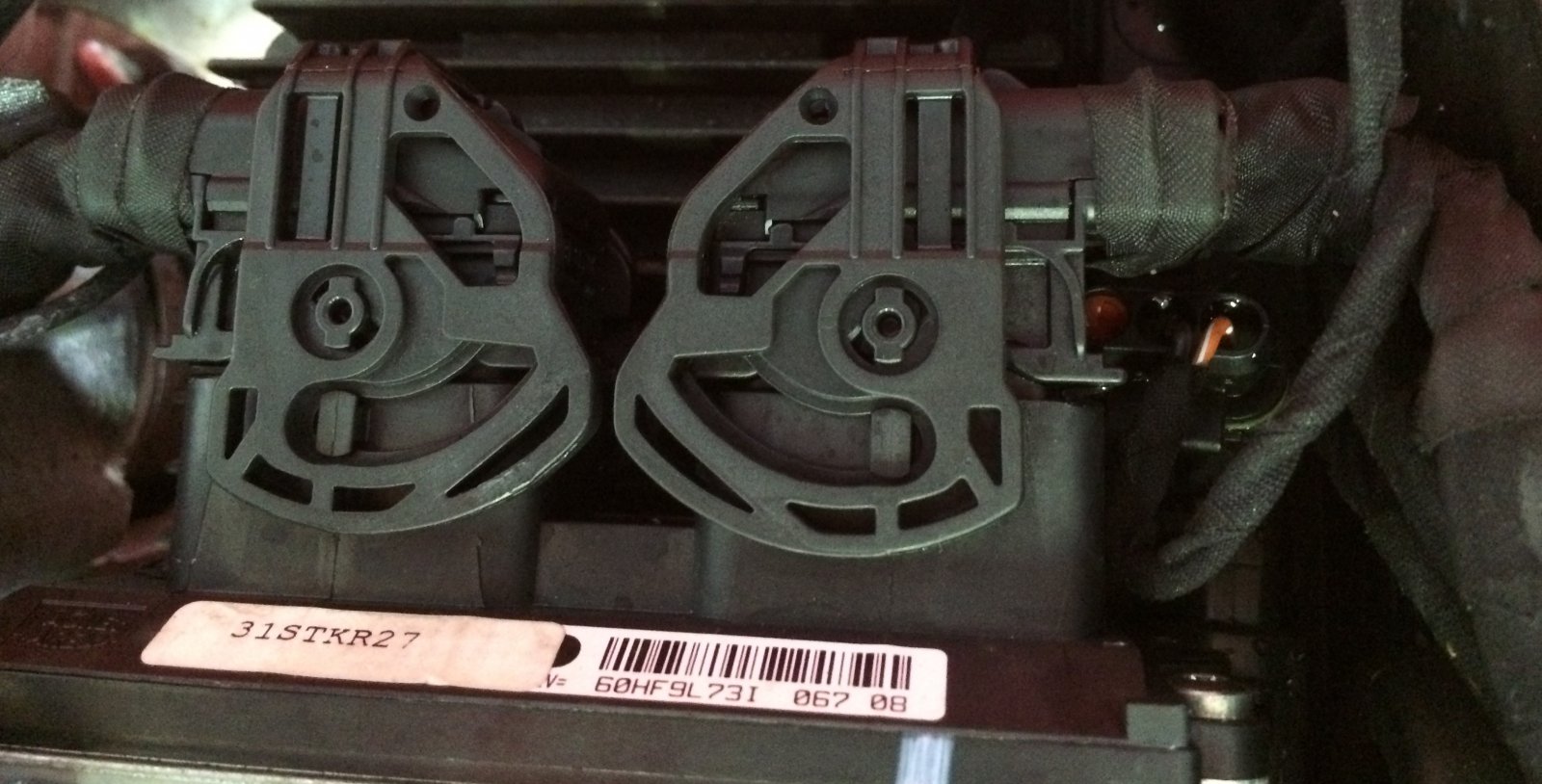

  16. I think IIRC that the stock racing ECU (for a full Termi system) would show 1098 EVO. At some point the ECU has been switched to a super stock one, which would have had a custom map flashed to the EPROM. Do you still have the bone stock ECU you could try? I'm assuming you are running a full system with the current SSTK one. Not sure Pro Twins would have adjusted the map on the SSTK ECU other than just flash an appropriate one to it, as they don't have any dyno facilities. I bought my last 5 bikes from there. Maybe give Rob or Brett a ring for some background info on your bike.
  17. Thanks, I'm going to do exactly this tomorrow.
  18. My 1098R came with fitted with a SSTK027 ECU. I know nothing about it other than JHP did some tuning and fitted it. I get the message "SSTK*027" when turning on the ignition.
    The standard ECU and the 1098 Racing Termignoni ecu were in a box of spares.
