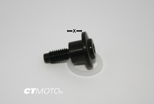

  4. according to this site Star Twin: the online shop for Ducati OEM spare parts and accessories. To fix the exhuast cover I need the following:
    3 x M5 x 12 bolts
    3 x SPACER 5.2X8.4X2
    3 x Washers
    Also interesting to read that the middle section without postage would have cost £350 to buy new, €476.54 converted using 1.36 as rate of exchange.
