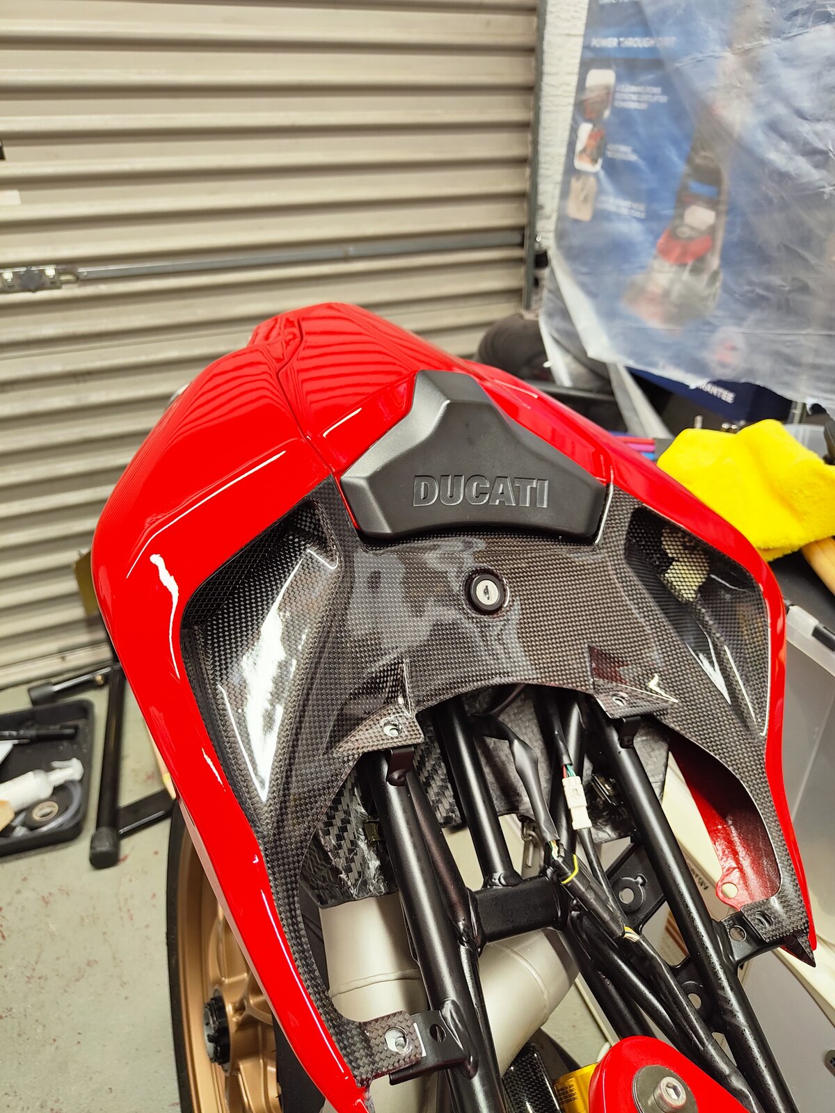

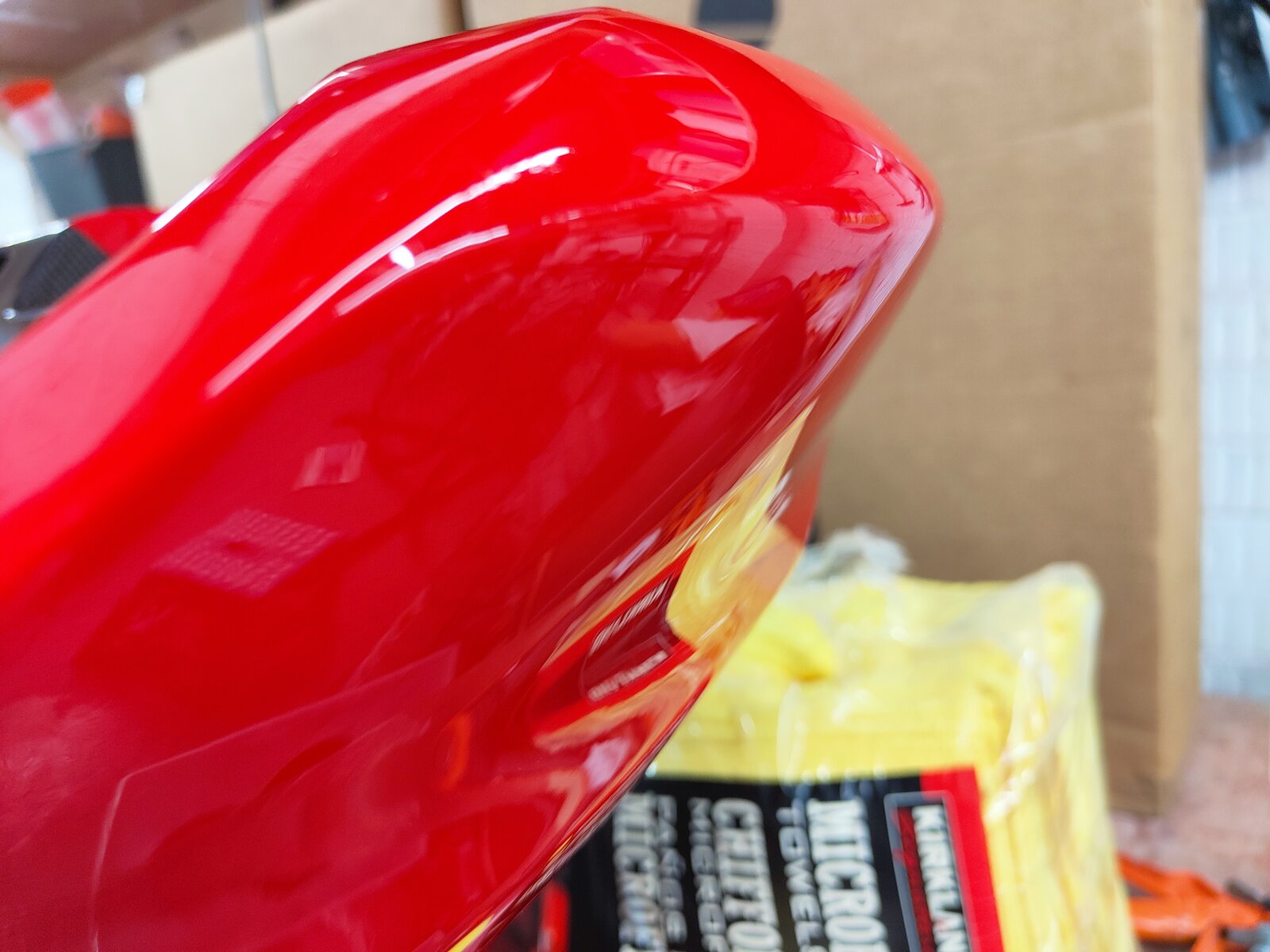

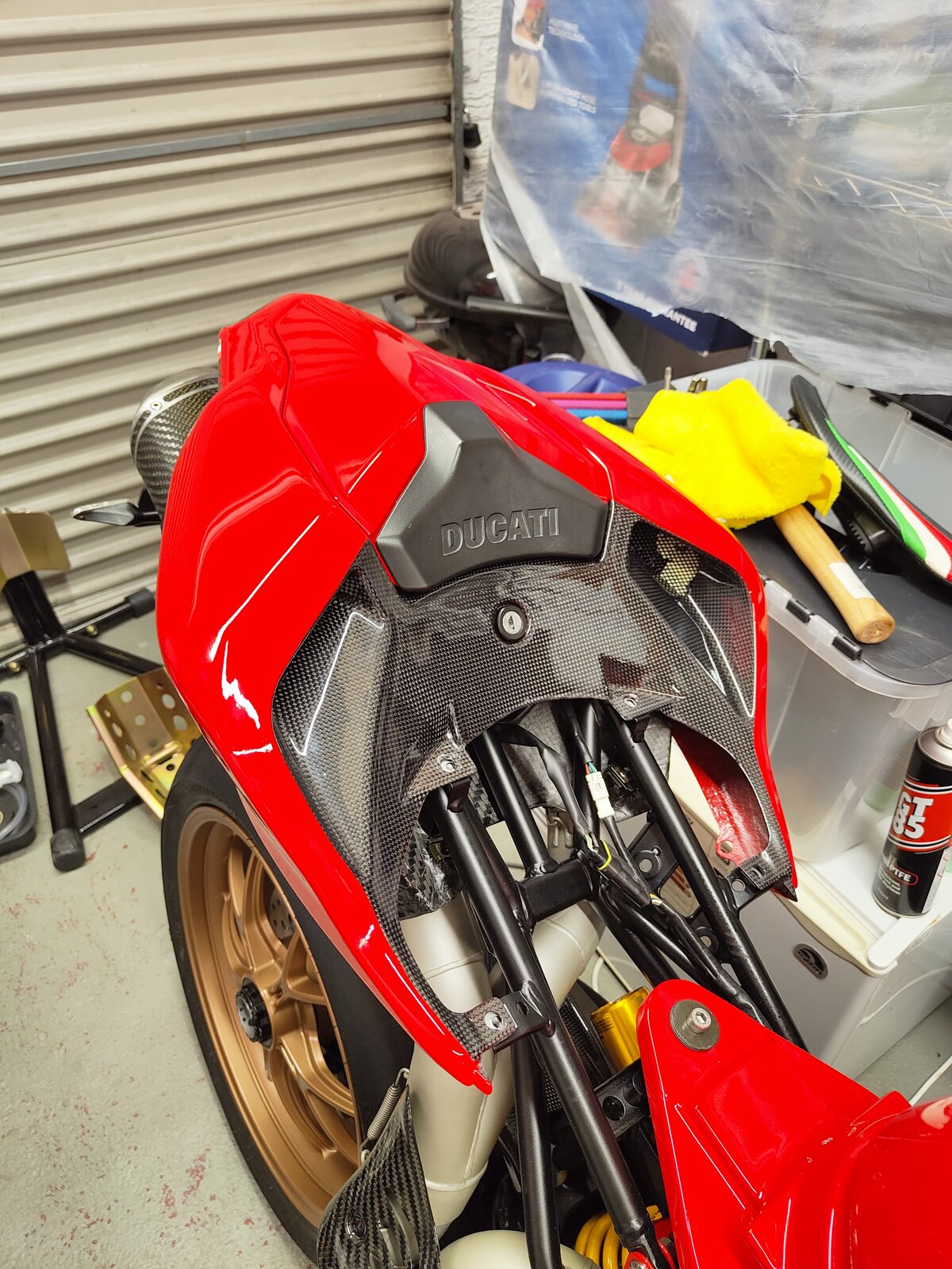

  1. Got the tail unit flatted, polished, grilles stuck in and all fitted this evening, I'm happy with how that's turned out IMG20220419172325.jpg IMG20220419182844.jpg IMG20220419192748.jpg IMG20220419192753.jpg
    Then I had to take it off again because I'd forgotten to take off the masking tape holding the left hand grille in while the sikaflex got hold
    The clip on alignment tool I ordered arrived so I've got them lined up and the fasteners torqued to spec,
    Only thing I'm waiting on now are the fuel tank infill panels, Tyga reckon they're going to be here by the 26th so I think I might book an MOT this week so it's ready to go when they arrive.

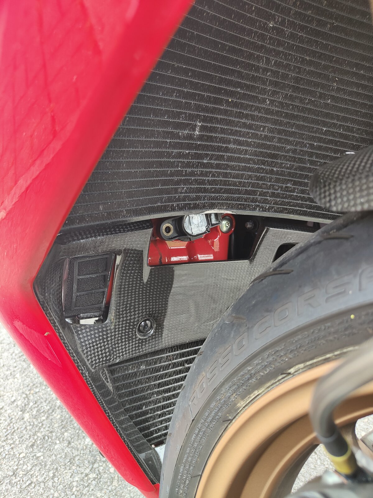

    Bad news is that an error code for 'fan, 18.2' popped up on the way home, on further inspection the left hand side fan was extremely stiff to turn, it turns out that there is enough 'adjustment' in the rad mounting to wedge the fan up against the throttle cable tubes where they mount to the bracket on the front of the airbox.
    This is now resolved and the fan turns freely but it had popped the 7.5a fuse for the fan and it looks like it's let the smoke out of the relay too, so the bike is now sat in the garage with the LHS fairing off, and to get to the relays I've had to drain the coolant to move the bottom hose and pull the main harness forward. I've fitted a new fuse, and ordered a pair of relays from RS components that hopefully I can collect tomorrow. Not bad if that's the only snagging from a full rebuild.

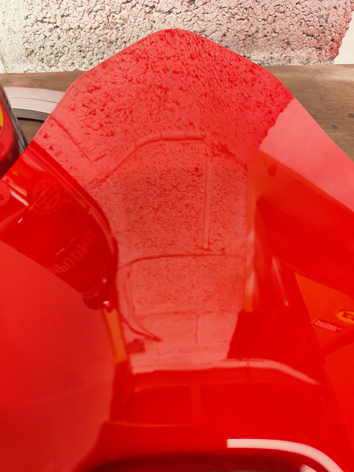

  3. Nice spraying, what you using?
  4. Thanks,
    Nothing fancy, a Clarke 50L compressor, ANI r160q midi spray gun in 1.2 for colour and clear, and a cheap ANI GF3 in 1.8 for primer. I use an in-line regulator and water trap on the bottom of the gun.
    Paint wise the red is 2k direct gloss from Nu-Agane, I think they've got a Kapci or Octoral system, everything else - HS clear, hardener, thinners is Upol system 25 stuff.

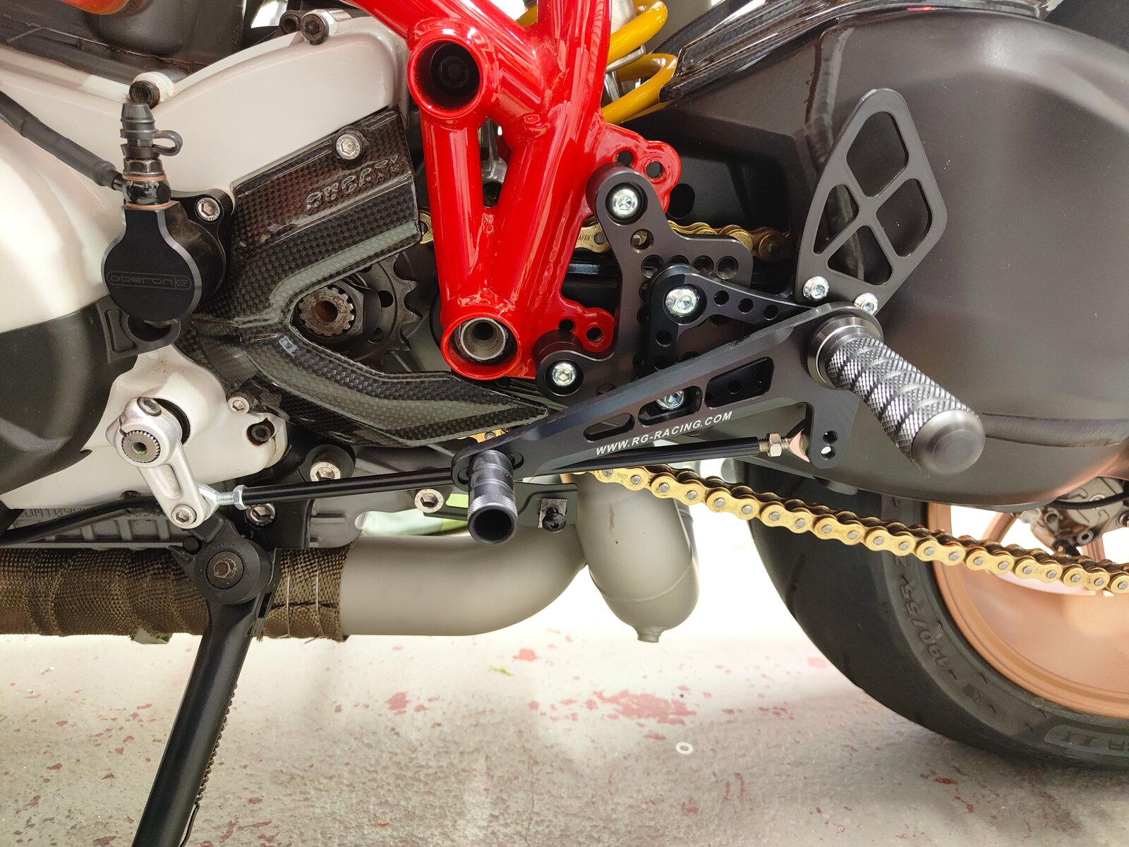

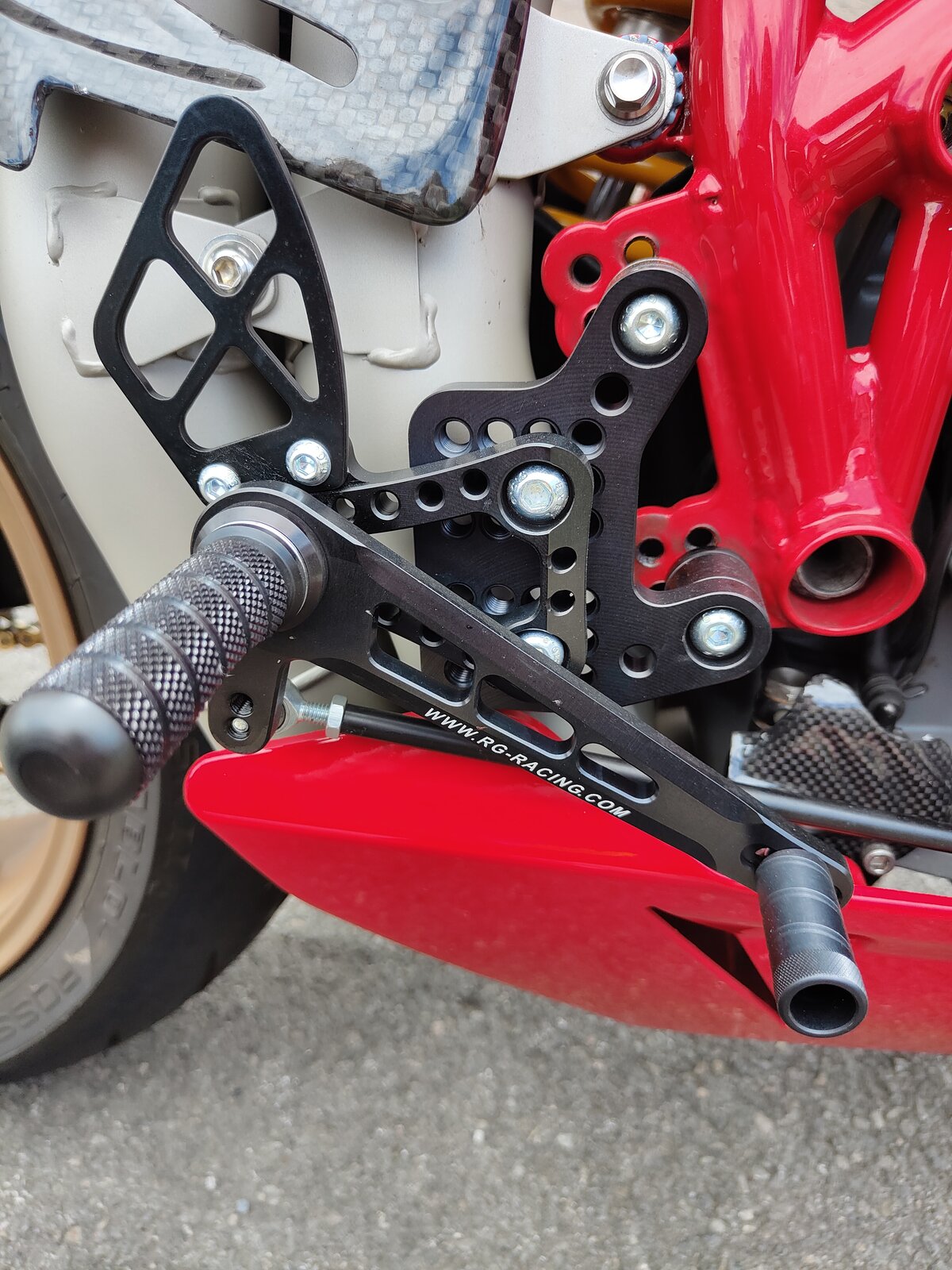

    I've swapped the Spider rearsets for some R&G ones, I just couldn't get on with the spider ones, too high and far forward for my long legs, annoyingly I can't send the spider ones back, so I'll need to sell them on.

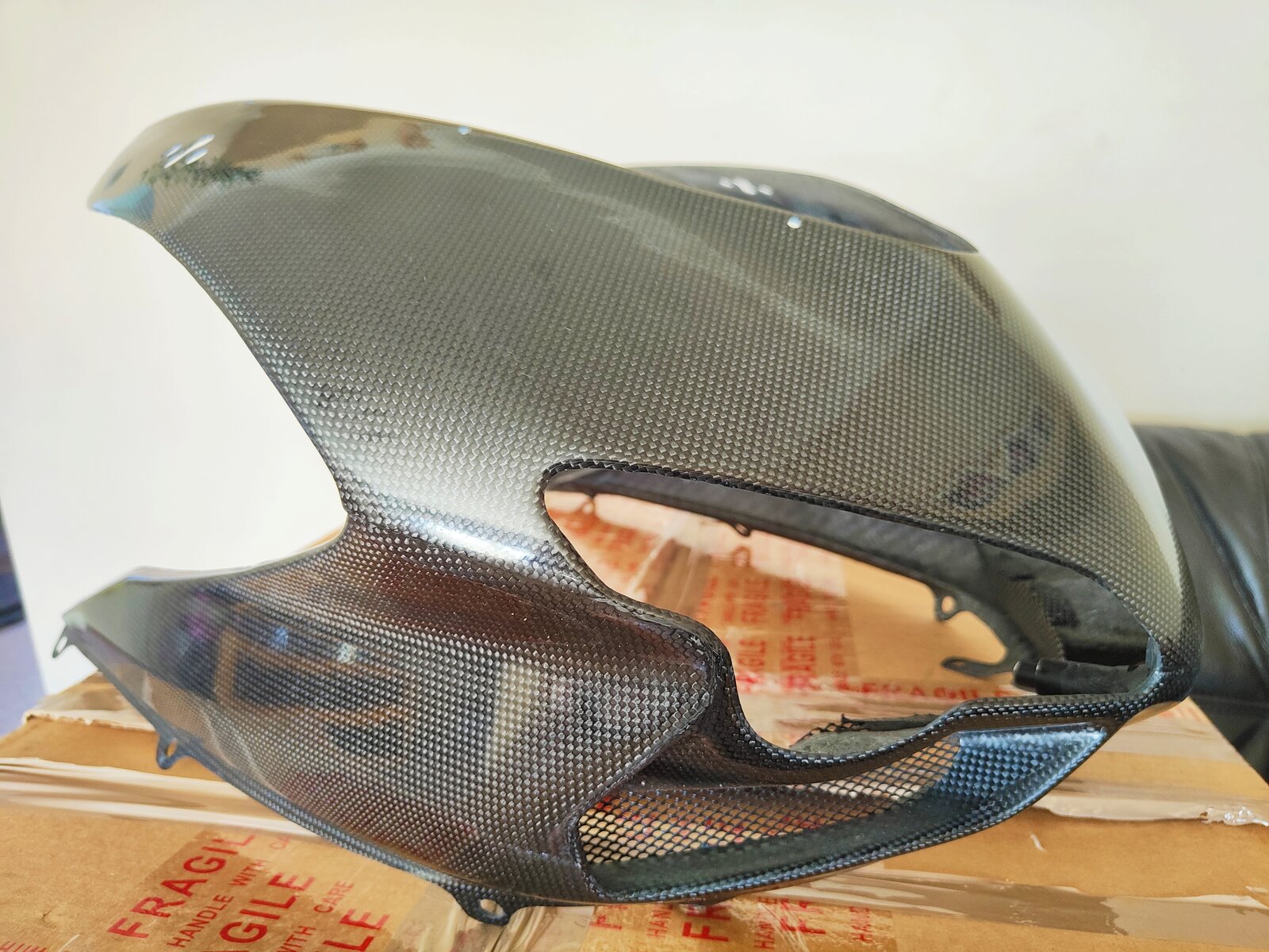

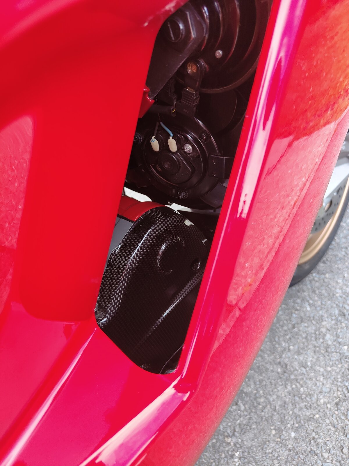

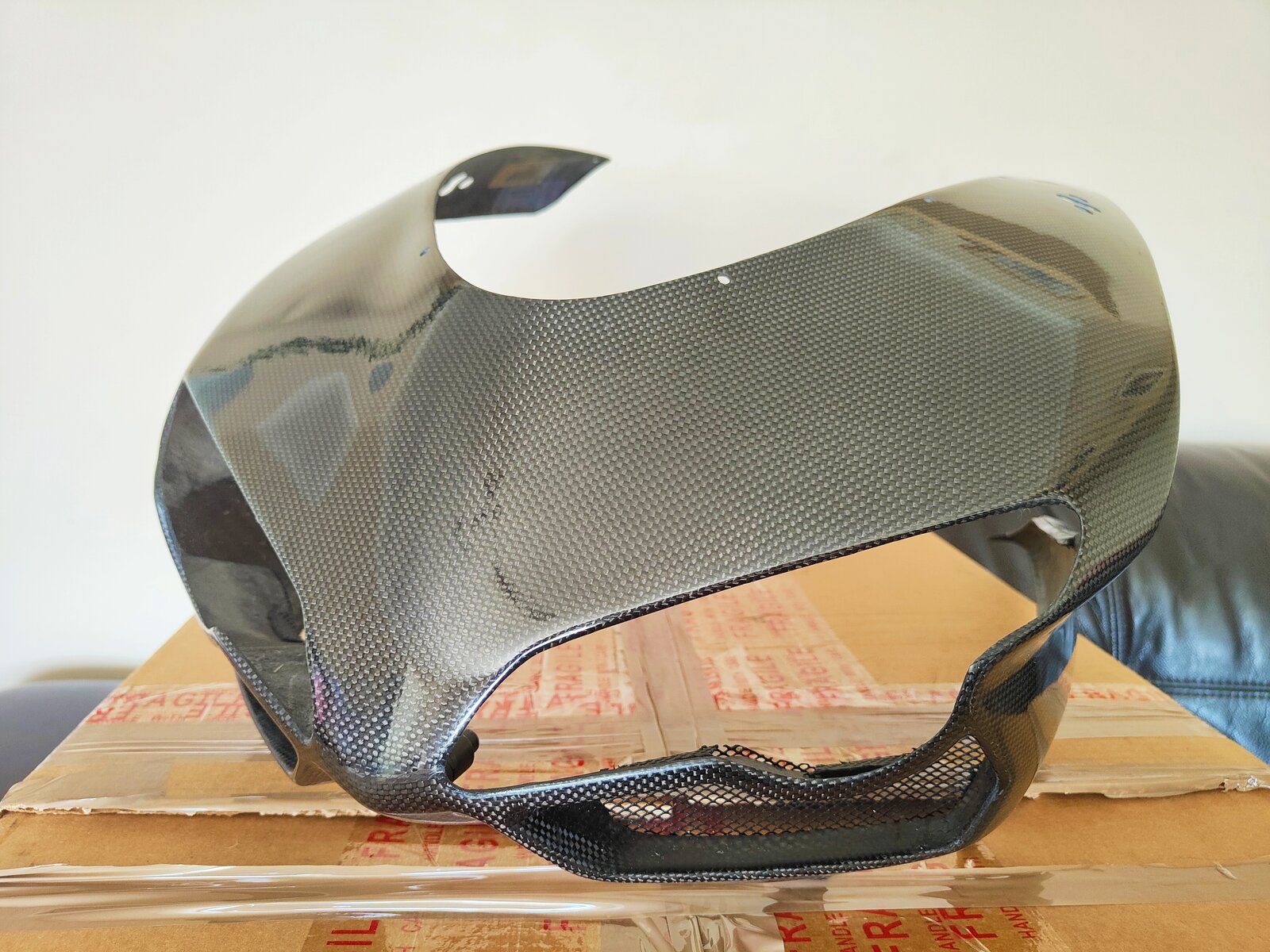

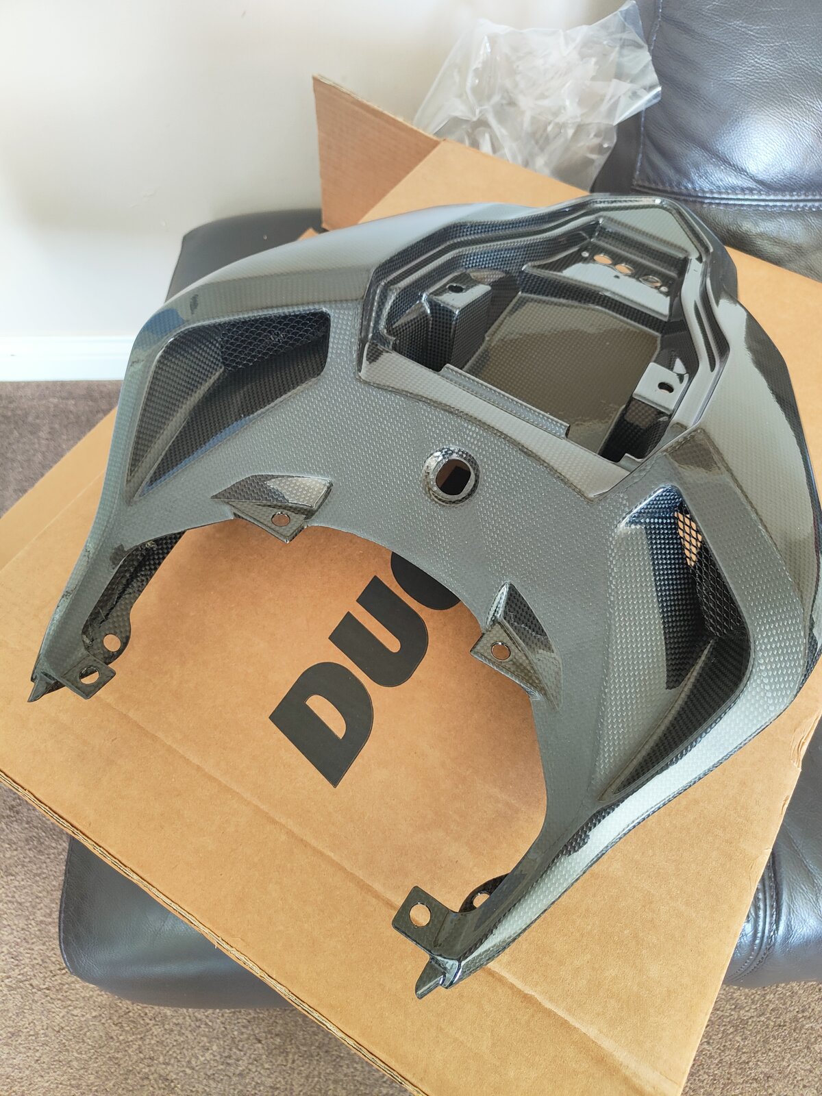

    IMG_20220421_125544.jpg IMG_20220421_125602.jpg IMG20220419092047.jpg IMG20220419092100.jpg
    Both NOS genuine Ducati parts, I'm on the lookout for some quality carbon side fairings and belly pan too... Either OEM, fullsix, Ilmberger etc.. no China rubbish.
    Still no sign of the carbon fuel tank side panels from Tyga too.. very disappointing.
    I cancelled the order with reactive parts after "2-3 weeks" turned into nearly five, then Tyga's UK distributer had a set listed on eBay as 'last one' and a delivery date of a week or so, which implies they're in stock. Sadly this is a bait and switch, as when I contacted them a couple of days before the 'predicted' delivery date is got some BS message from them saying "we are currently waiting on a delivery of these you should have had a message stating this did you not get it ?" So why advertise them as 'last set' and a delivery date of a week if they're not in UK stock and need to be made in Thailand :mad::triumph: beware if you're thinking of ordering anything from 'jap4performance'

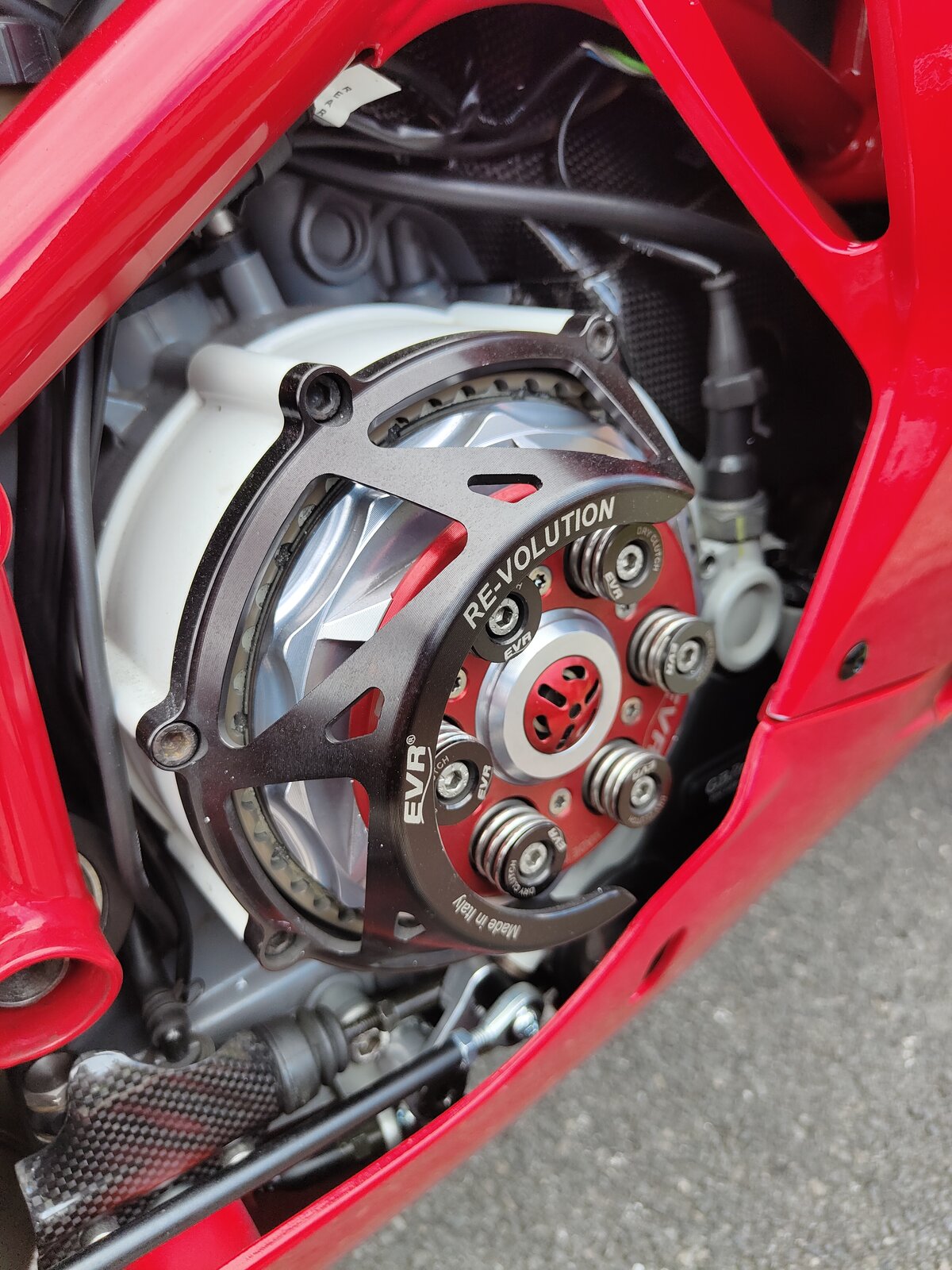

  6. How did you find the Oberon slave cylinder on your test ride? I’ve been considering one, however there seems to be numerous complaints online that the larger cylinder bore does not release the clutch enough to engage neutral and in some cases not disengage enough for gear shifts, is there any truth to this?
  7. Yes and no.. with my previous clutch (well worn) I had no issues, with the new one, with a stack height at the top end of the range it can be awkward to get into neutral when stationary with the engine running, but not impossible.
    I usually just make sure I'm in neutral as I'm rolling to a stop, I'm not aware of anyone having problems actually changing gear due to one, and haven't experienced that myself.

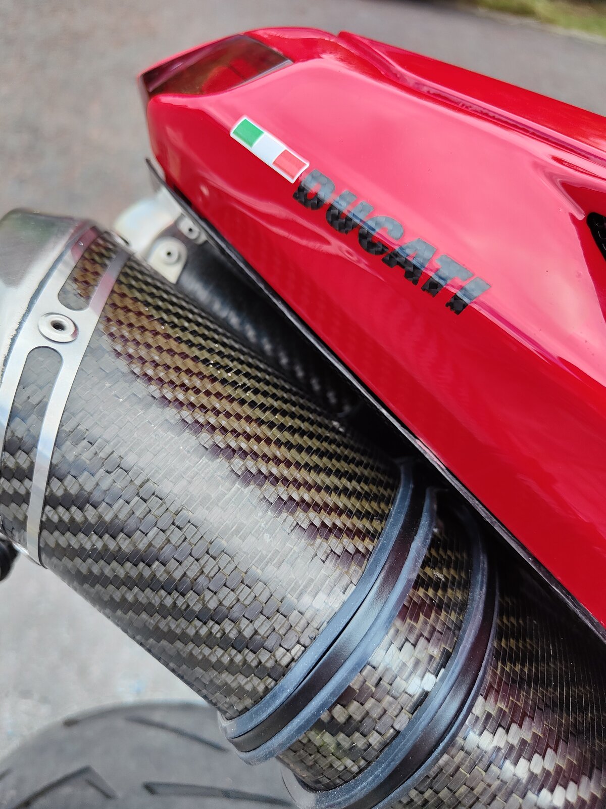

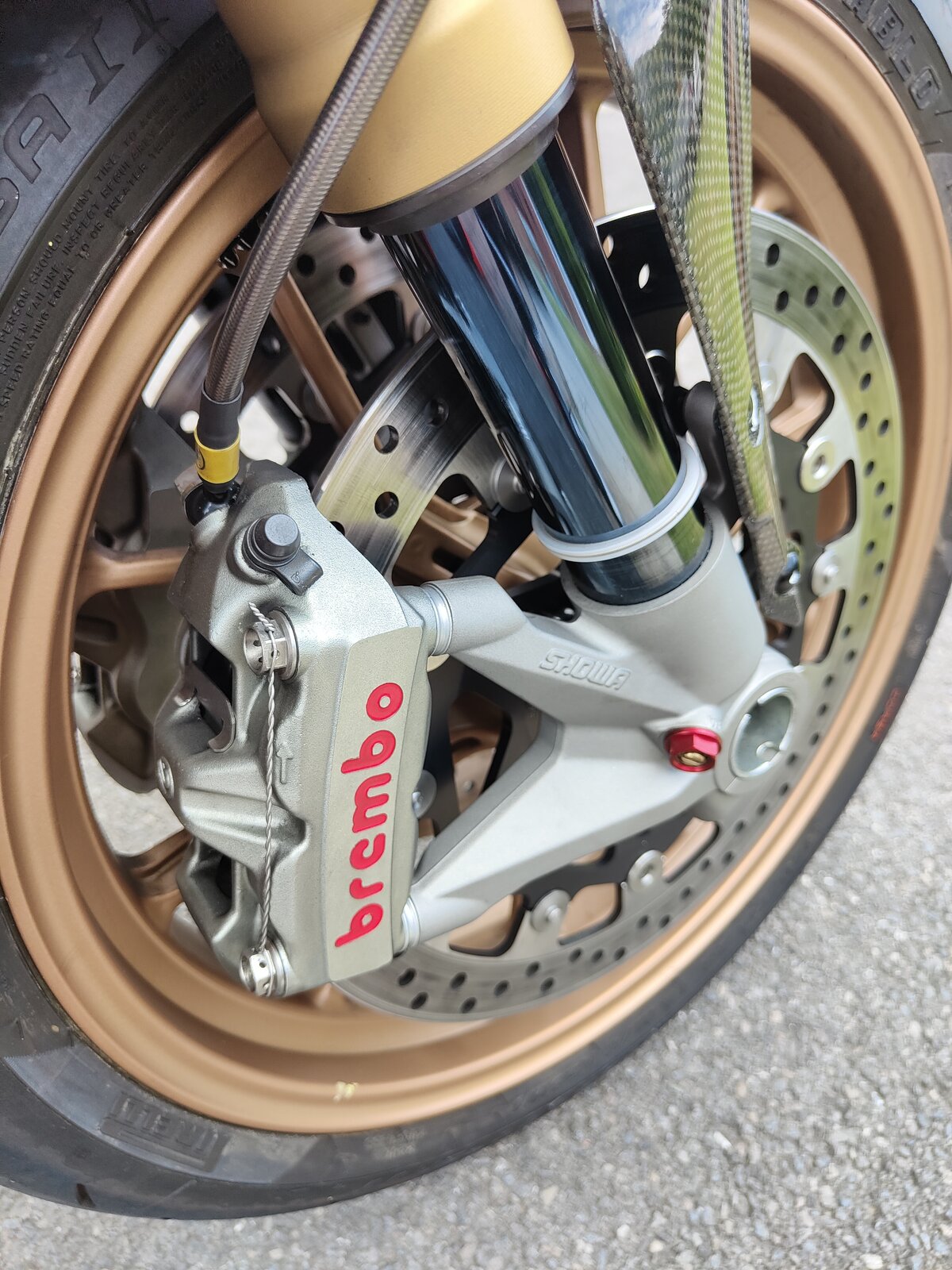

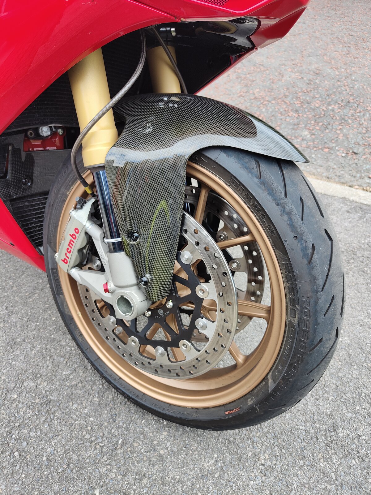

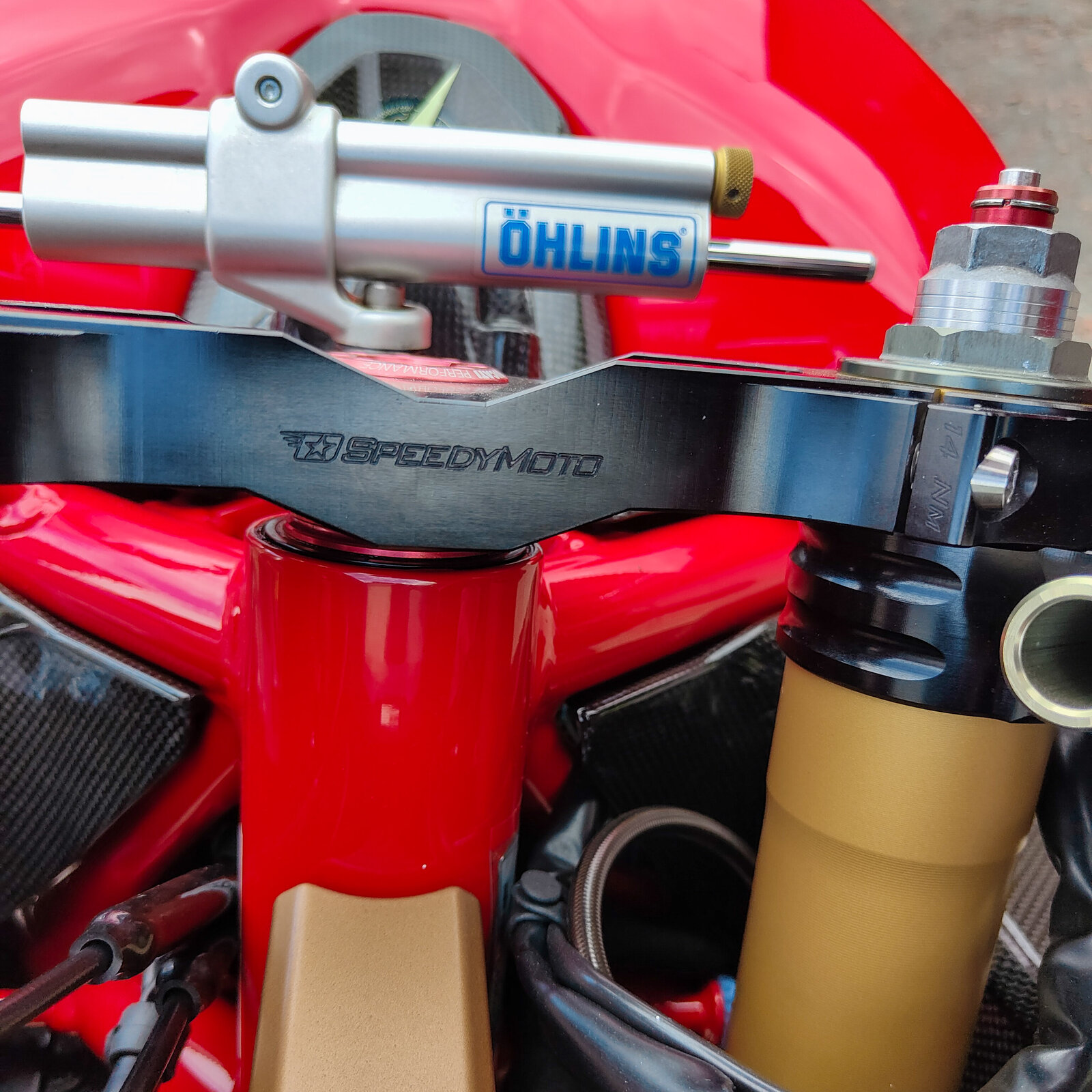

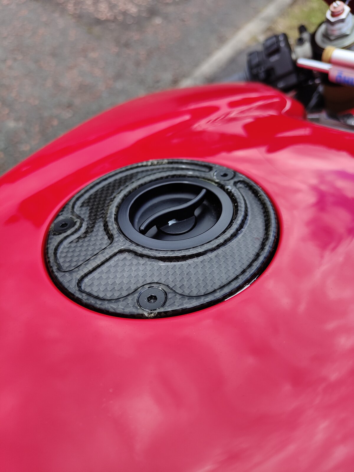

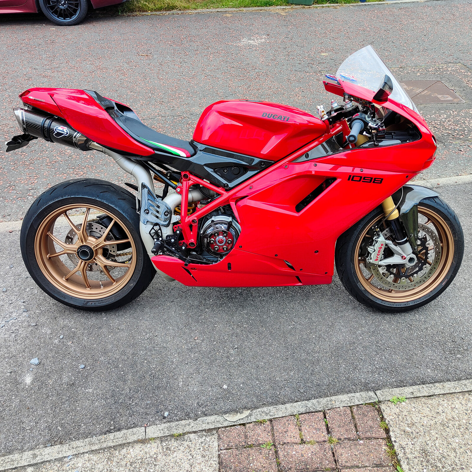

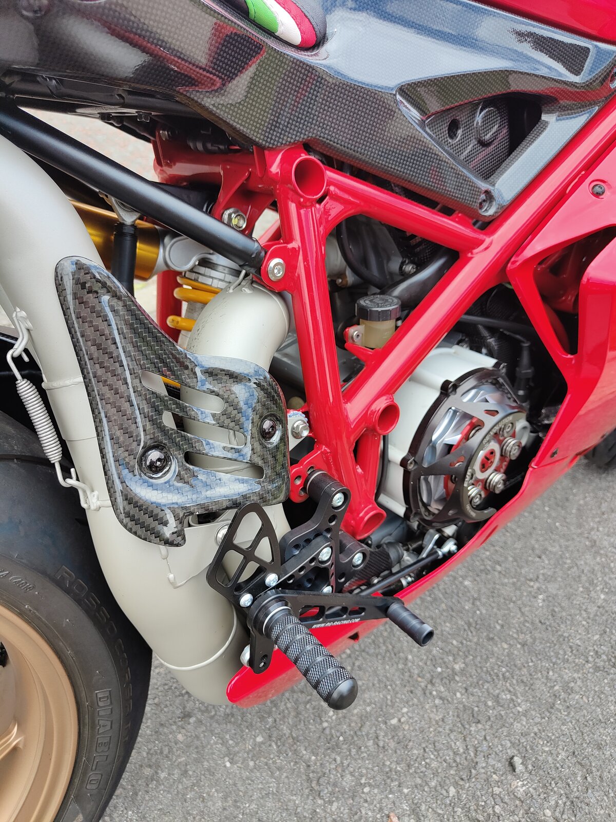

  14. PSX_20220703_130114.jpg PSX_20220703_130022.jpg IMG20220703124515.jpg IMG20220703124502.jpg IMG20220703124448.jpg IMG20220703124443.jpg IMG20220703124421.jpg IMG20220703124411.jpg IMG20220703124403.jpg IMG20220703124358.jpg IMG20220703124354.jpg IMG20220703124349.jpg IMG20220703124344.jpg IMG20220703124338.jpg IMG20220703124320.jpg IMG20220703124125.jpg IMG20220703124117.jpg

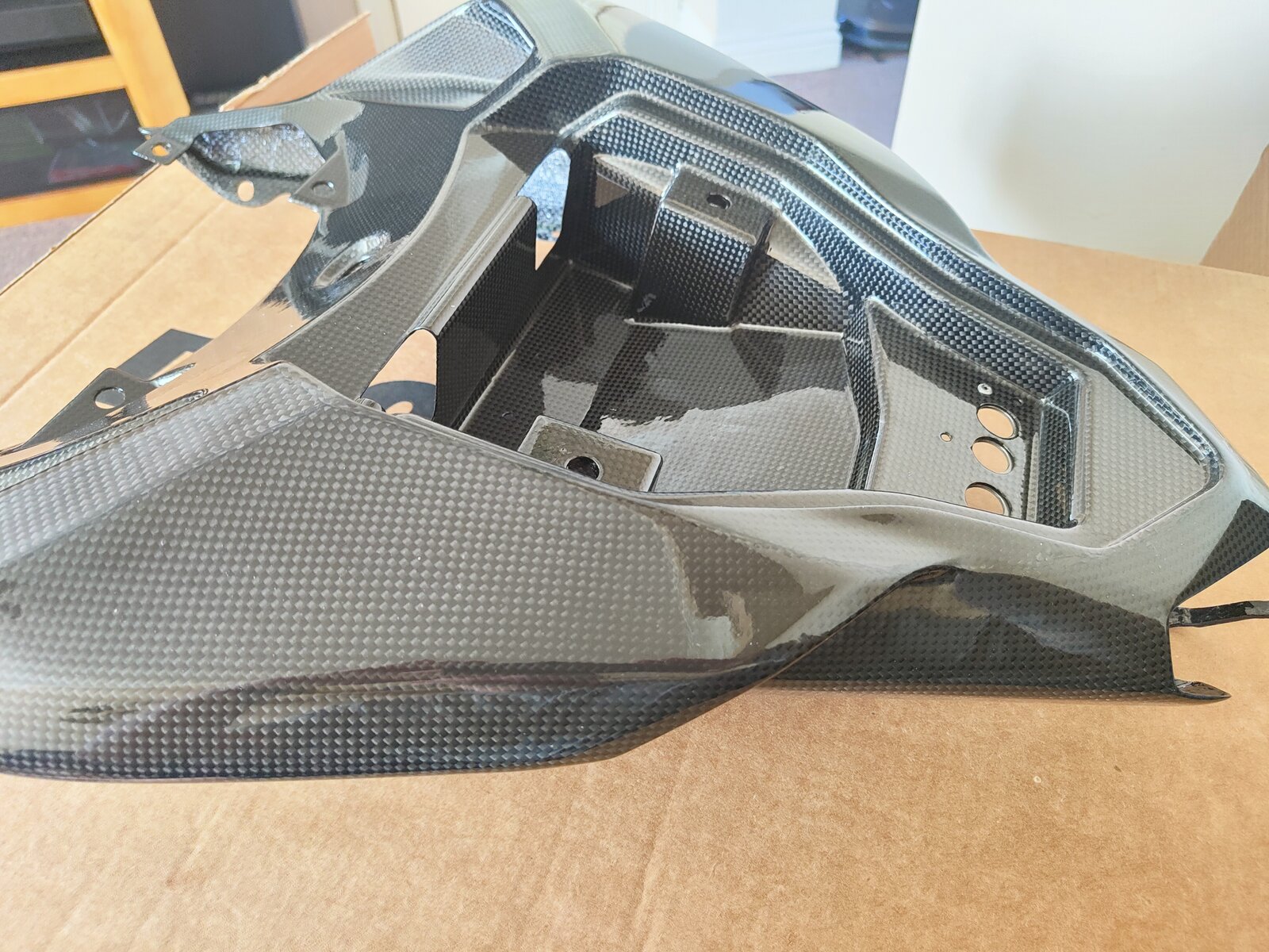

    Few pics post ride today, carbon side/ under tank panels fitted, I got bored of waiting for Tyga to come up with them so ended up buying some NOS genuine Ducati ones.
