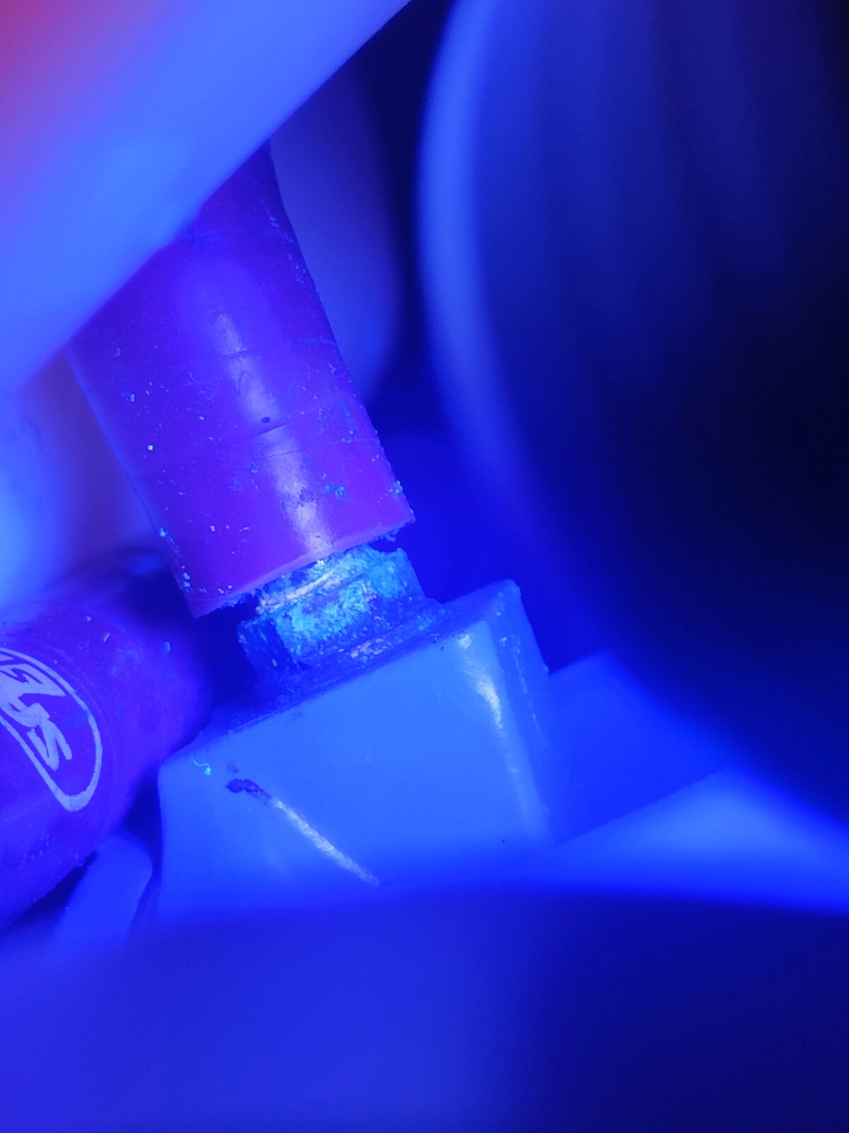

    I noticed a coolant leak, there would be a thimble full of coolant under the bike when it had been sat for a while, with the aid of some UV dye in the coolant I've traced it to a hose barb on the top of the horizontal cylinder head. The hose clamp was fully tightened down but not tight on the hose, that's been replaced with a new clamp a size down and the issue seems to be fixed now

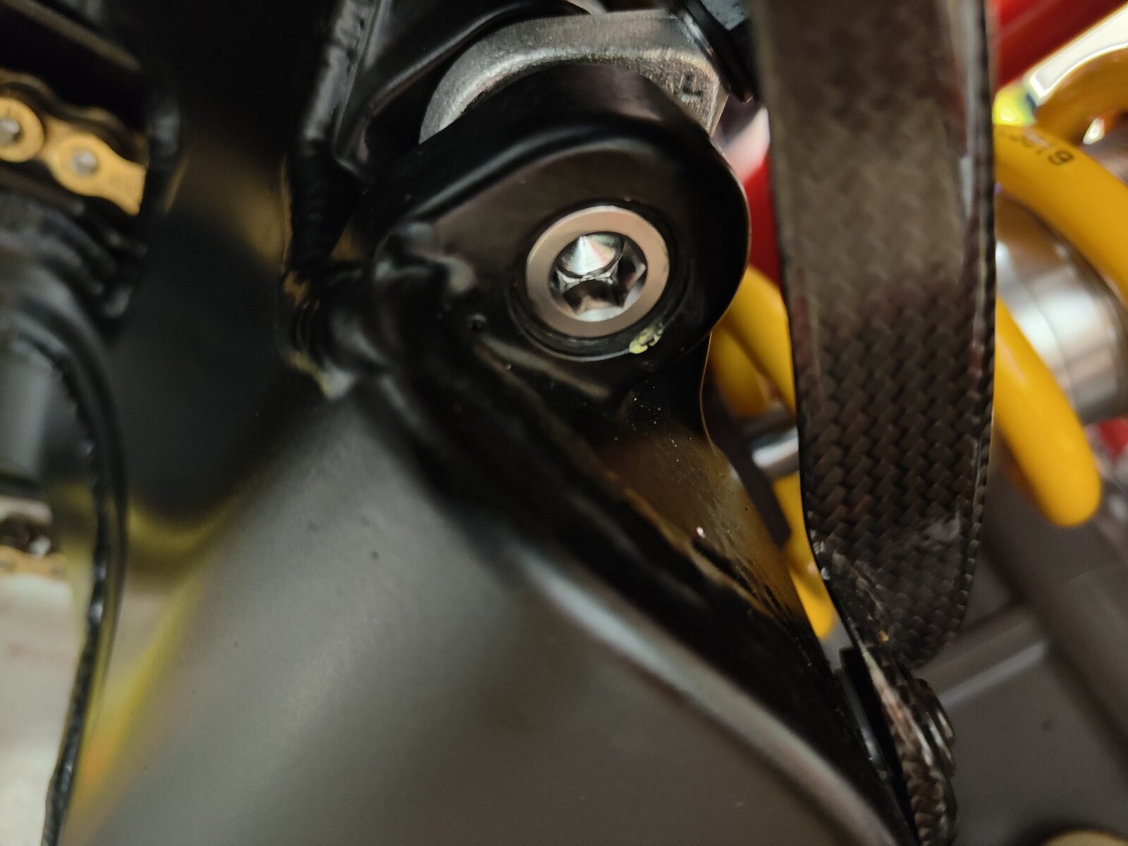

  3. Been a while since I updated this.. I took the bike off the road around September 22, and slowly chipped away at jobs when I was home, I removed the rear shock and linkage to investigate the clunk, I thought it was the shock bearings but it turns out not to have been..
    So with the shock proved healthy I decided to replace the shock linkage bearings with new SKF ones and all of the fasteners for the shock/linkage with titanium ones from podium racing, chased the thread in the swingarm and I think there may have been some blasting grit in there causing the old bolt to bind up before fully securing the shock as it's all fine now.

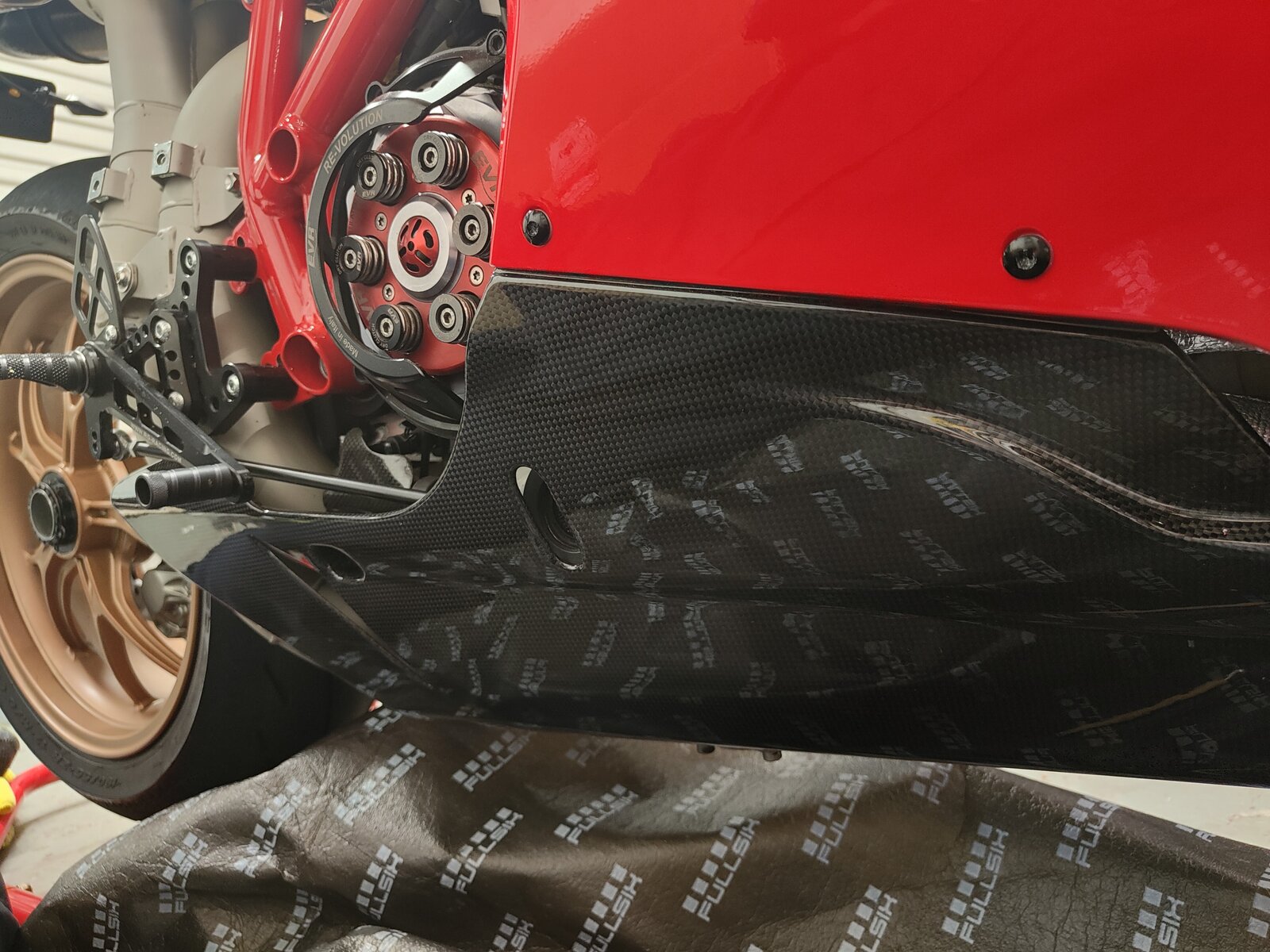

    With that sorted and the exhaust etc back on I got to fit the fullsix belly pan, which I've lined under the exhaust with zircoflex 3 heat shield IMG20230324173203.jpg
    Which looks lovely fitted:

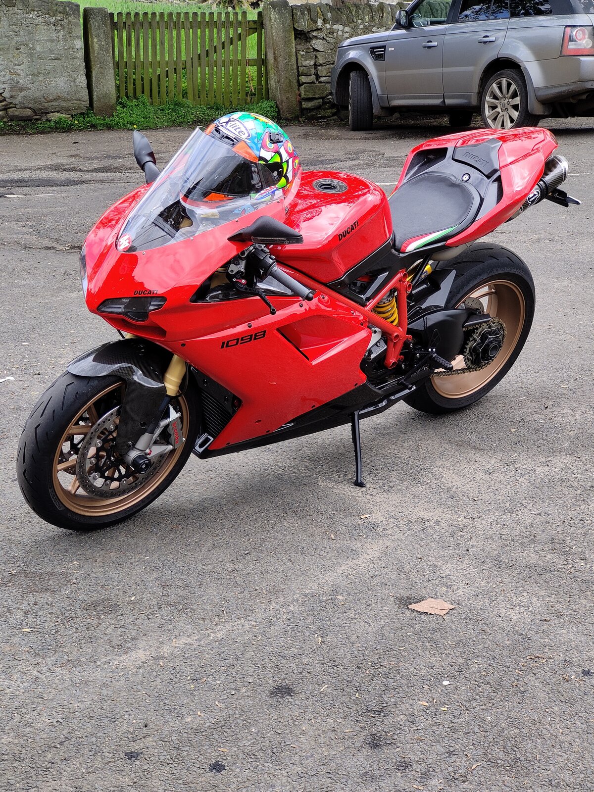

    Now the weather is getting better I've had it out a couple of times, last weekend to a country pub that has a 'supercar Sunday' meet.
    I'm still on the lookout for some carbon side fairings, annoyingly fullsix and carbonin have discontinued them, and ilmberger ones are quite pricey... I wouldn't say no to an alloy tank and a superpole seat if they came up for sale either..
