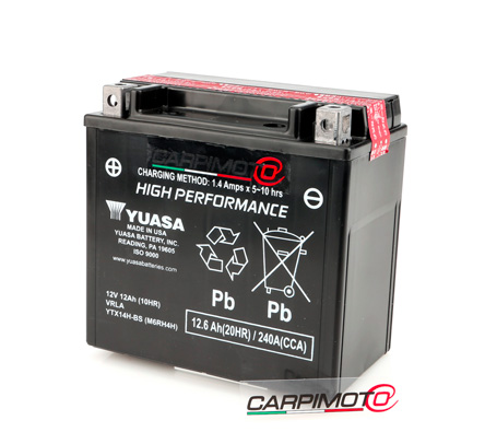

  11. YT12-BS is only 10Ah, I wouldn’t bother. Andy
  12. The YT12b was superseded as OEM fitment in 2010 due to it being too weak. The larger YTX14 fits in the battery box with the padding removed. The picture is of a higher power fitment that was recommended on here by a member (not available back in the day)
