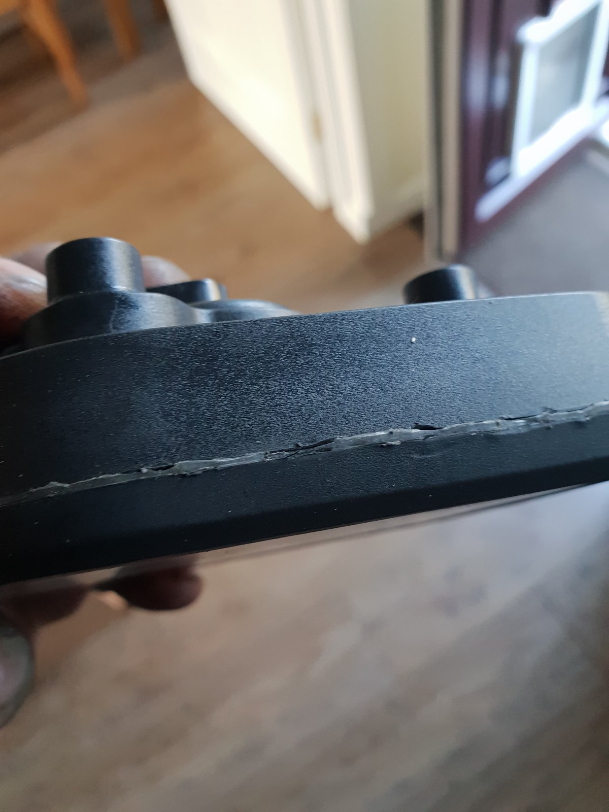

  11. No alarm fitted, but close inspection of clocks, looks like they have been apart in the past
  12. I think you might be getting warm..
  13. Are the clocks matched to the ECU?
  14. as standard, yes
  15. Oh fuck lol
  16. It may have once had a cracked screen or still may. This is a fairly ccommon issue and the previous owner may have taken it apart to fix/inspect.
  17. Plugged the dash back in, guess what, they wont light up, double checked everything and still wont work, wonder if its been the clocks all along, f$$k knows where i go from here
