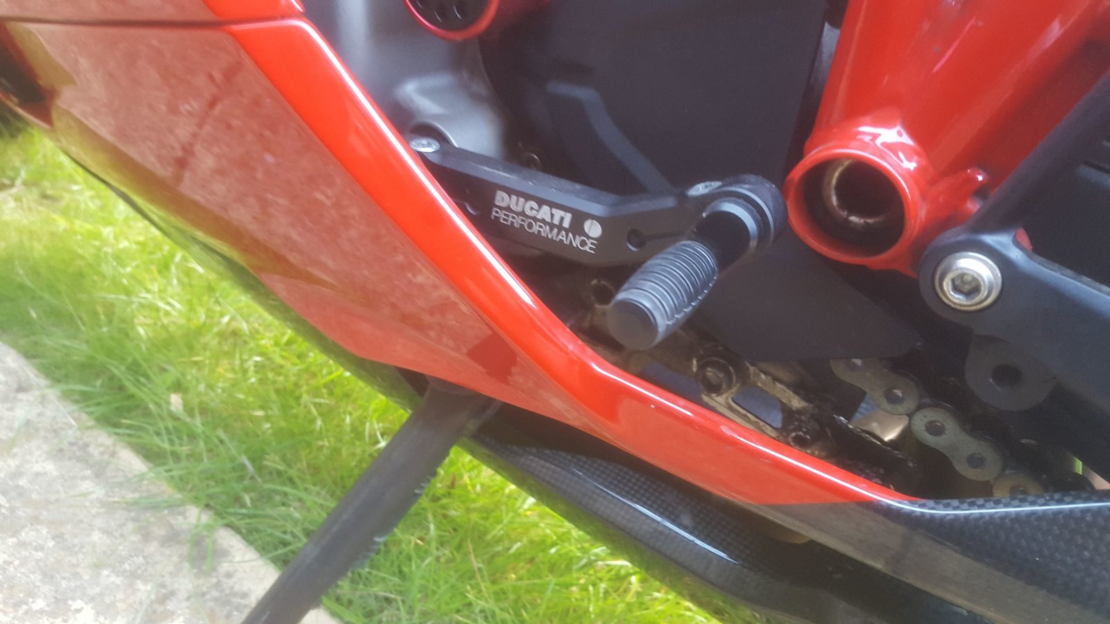

    SOOO....mega thanks to Nelly at Cornerspeed for figuring this one out...!!!
    I dropped the bike off earlier to get the belts and the fork oils done.....told him I had trouble launching the bike also....he had a look and told me I had a race shift fitted. So I was actually in 5/6th when I thought I was in 1st....DOH! I was wondering why there was no linkage at the gear lever! Amateur!

  13. My 1098R has a race shift too and is a bugger to get away from a standstill. :motorcycleduc: I'm pretty sure it's for the reasons I posted above, not because I'm putting it in top gear though. :laughing:
  14. I am with you Sonic, when I picked up mine I thought the gearbox was shagged , and then a wiser man than me showed me that the linkage was upside down :-/
    It's still a bit of a tractor off the line mind , considering dropping it down a tooth at the front - may help front tyre life :)
