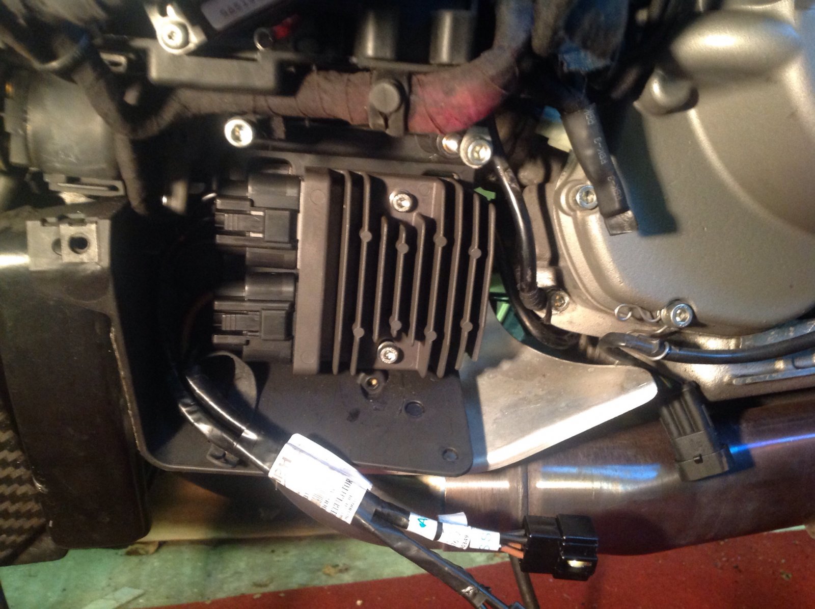

  13. Update
    Got Mosfet R/R yesterday from USA.
    Got Triumph leads.
    Installed today.
    Idle voltage across battery: 14.4V.
    I reckon that's sorted it.

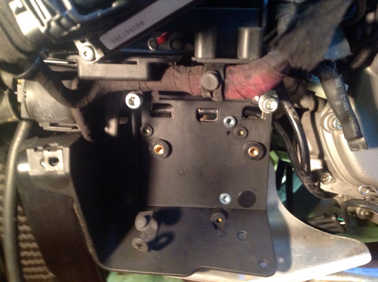

    Didn't bother with a mounting plate as I couldn't see how I would get at the mount bolts as the R/R mounting holes mean that you can't access them once in place.
    I installed some rivnuts directly into the battery box where the R/R fits so I can remove it without the need to access from behind.
  14. Looking good mate! Don't want to tempt fate or anything but did you remove the battery tray before drilling? It's just that the starter cable is clipped to the tray along the bottom edge just behind it. No need to ask how I found that out. :Banghead:
  15. I spotted the cable when I was doing my investigation on how to best fit the R/R, so I carefully moved it out of the way before I drilled the plastic tray. I did notice some metallic swarf whenI drilled it and thought "oh bugger, hit the cable" but then I realised it was the foils backing on the tray! Phew!
    May I enquire as to how you knew??? Lol!
  16. No need! :) I was just very lucky. Missed the cable by 1 or 2 mm. Lesson learned.
  17. Hey - nice clean install bud.... Sorry went all US there for a moment...Wont happen again...:Bag:
  18. Are you still using the original connector for the 3 yellow wires? Just asking as I'm about to do this to the 998 and I've already had to remove the burned stator side connector. Still unsure as to solder and heat shrink the cables or use bullet connectors and heat shrink.
  19. Yes, I used the original connector for the yellow wires. It wasn't showing any signs of overheating and it is a direct plug n' play with the Triumph connecting loom-ette.
