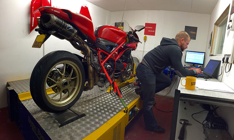

  1. So although the dyno shootout that I had with a few mates saw my 1098R as the victor, I was not entirely happy. Why? The bike was fueling poorly throughout (too rich), and it was very lumpy and too edgy in how it got to the top end. Something was not right. So I decided to seek the advice and expertise of Chris at CJS who I felt could diagnose my bike (new to them) objectively.
    Chris corrected a number of MotoRapido mapping errors and improved them. He also balanced the throttle bodies as MR had not done these. After the 100+ miles on the return journey home, the bike is completely transformed. It is almost V4 like in the smoothness at higher RPMs, and the on-demand thrust in any gear is ace. There is NO hesitancy, far less edginess, and greater linearity - whilst running cooler too. Greater pull everywhere and greater user-friendliness to use the increased power/torque available.

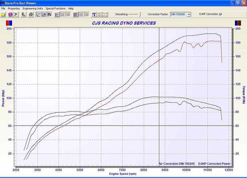

    The dynoplot below tells the story of before (MotoRapido) vs after (CJS). She made the magic Ton in torque - 102 ft lbs peak, but with 80ftlbs from just 4k rpm, 90ftlbs at 7k rpm, and 100+ftlbs between 8-10k rpm. Horsepower gains are +10bhp across almost the entire curve. c.194bhp peak at the wheel. My bike is now how it should have been from the very beginning! Credit where credit is due - Chris has done a top job :)

  2. Great numbers, near those numbers on my build and I'll be well happy
