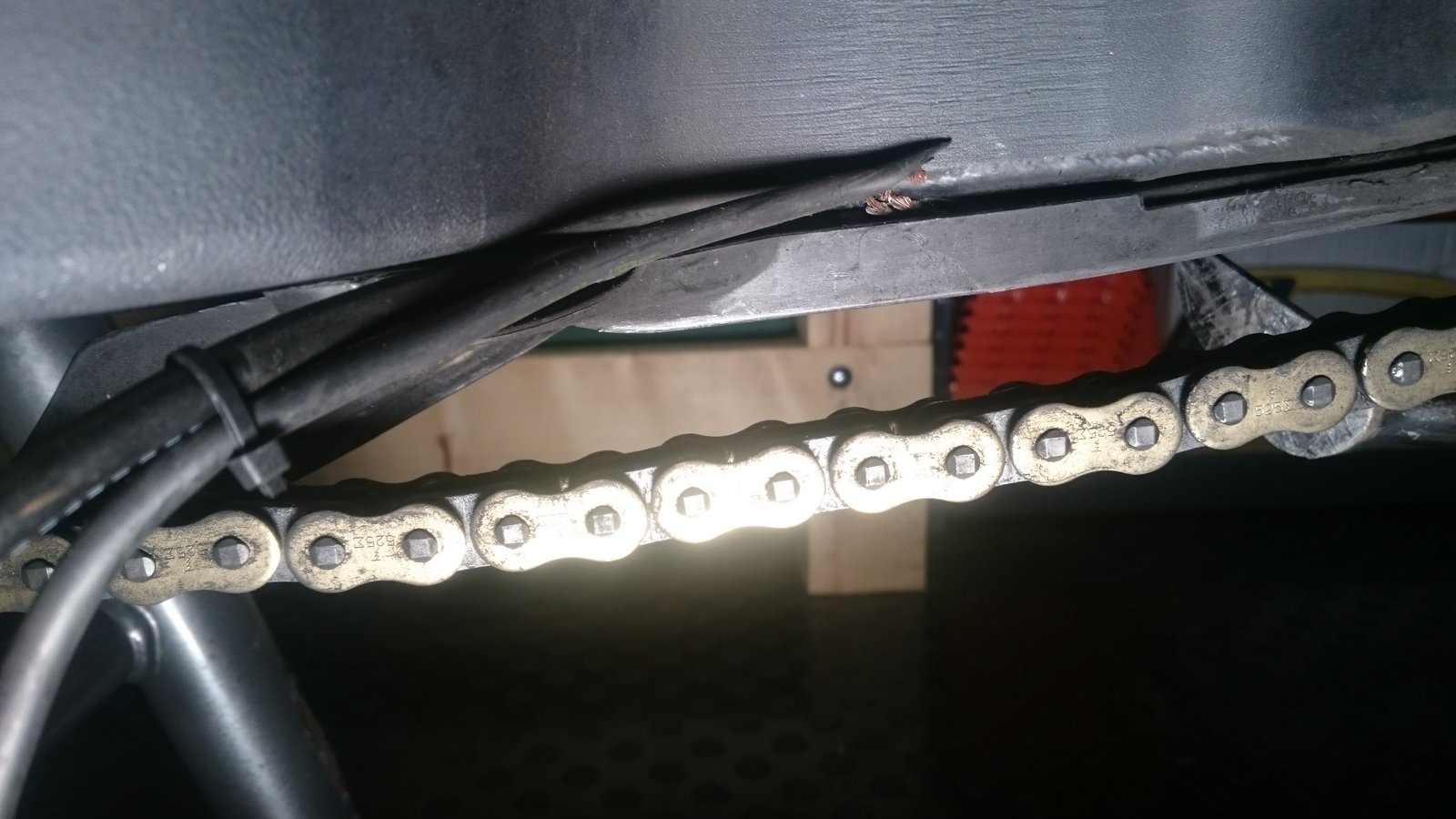

    Anyway, whilst removing the old one, noticed this below.
    I reckon that could explain all my woes...could have just repaired the wires! Oh well, I will repair it and have it as a spare.
    Not tested the speedo yet as waiting to get my fork brackets made.

  13. Poor obs Richard
    Would have thought the eagle eyed perfectionist that you are would have spotted that.
    You're cracking up mate!

  15. In my squirming defence....the damaged wire portion is not visible with the wheel installed.

  16. The routing of those wires is pretty shit tbh. They're a right bastard to re-locate and easy to pinch.
    Hopefully this is the source of your woes...:upyeah:
  17. Thats the first thing we'd all have looked at. Ricky, the shame.
  18. high commendation for posting pic and 'fessing R.
