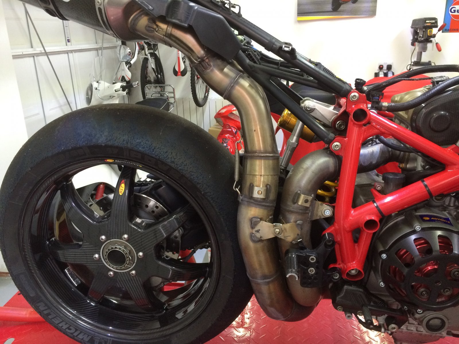

  4. You were right in polishing the pipes. Looks miles better with them done.

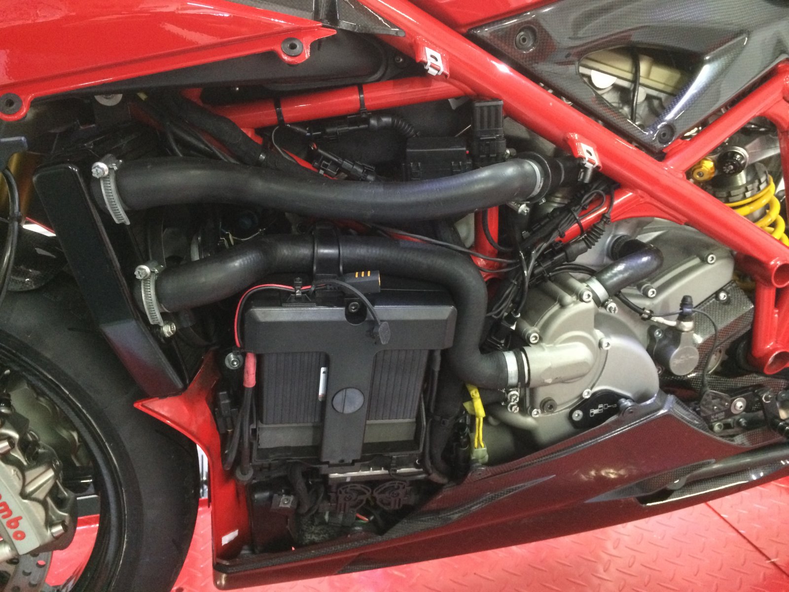

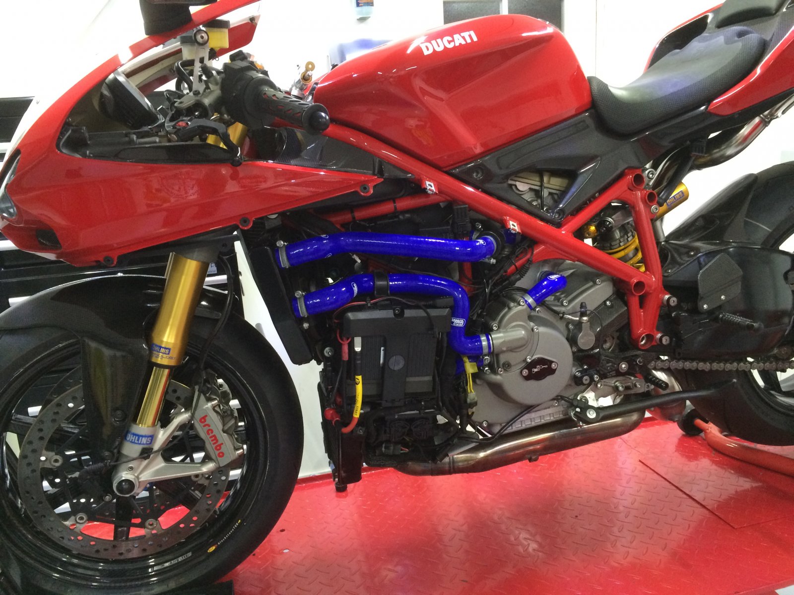

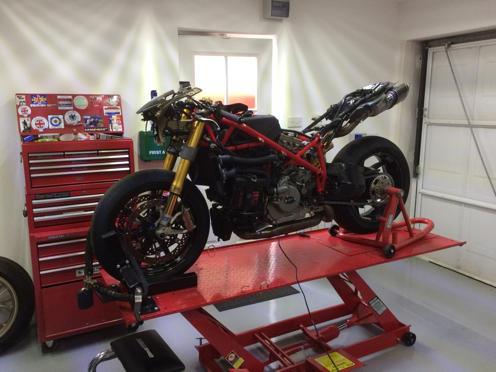

    Not much happening, but it's had a new sprag clutch over the last couple of months. Also fitted a Superpole seat.

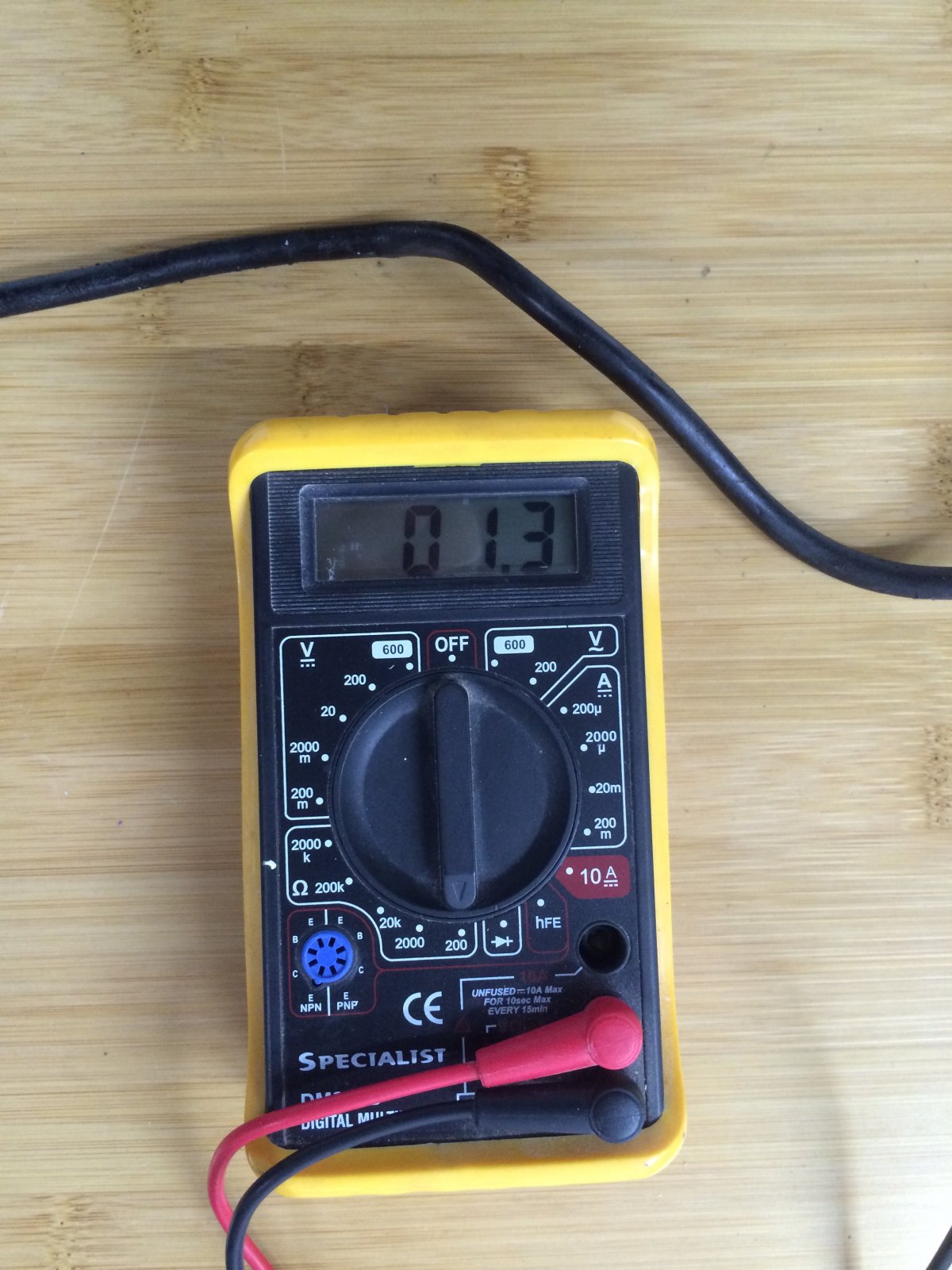

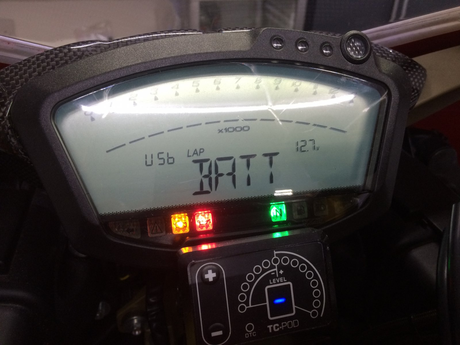

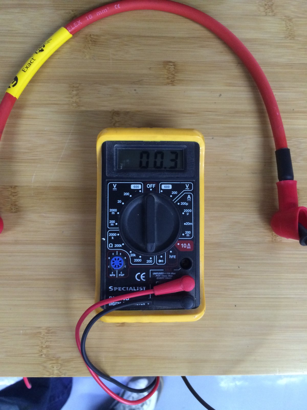

    Fitted Samco hoses and an @Exige Exact Start lead set today. As you can see, the new starter lead has a lot less resistance than my old lead, it's also a lot more substantial. Dash battery reading was 12.3v before fitting the kit, it's now showing 12.7v :upyeah: This is with my out of the box lithiium battery that I haven't charged yet, showing 12.9v with my multimeter.
    I'll fill her with coolant tomorrow and see how the cranking over goes. :)

  11. Looking good. I see the Exact start leads are 16mm square. Are they the same size as the old ones with a superior grade copper? They look about the same size. Call me a bore but I often focus on small and interesting (to me) detail.
    I'm in the middle of upgrading my 1098R. It looks like its just had a direct hit with an RPG at the moment but I'll finish the overhaul by March and post pictures when its all priddy again... Cheers, Paul.
  12. By size, do you mean bore or length?
    @Exige is the man to speak to Paul.
  13. You can read about the specifications here on the below link or at www.exact-start.com Give me a shout if you have any questions :)
    http://ducatiforum.co.uk/threads/999-749-exact-start-electric-cable-kits.34560/

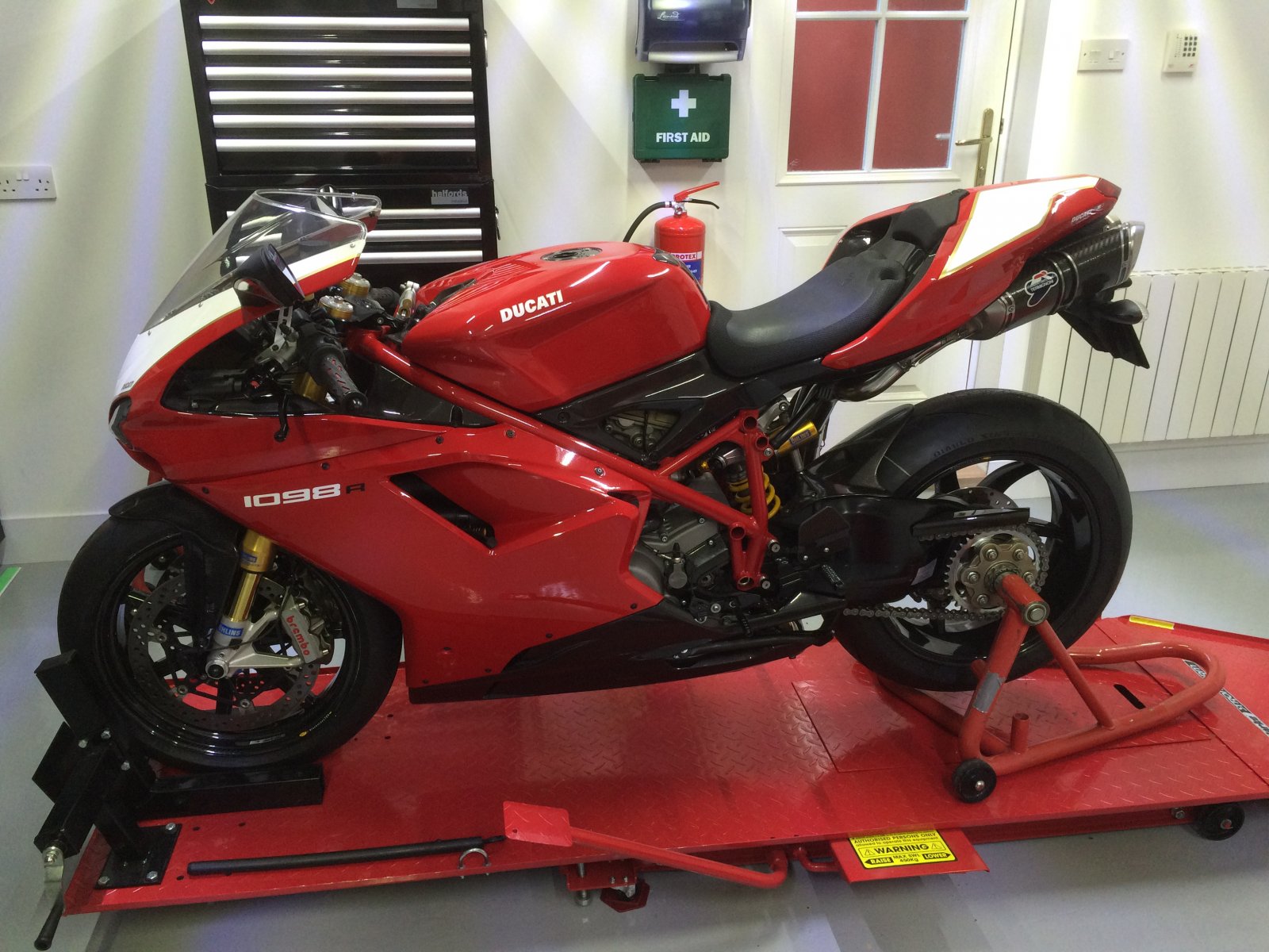

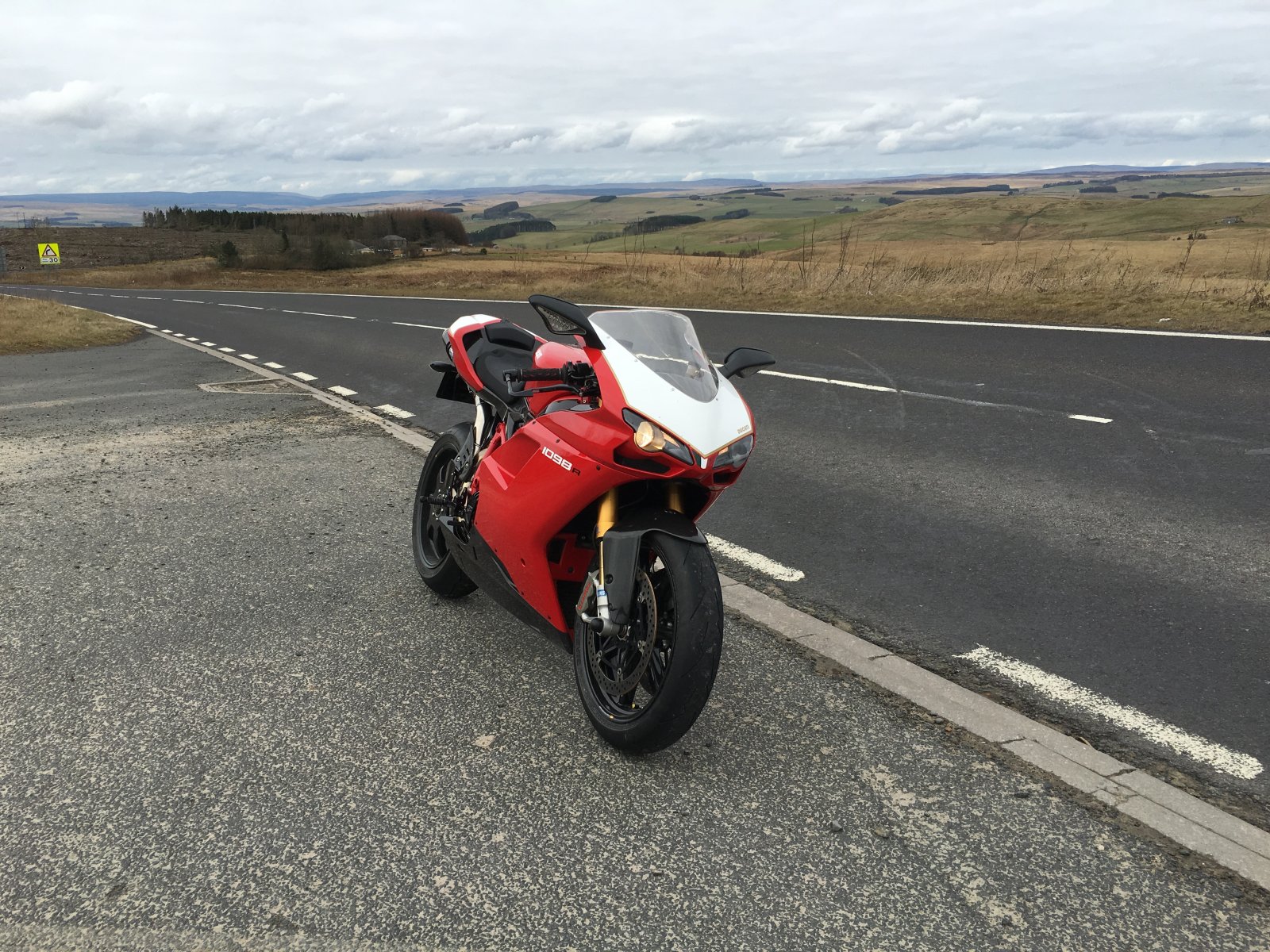

  14. Well, I finally got the chance to have a good ride out today. Took it up through Northumberland into the borders.
    Until now, the Streetfighter was my favourite bike, it may have just been surpassed. In a word, the 1098R is sublime.
    The power is immense, it just wants to lift in the 1st 4 gears. The NOVA gearbox and quick shifter are a match made in heaven. The Ohlins 30mm cartridge upgrade feels super planted on the road. I think the bike is a keeper. :D
