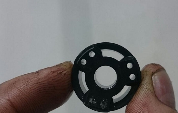

  13. Got my forks serviced here in Dublin yesterday by NDM - NDM - North Dublin Motorcycles - fairly clued in outfit, they do a lot of road race and track bike set up, plus they're fully qualified Ohlins techs.
    My forks only started weeping this yr, not too bad but from last month or so they were pretty much almost out of oil.
    My forks had never been touched due to previous two owners pussying about on it and v low mls before i bought it. Its only got 7.5k kms on it now. I only have it just over a yr now.
    One of the inner plastic rings that has holes in it ( i know, what a desc - see pic below ) was fuked. It had a build up of bakelite in one fork. In the other fork, one of the inner cartridges was sticking. I thought i was in for big expense, but escaped it. Steering never felt bad bad, even on track, but it always felt like steering was a little heaver than it should be. I couldnt put my finger on it.
    So after a clean, new oil, seals etc,the difference is unreal for the better !
    SO my advice, get them serviced, its a bit of a small expense but the rewards more than justify :cool:
    ( all i gotta do is get slightly lighter springs over the stiff stock ones. )
