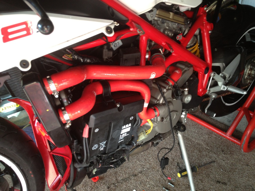

  6. Fitted the Samco hoses and Surflex clutch pack :)
  7. What are the hoses like to fit? Do they go in quite easily? Been thinking about doing this one myself.
    matt
  8. The hoses are easier than the fireblade I had :)
    You can do it by removing the side panels (both sides) and un shipping the battery holder then access is easy.
    The pain was simply taking the radiator cap off to top the system up as it only just has enough clearance above with the air intake in place (but it does come off)
    Took me 1.5 to 2 hours kit DUC-12 was £170 with new Samco clips from avanti race spares and I used just under 2 litres of castrol pre mixed at £5.50 a litre, hope this helps :)
    If you need more pics let me know and I will try and get them before it all goes back together :)

  14. I think the front calipers use stretch bolts, so it may be worth investing in some new ones if you're going to pull the calipers off. On a sep note, my Samco hoses are sat in the box waiting to go on, which should keep my busy for an afternoon :upyeah:

    Will be good to get the hoses on mate, you will like me realise how perished the OE pipes are after 5 years !
