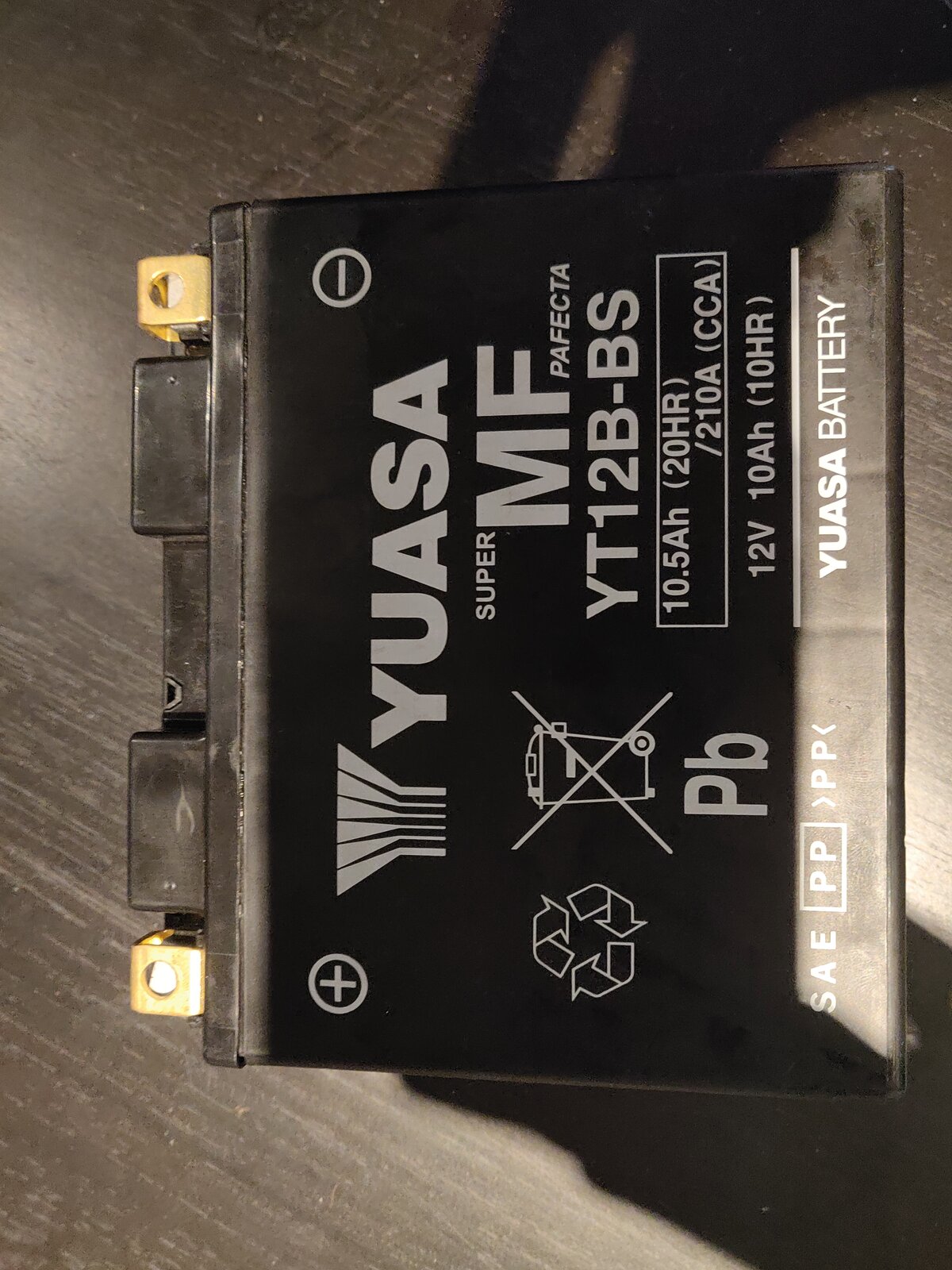

  14. This is the battery i bought, it is below 12.4v so i will charge it (multi meter averages around 11.5v so thats likely the issue).
    Thanks for the ideas of a solar panel or having another spare battery to swap out, will look into that for sure!
  15. Ducati upgraded the battery on the 1198S SP and R from 12 to a 14 code - you can also get a high cranking amp Yuasa now too.
  16. Would you recommend i bite the bullet and just get that instead? As long as it fits
  17. If you charge that battery fully you should have no problems, above 12.7 volts will be good. The problem you have is keeping it charged and that would be the same with a bigger battery. Either trickle charge with solar or take it off every 2 - 3 weeks and recharge
  18. Yes YTX14-BS (you just remove the packing pieces in the battery box as Ducati did in the later models) but I can't remember the high cranking amp version someone mentioned. Without decent cables though you will still have a weak link in the starter circuit.
