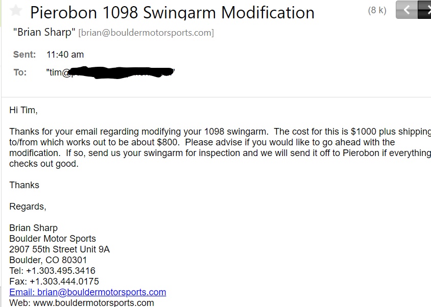

  2. Here is the response from my access to Pierbon. I am in the wrong business.

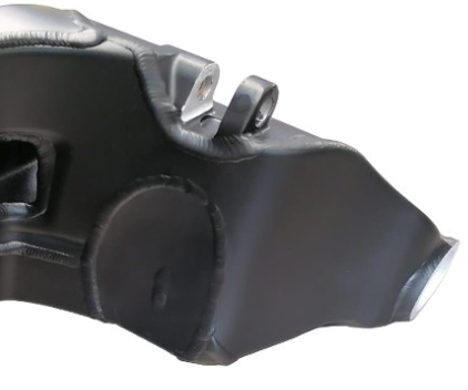

  3. Pictures of recently modified swingarm for my own bike that soon will be converted into a race bike.
    Swingarm modified by Bill Simpson Racing Scotland.

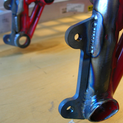

  5. Without starting a new thread has anyone access to these weld on perch replacements?
  6. Speedymoto used to make them but I don't think they do anymore.
  7. I have a company cutting me 20 pair with 2 holes. They use waterjet to cut so edge will be real smooth.

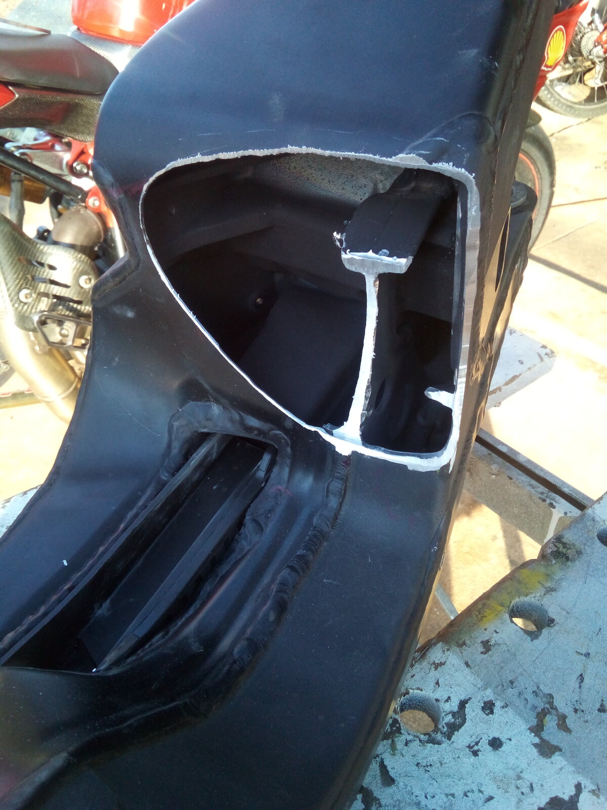

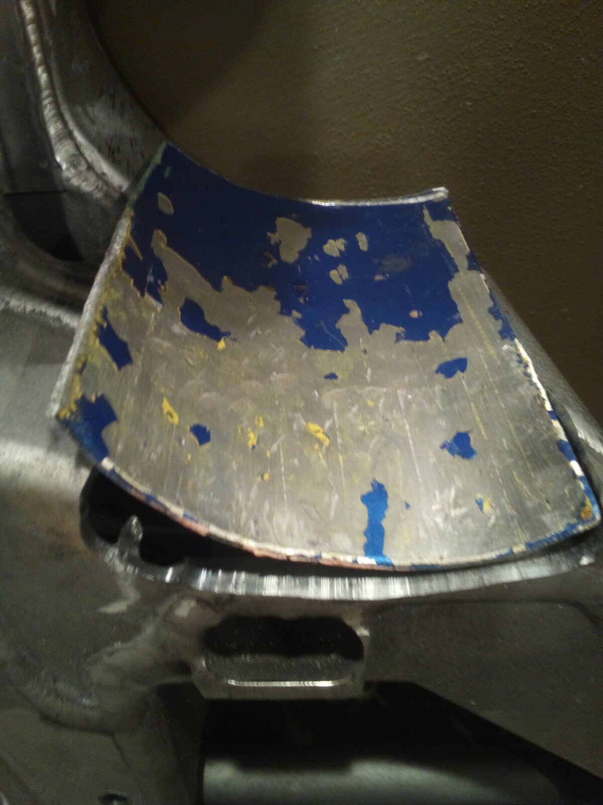

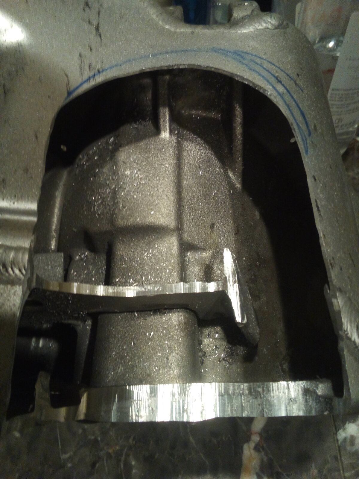

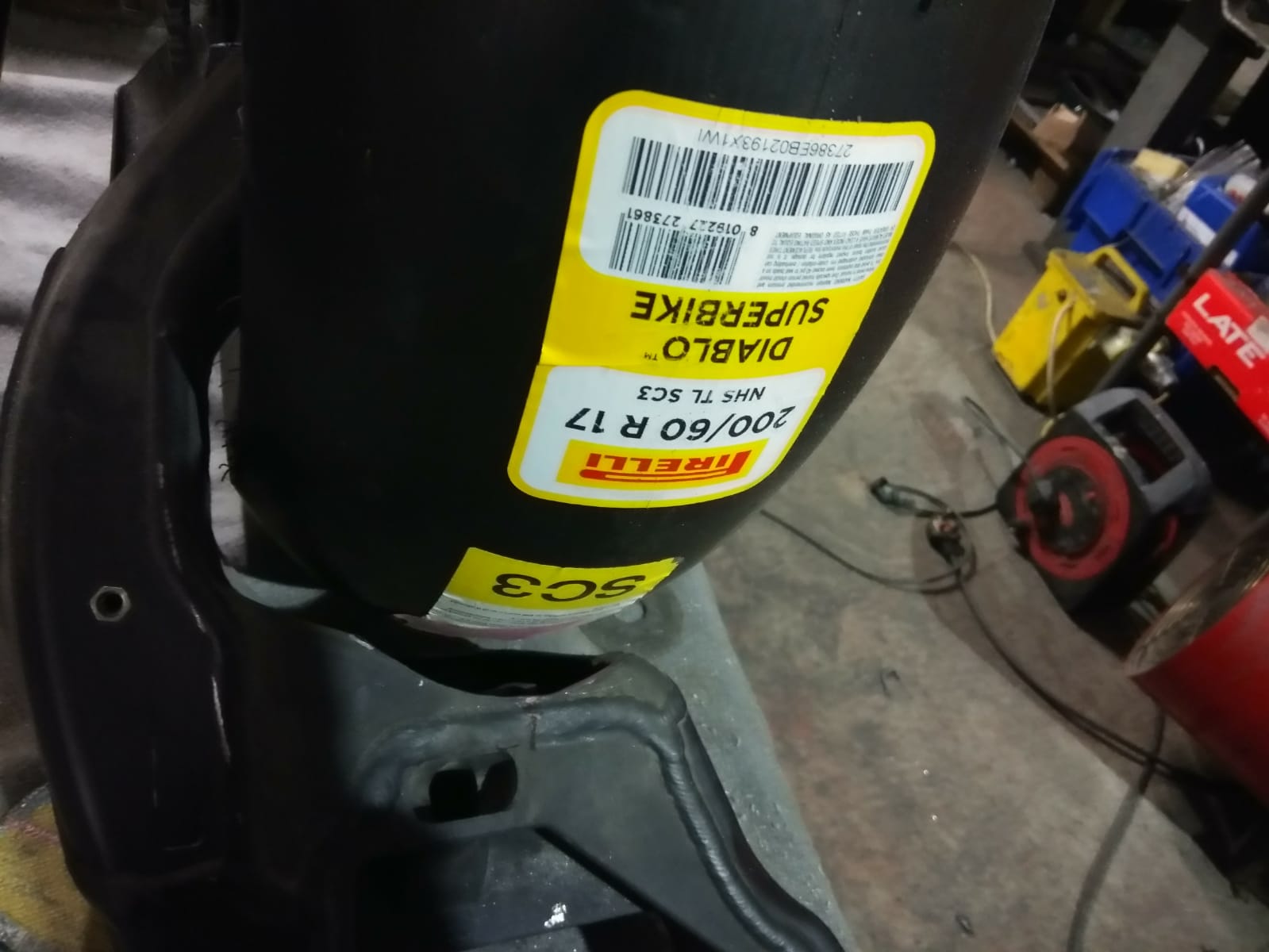

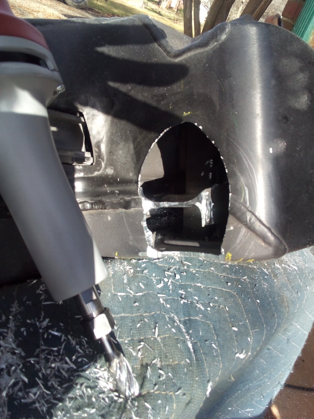

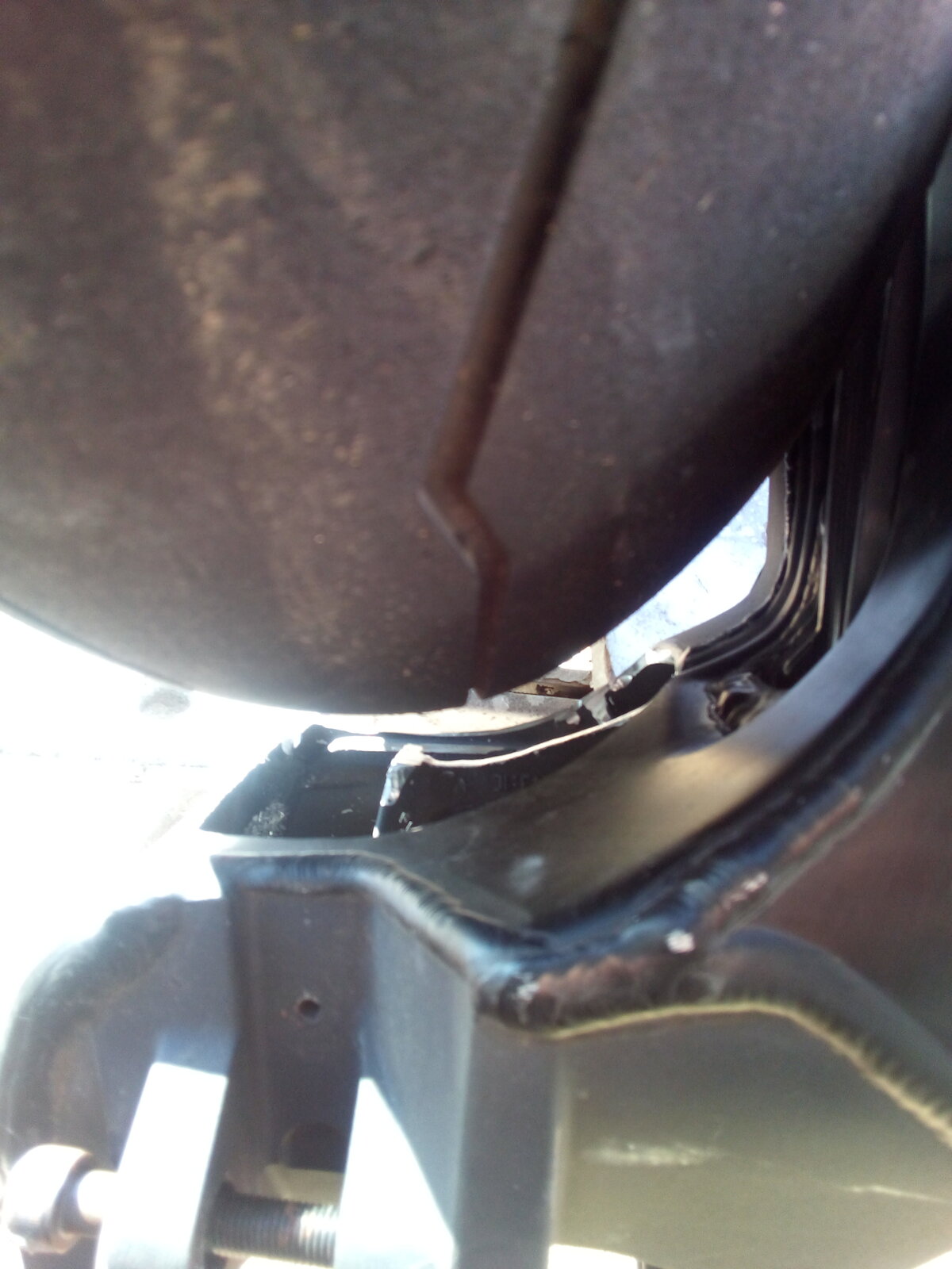

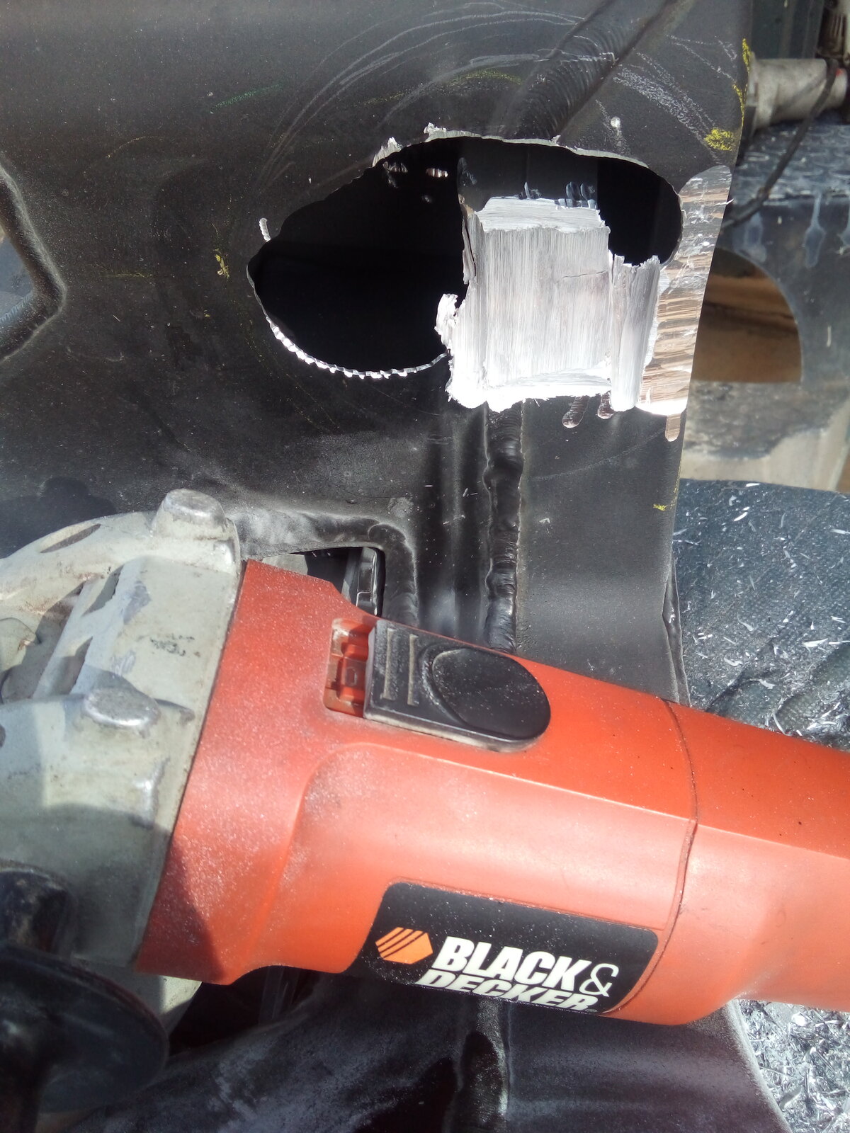

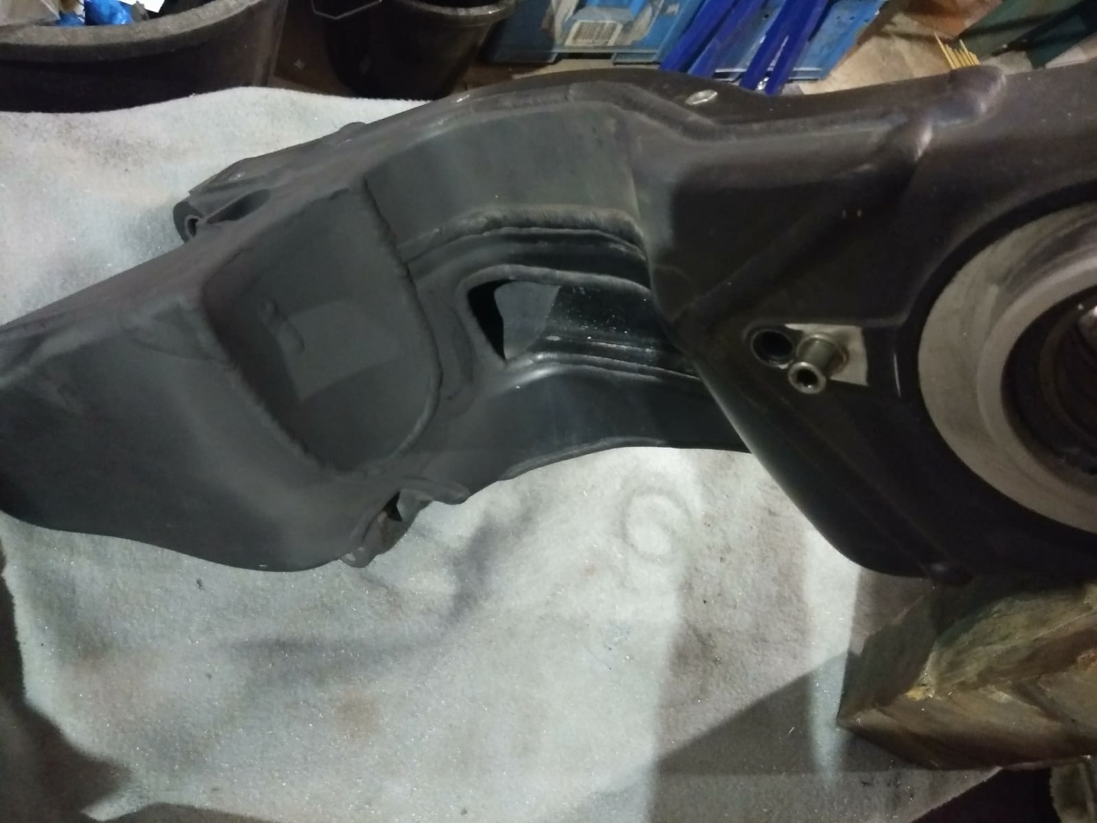

  8. Back to the cutting and chopping. I opened up the Donor arm wider than I needed to in order to see inside and measure. I have also used a this piece of aluminum to get an idea of the radius and taper back to the top.

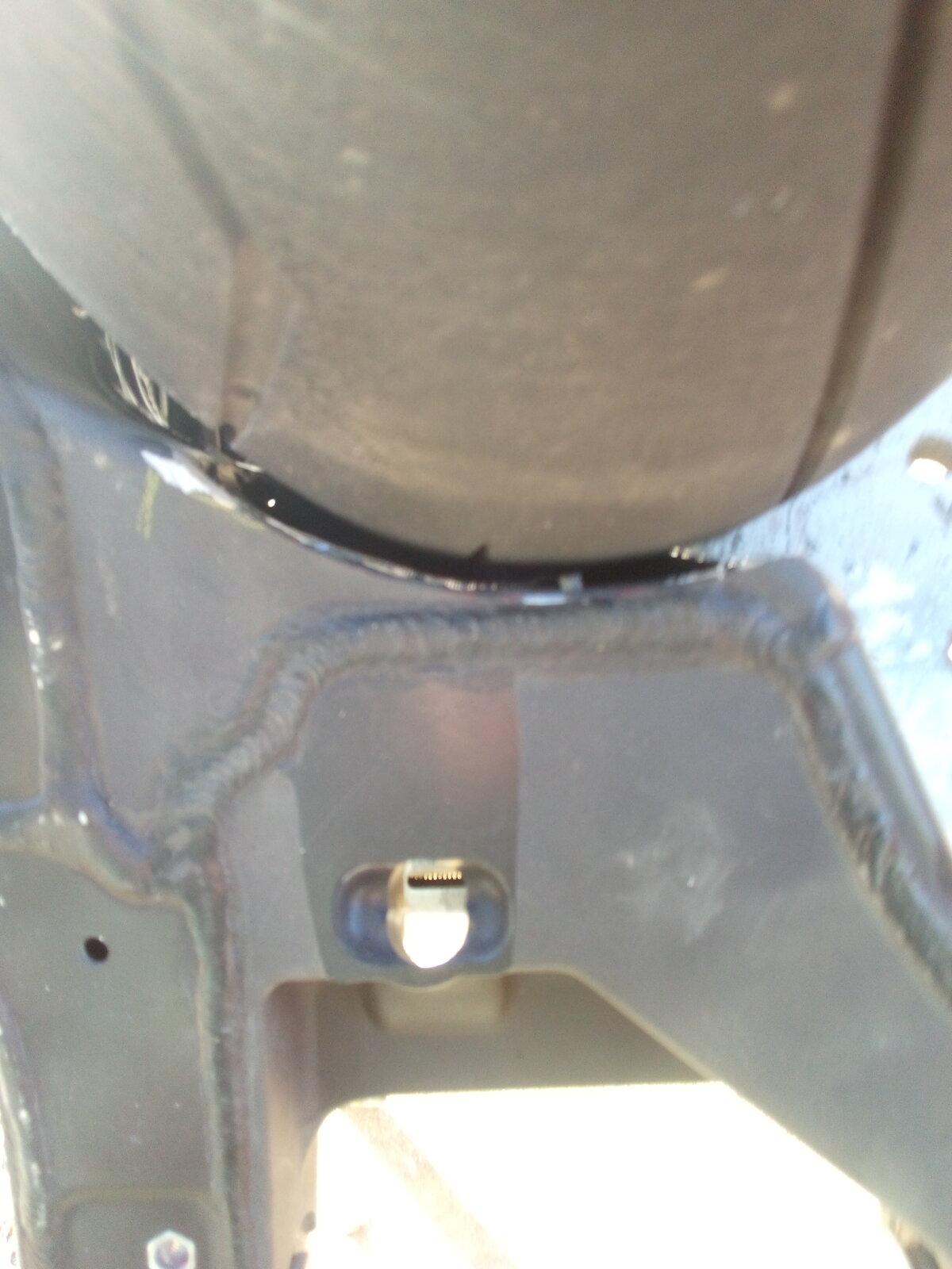

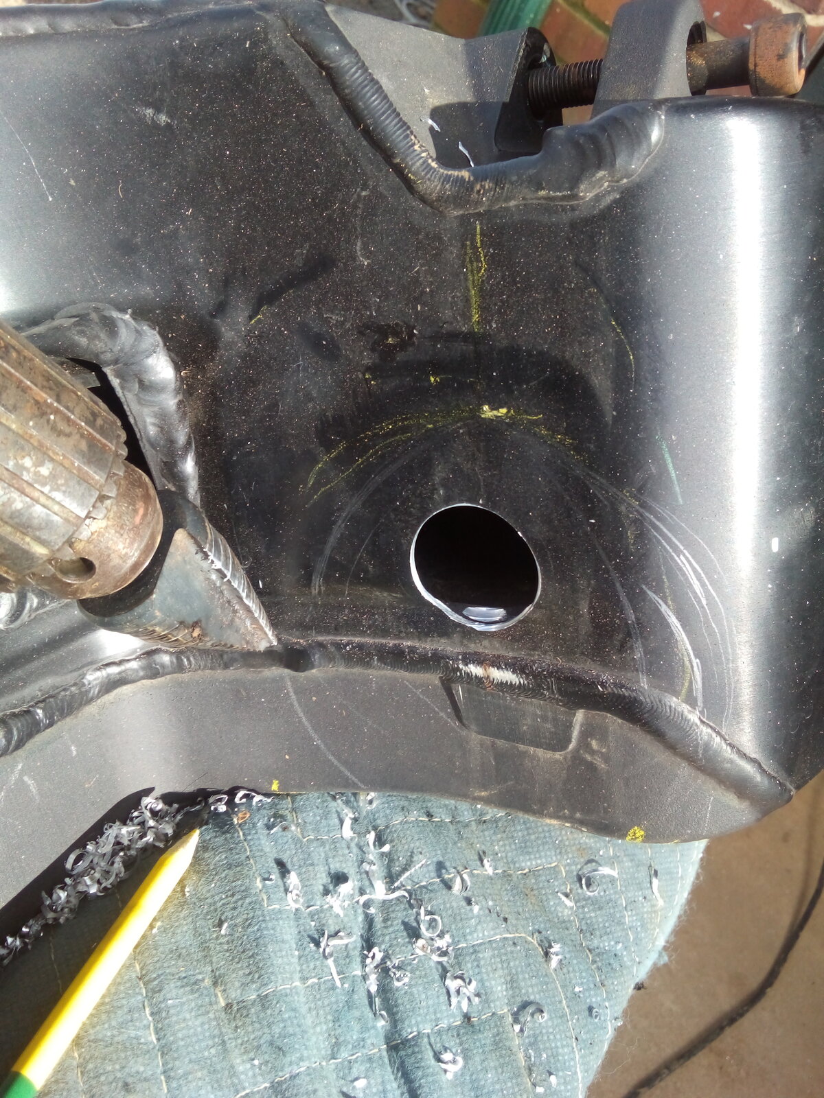

  9. Ok trough with experimenting. Here are the final cuts and fitting of the SF swingarm It can be adjusted from 510mm to 540. With the 200/60 or the 200/65 the hole got real big. But it clears warmers no matter how it's adjusted.
  10. Fair shout to all of the effort your making to try and get the final result. Looking at the picture that does look really close especially if your want to play around with tyre pressures and taking into consideration when the tyre warms up. Good luck with all of the versions your trying.
  11. All the way forward and all the way back. The full forward will not be used. Call that :15 after the sweet spot is :20 to :40 in order to maintain rear ride height. However the 200/60 keeps it up there al-be-it with poor chain angle.
