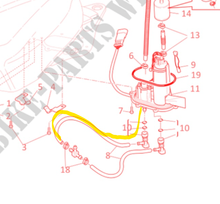

  1. as above, fit them whichever way round is more "in repose" or another approach if relevant - measure both hoses from the junction and if there is a slightly shorter one then route it to the junction that is furthest forward.
  2. It's pretty clear from the diagram....
    It's this one @SS427
    So the one on right of the bike as you sit on it. Plug em in, don't worry, be happy As the chaps have explained it makes no difference to the fuel flow if you mix em up.

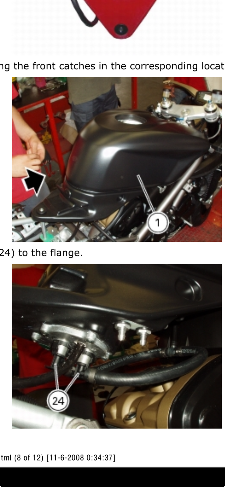

  3. I’ve just been through all this with my 848, which is the same for your 1098. Have a look at the screenshot I’ve attached from manual. upload_2024-5-6_10-7-16.png
  4. Morning Scott, massive thanks for your reply. I did wonder re the Right side fuel hose fitting onto the front tank outlet and this has confirmed it. Did you change the 4 little O ring seals ( Green on my bike ) on the connectors ? I noticed that one is badly damaged, but Ducati only sell a new connector, which comes with the 2 seals, it’s £15 pounds !
