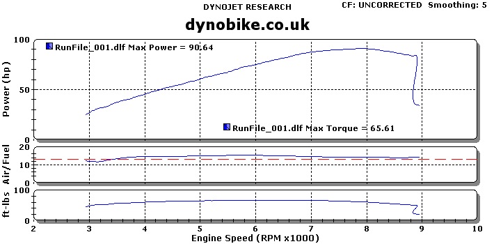

    It is quite frustrating, as it runs beautifully and the power delivery is nice, see dyno chart. But it still runs lean, so I worry about the pistons. Also cold starting is still a nightmare. The cables made a slight improvement in turning over but it still gives me 2 fingers on a very cold start. Chris suggested removing the lithium battery and checking my spark plugs are not iridium. It is frustrating as you get so close with just a straight swap but it is no cigar, I am afraid. The niggles are annoying enough to make the bike a pig to live with if not sorted.
    Steve at Redmax put the engine in but he does not have the dyno gear. So it is off to Chris at Bristol for some digital fairydust. On May 8th it should be all finished. By which point, the bike will have stood me to........£5075! 1100 evo dyno with 900 ecu.jpg

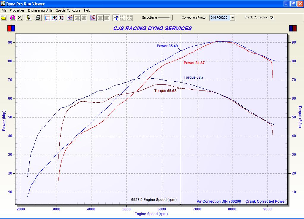

    The remap was interesting. We have an evo running on a 900 ECU, loom and injectors. And Chris was able to get more power than he was from a Monster. The manifolds on the Monster are shit apparently? Whatever, I am stunned that the project seems to have worked as hoped for. I was expecting a bit less power all round than a standard Monster to be fair. But to have more, and more linear, is a total bonus. I will upload the map with the monster and my bike when Chris gets it to me.
  17. Ok, here is the dyno, showing how sad Monsters are against the mighty SS!
