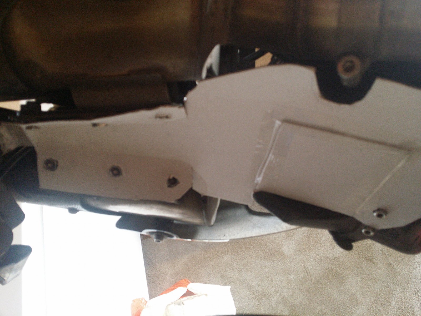

  4. The only pic I've got to hand is the cardboard mockup. . . . But that's it in stainless. . .
  5. I had to get 10 made so I stuck the remainder on ebay. Some of the lads on here had them but I mostly had people telling me how they made their own out of cut up milk cartons. But tbh with that mentality I could make my side panels out of bread bags and sticky tape. . ! The point was it was a bespoke made bit of kit in stainless so therefore good quality. !
  6. Looks good - cheeky question, does it work?
  7. Yeah. Worked brilliantly. As you know when you get caught in the wet it all goes up under the seat... Not with that...

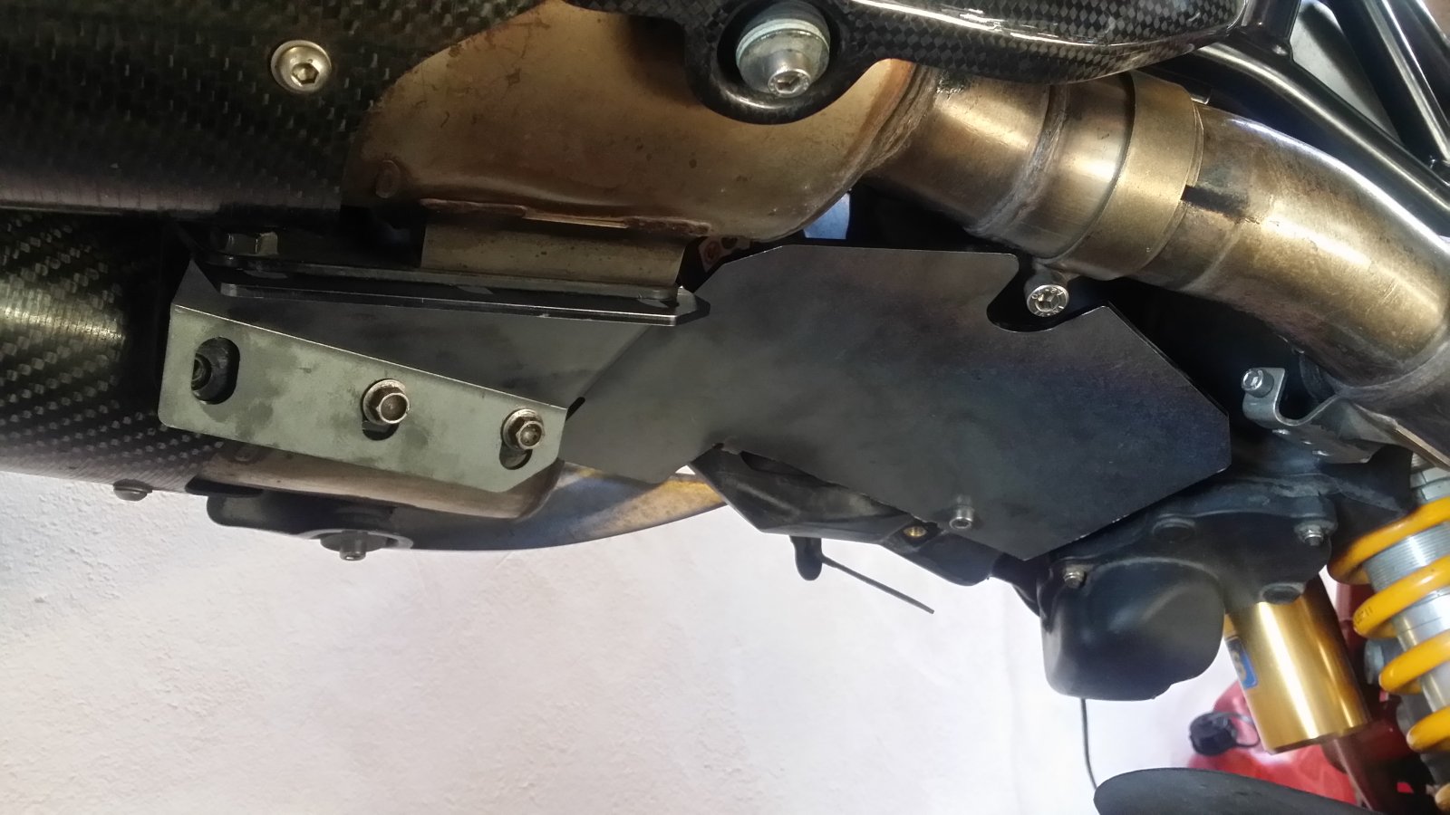

  12. I literally divided the cost of them up including the time i had to pay for the mock ups which ended up about 45 quid from recollection....found a shot of the fitted stainless unit...i think also it wasnt a particularly blingy bit of equipment (ie it was functional and served a purpose) so people didnt want them....ive still got some left of those...one of the lads on here actually bought one from me last month and he thought it was really good....he had my last tail tidy also.

  14. Oh - aluminium corrodes, eventually - also the fabricator didnt want to use aluminium just incase something got flicked up from the wheel that was heavy....he was trying to allow for stuff that he couldnt allow for. I must confess i would have rather used thinner stainless - these were 3mm but, it was better to be on the safer side. No matter what the stainless got covered in, it always cleaned up nicely. Goes back to cost again...aly is cheap, i wasnt trying to do it on the cheap but fall on the side of quality and durability.
    The other thing is vibration. I had a test tail tidy made from aly and within a week it snapped due to the hyper being a big twin....

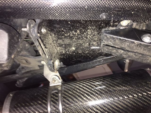

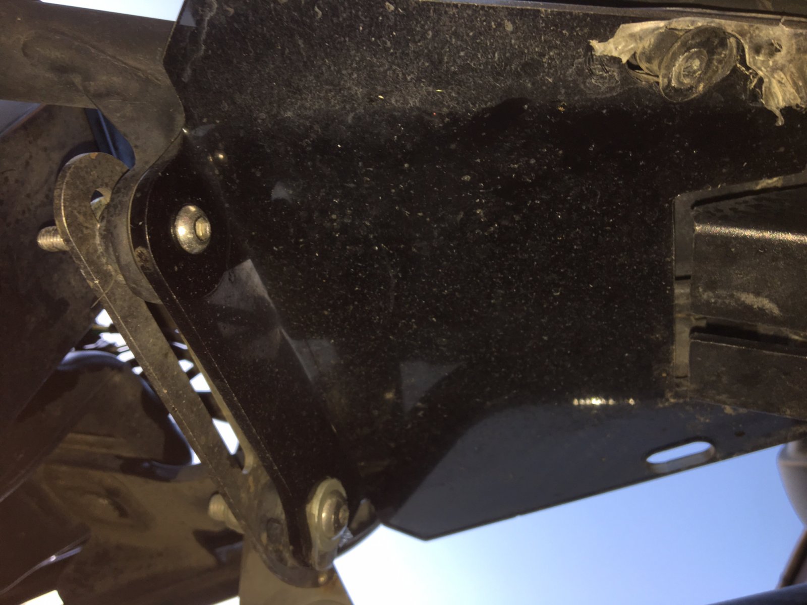

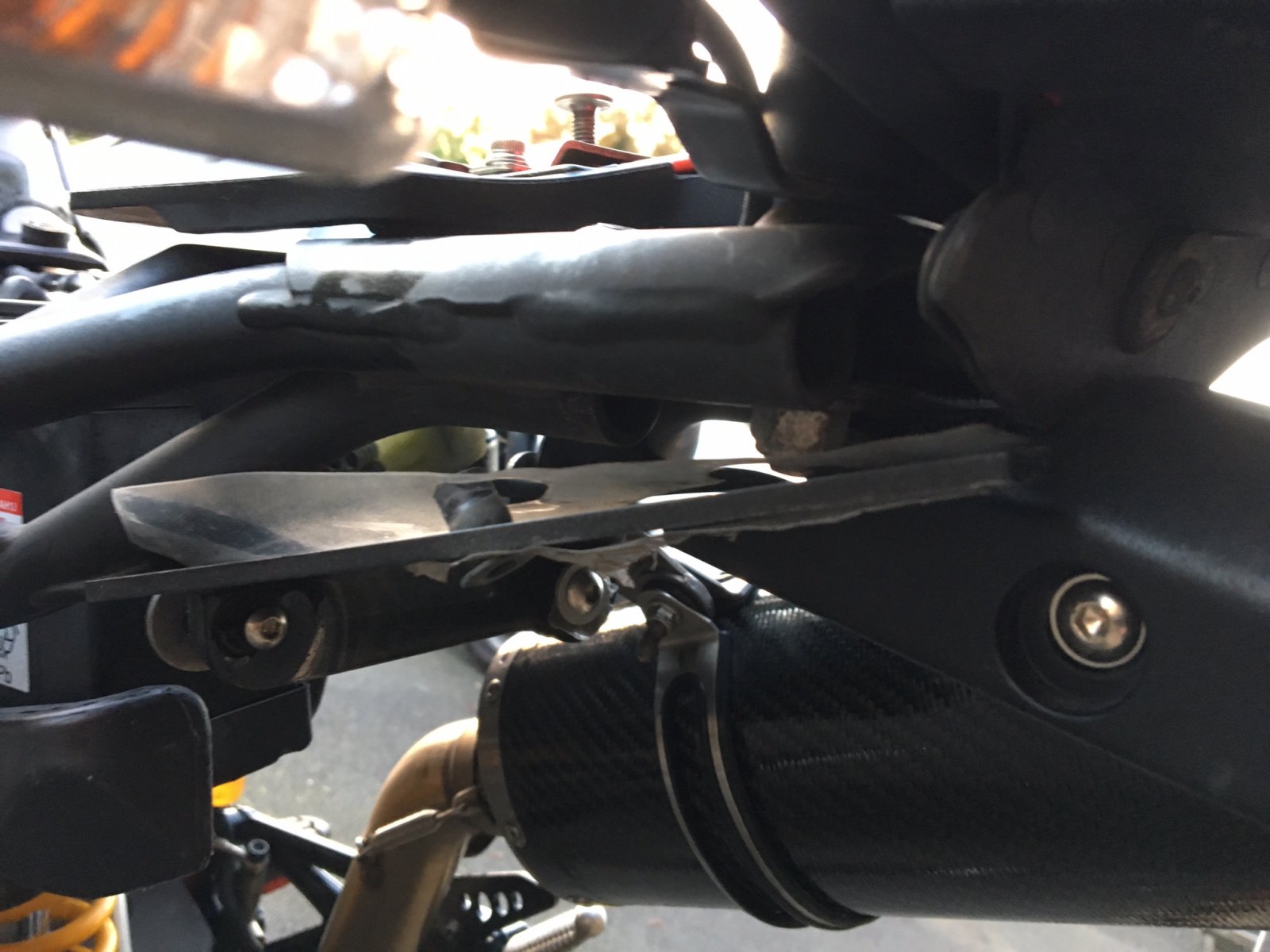

    Some hopefully better pics of my underside. Last one shows the gap to left of exhaust hanger is where all the crud gets in. I have a nice black smoked perspex thingy/plate (muddy) which goes around the tail hanger - i will take off the OEM hanger to see what is there. Mudguard wise its a smaller bit i need to cover the gap forward of exhaust hanger. Will get there eventually!
