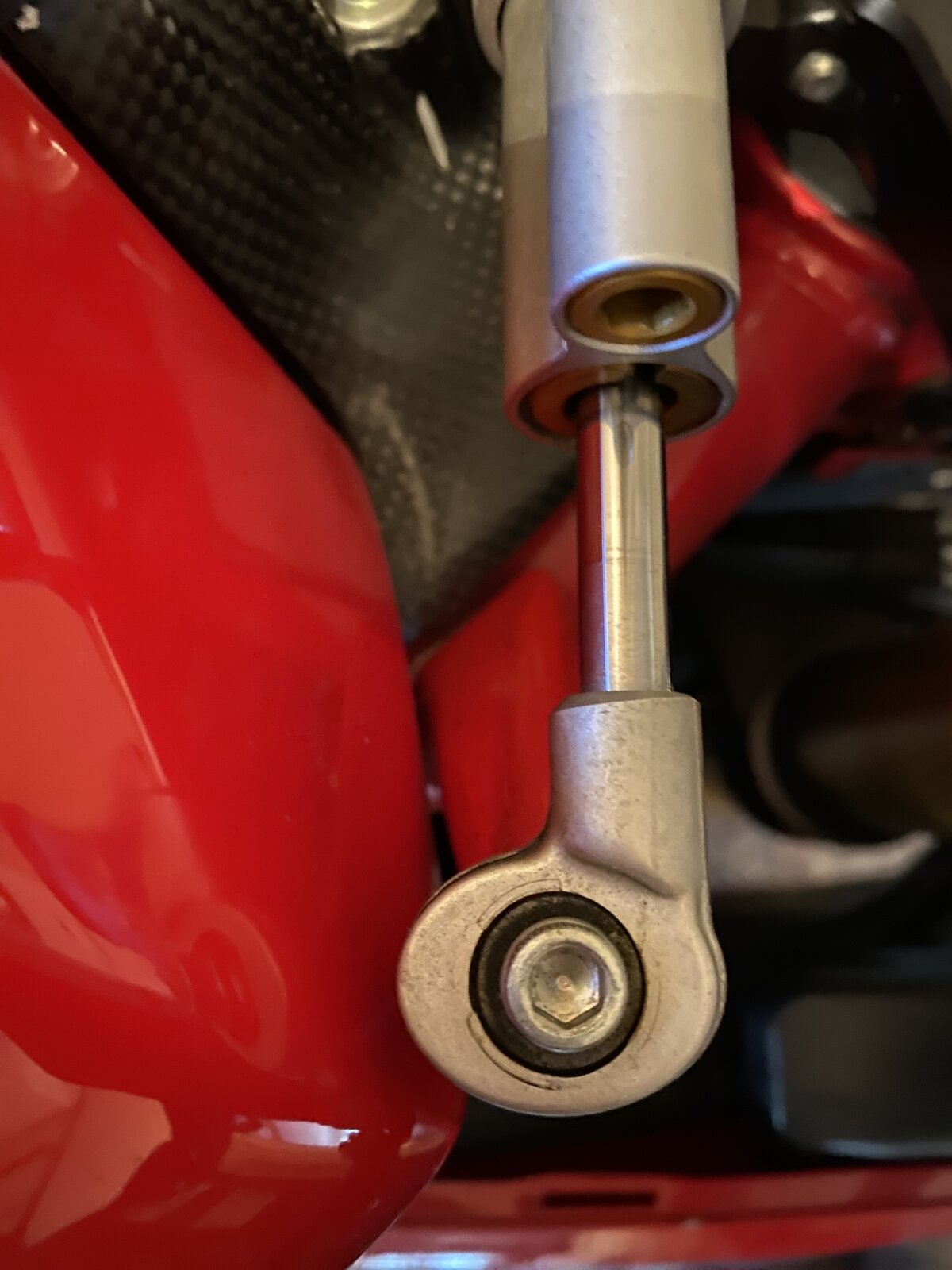

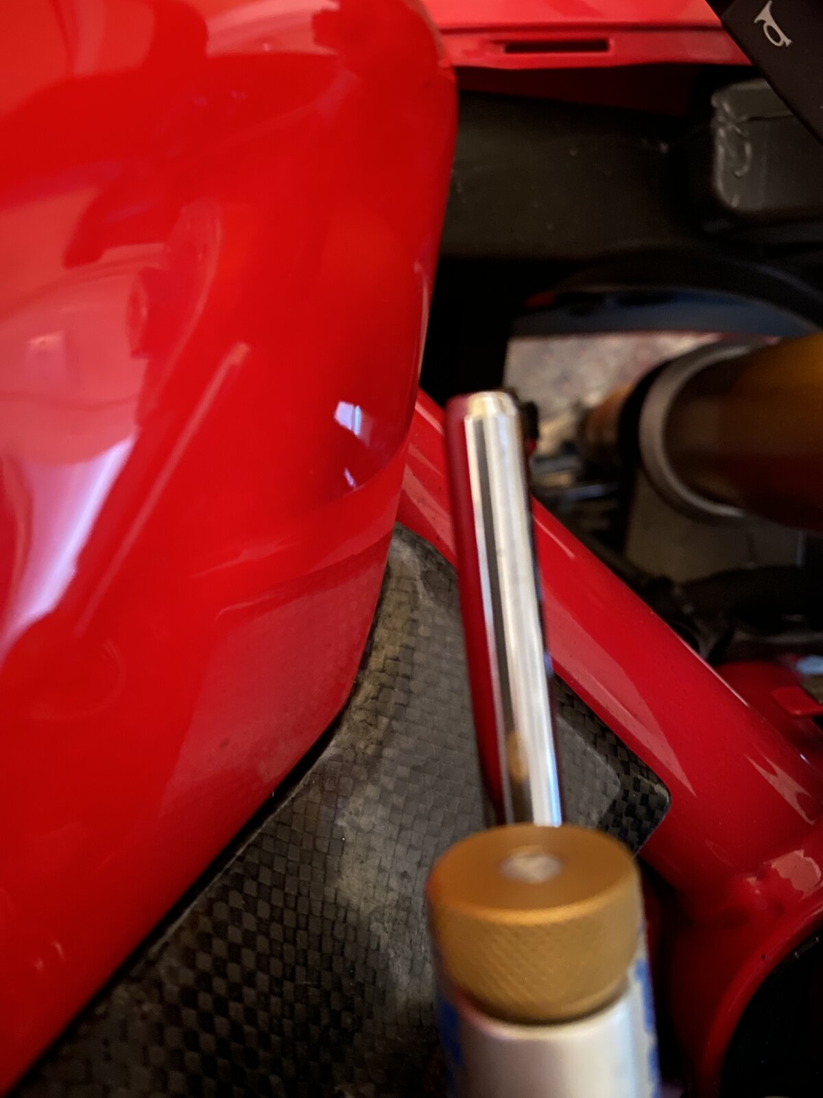

  5. @Ivor
    it's pointless trying to do an overall length, I would have to take it off like you, but clearance at the fixed pivot end is about 5 1/4 mm and clearance at the moving rod in the worst position is about 10 1/2 mm.
    also bearing in mind, that mine won't be perfect and has probably grown a little bit.
