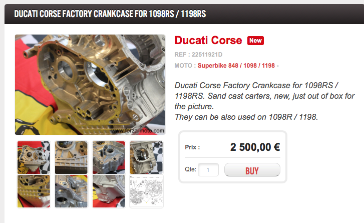

  5. Good find. If I were OP I'd buy that. If it's available that is. What's the date stamp? They ain't for free though eh?
  6. I was told they were rare as.... If that's true then that should be snapped up sharpish!
  7. Quite right Mary/Rik, a bargain, just did a recce and a crankcase pair for 1198R (22521891C) is on average around 4.5K - found 1 pair at 3.8.

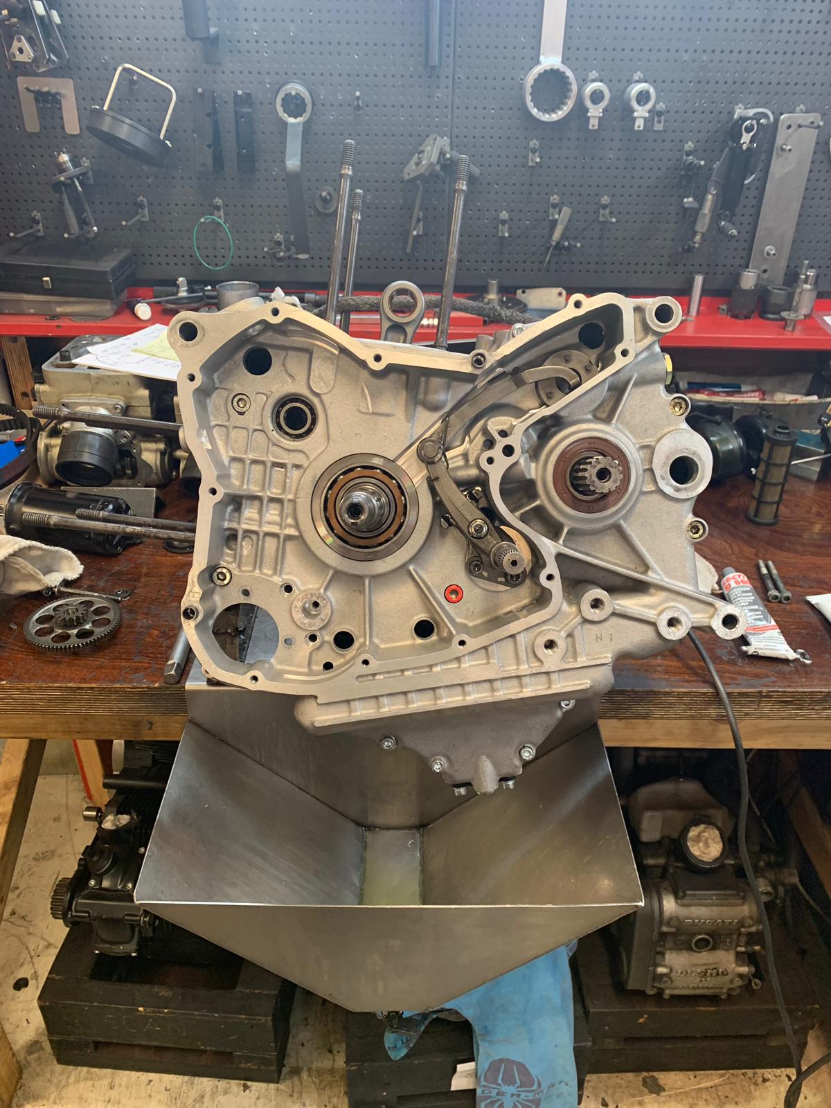

  8. Just a small update from my side, on this moment the sand carter/ crank case and 1198R crankshaft Will be installed in my 1198 engine:cool::cool:
  9. did you get the crank rods pistons balanced...what pistons are you using?
  10. and who is building it?
  11. and by the look of it you kept the std gearbox.....

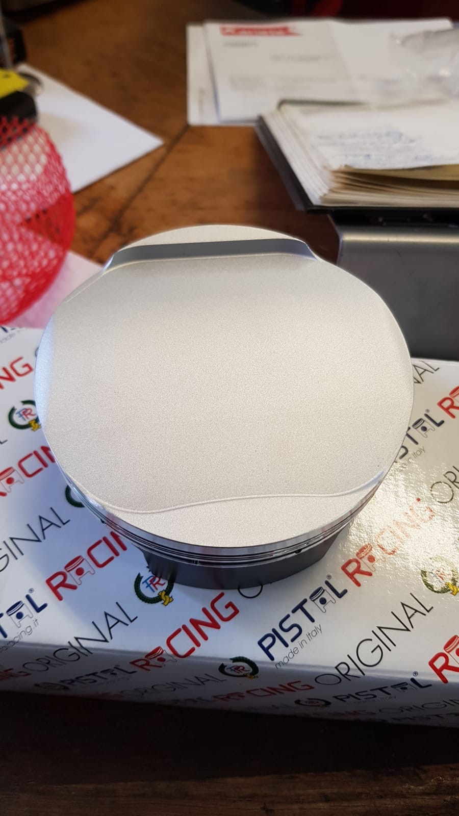

  12. Yes they are balanced. Pistons are:
  13. Biggelaar performance
