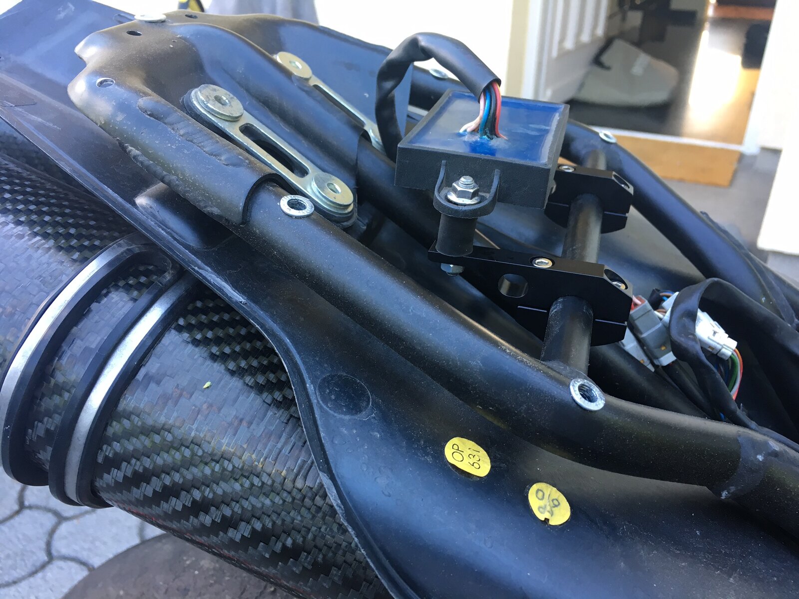

  12. I’m convinced that the conflicting opinions of the 1098R DTC are because in some cases the unit has been fitted upside down. Mine was upside down and it took months of trial and error and research to solve it.
    The correct way is to have the cables coming out of the top. It looks untidy but it worked very well after being corrected.

  14. Must be perfectly level too.
  15. Oh, I reckon mine may be upside down. Must check....although I never use the TC as it’s always been rubbish.

    And im not so sure about level..... on the full nemesis there is an angle you set it up to in the settings which obviously moves about when you blow tyres up get on the bike adjust the ride height etc etc this is a critical setting as said angle tricks the system on too much or too little interference. hence one bikes 3 is another bikes 7..:punch:
  17. If it's upside down that will be the reason why it's rubbish.
  18. Interesting photograph, my traction control unit is mounted to a bracket that uses the two silver bits of metal behind where your’s is mounted. Andy
  19. The previous owner had it upside down on a custom made sheet of aluminum. I bought those mounting brackets so it could be set level and the correct way up.
    After I sorted the DTC it was quicker than Panigales round the Hungaroring.
