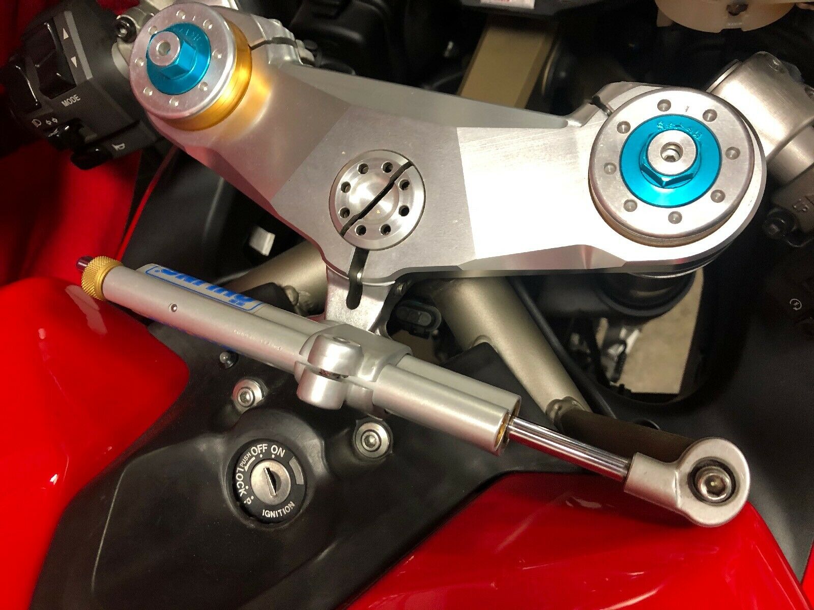

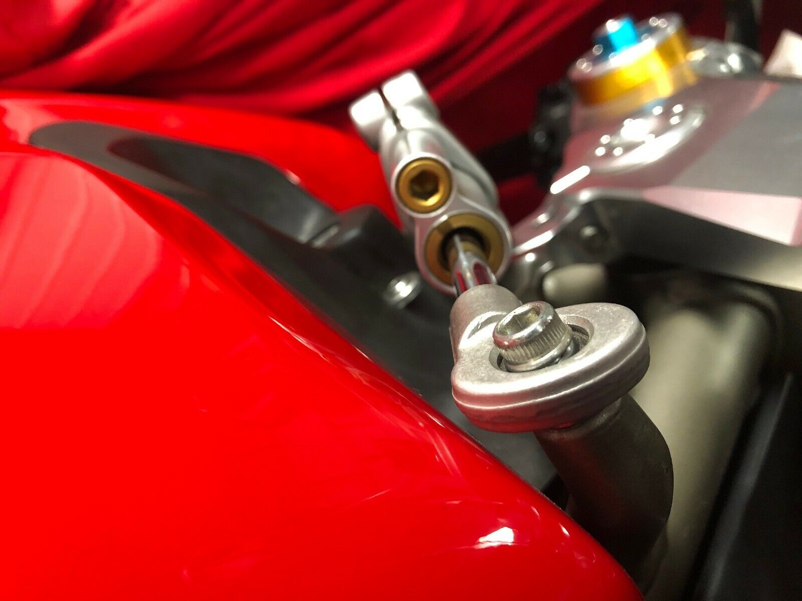

  16. Not ideal, but I'd be tempted to give the rose joint a kiss with the sanding disc.
  17. Why? :thinkingface:
  18. For a bit more clearance on the tank side.
