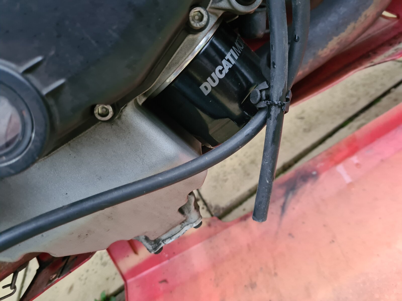

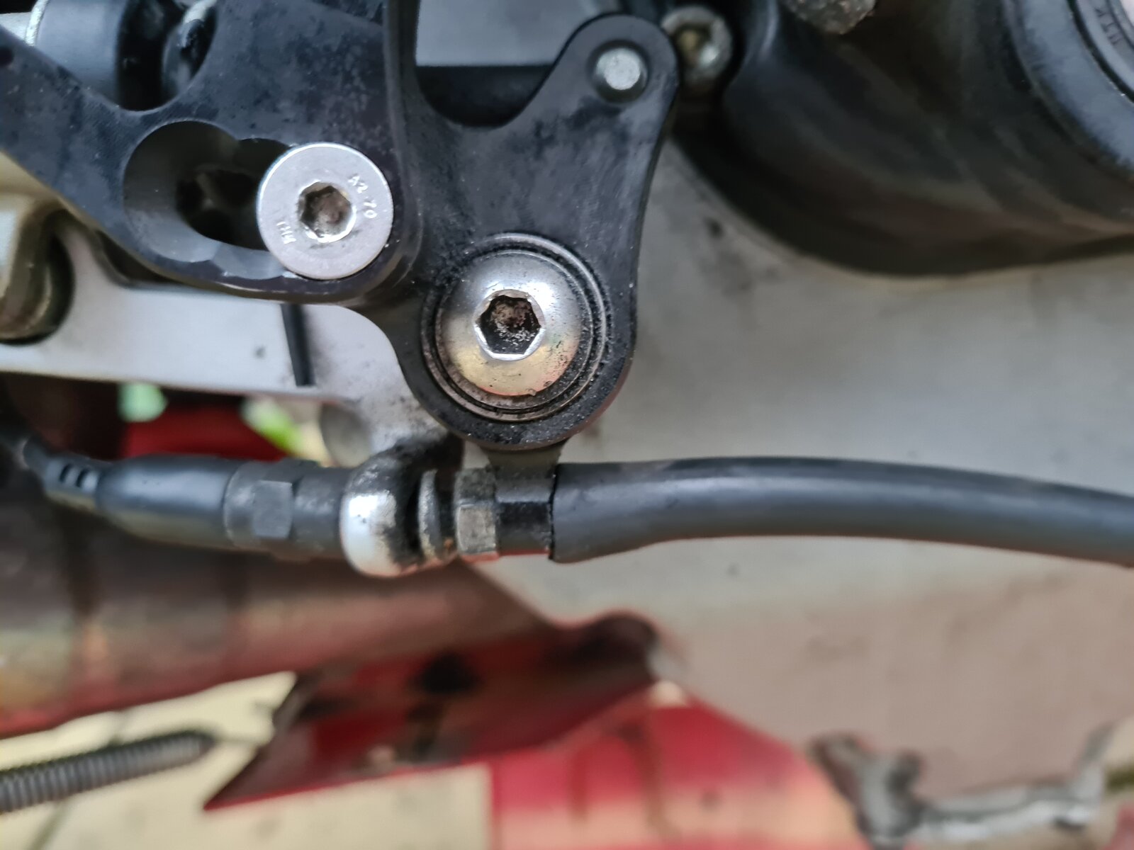

  10. Took off the fairing on the left side. The fuel hose above was disconnected, possibly In transit. Is there something you use to keep it tight? Does the small hose that is free connect anywhere or is it for overflow?
    Anyway. The Amber light for engine error came on. Needs a service anyway, but I'm assuming you need a diagnostic kit to say what the issue is?
    But at least the red light goes off when cranked, but the engine just won't fire. Guessing it's a fuelling issue since the fuel line came loose?
