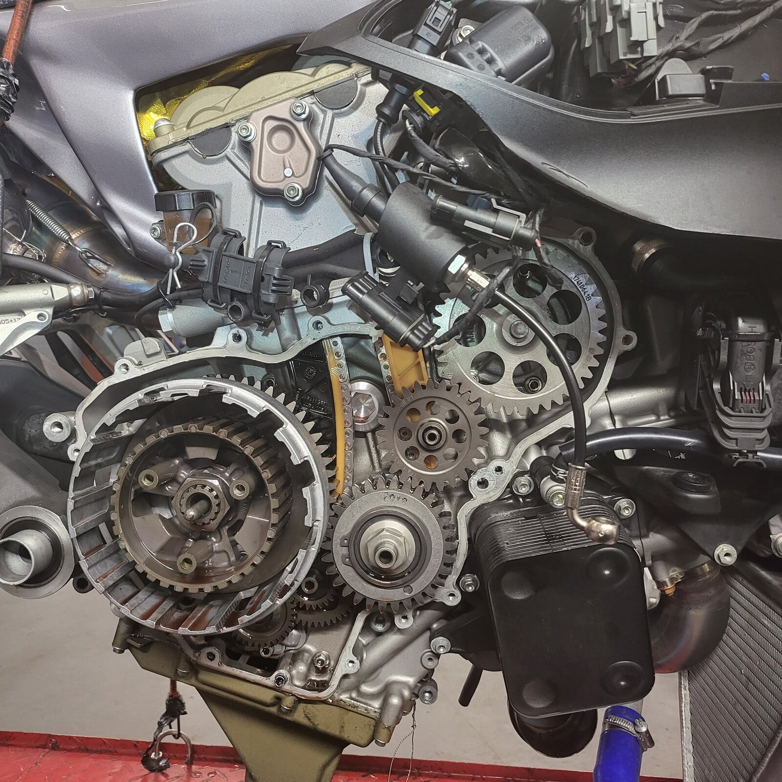

  1. I believe they are. But I wouldn’t worry. If you study the numbers your odds against disaster are still pretty good. Thrash away ;):upyeah:

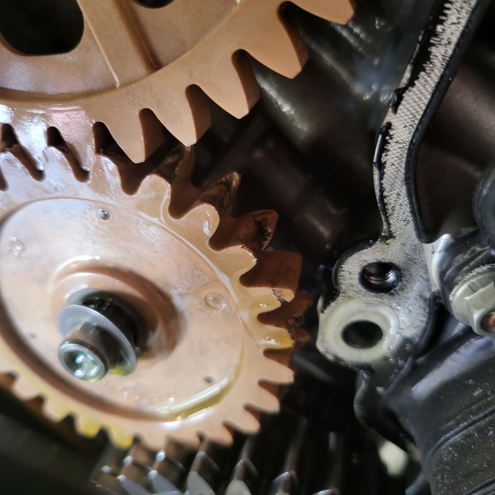

  2. Is there a metal replacement out there? I'd certainly replace with better if available--
  3. Yes there is, from ducati themselves. 20220203_153012.jpg 20220315_132923.jpg
  4. Fitted a 1299 water pump at the same time which has an extra locating dowel.
    Engine is a lot noisier with steel gears
  5. So--I did a cursory search on Ebay, and all I'm seeing are water pumps listed for both 899/1199/1299. Not sure if the pump assembly includes the driven metal gear as well.
    So, wondering if/how all models can share an identical water pump, especially if the 1299 has an extra locating dowel. Wouldn't that require a locating hole somewhere in the engine case?
    I'm new to this discussion (so ignorant on details) but VERY interested in this topic. If somebody has part numbers, I'd love to see them. I'm in the US but that shouldn't matter.

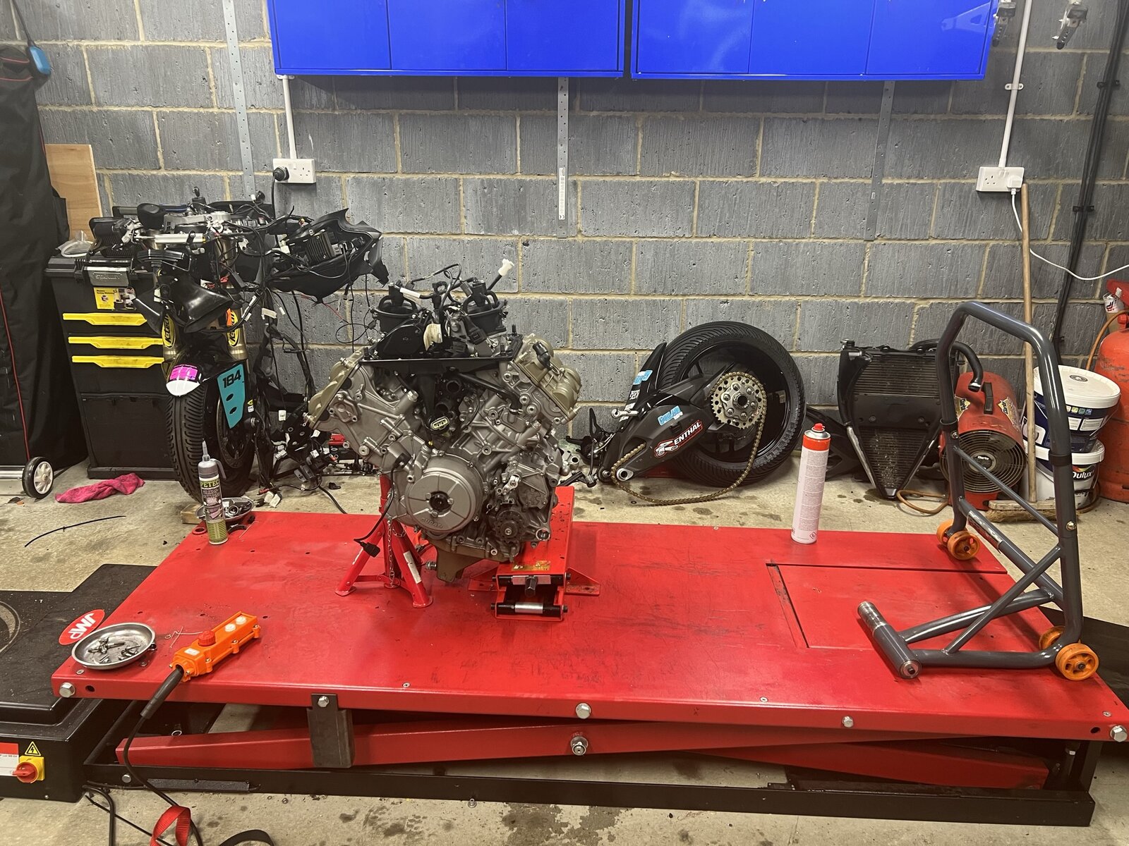

  8. So today I finally had the time to head south to DRR117’s place and pick up the new engine.
    Can’t thank him enough for holding on to it for me for a few month after promising 2 or 3 times to come for it but the was unable to because of work commitments but he’s been a pleasure to deal with and is a credit to the forum
    not had a chance to strip the old engine yet but I will at some point
    anyway , it’s on the bench and the rebuild has commenced, should be finished in the next few days ready to be stored for winter
    Hopefully get some more done tomorrow

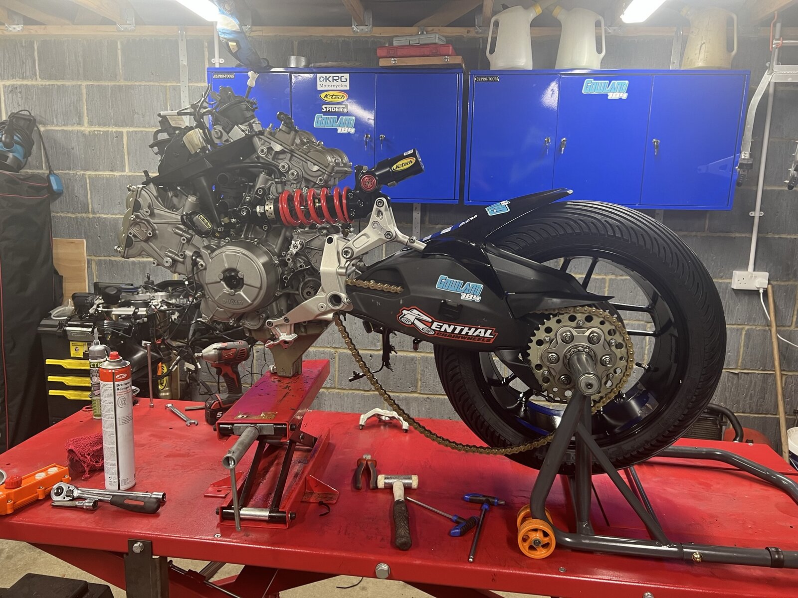

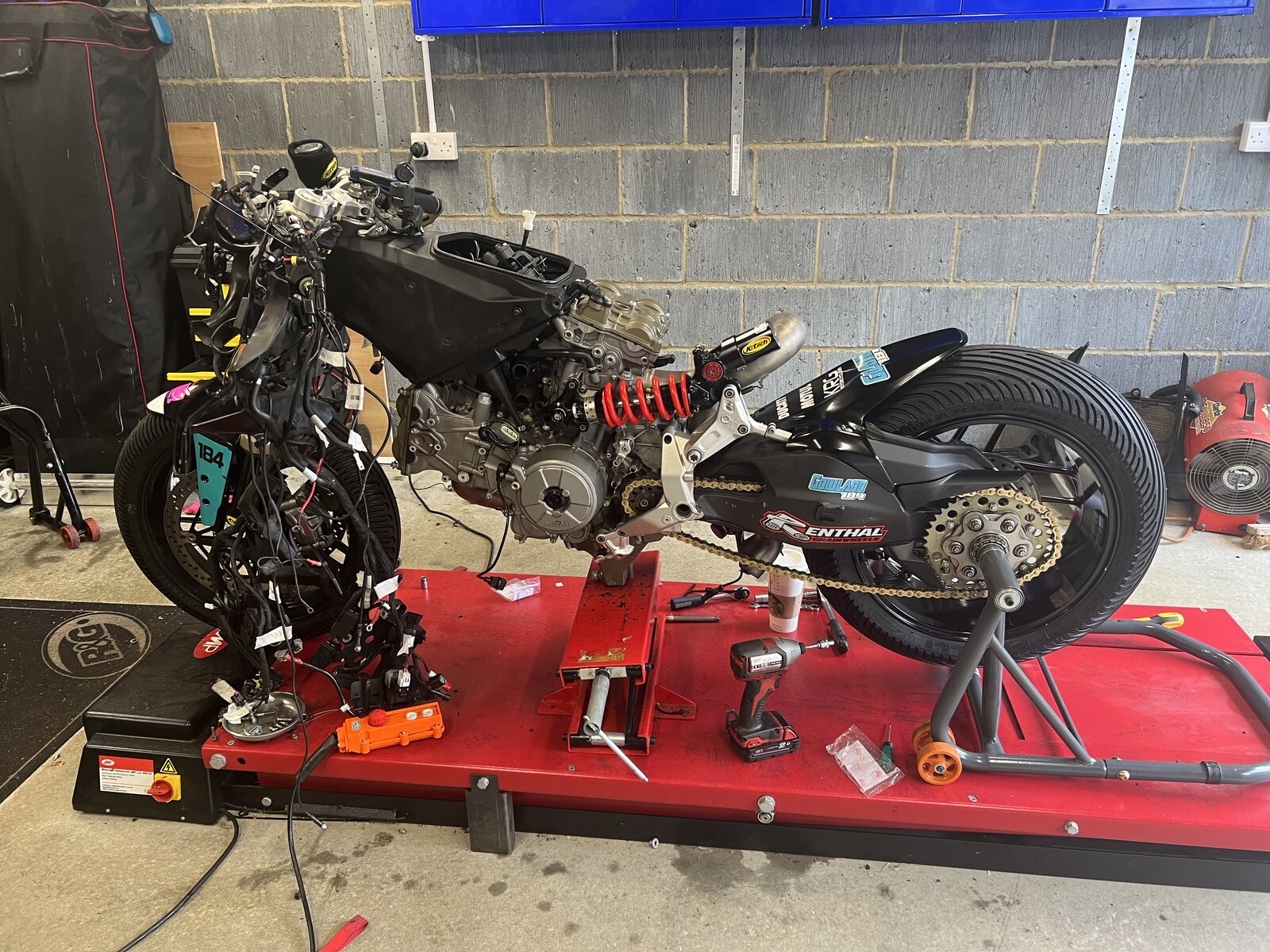

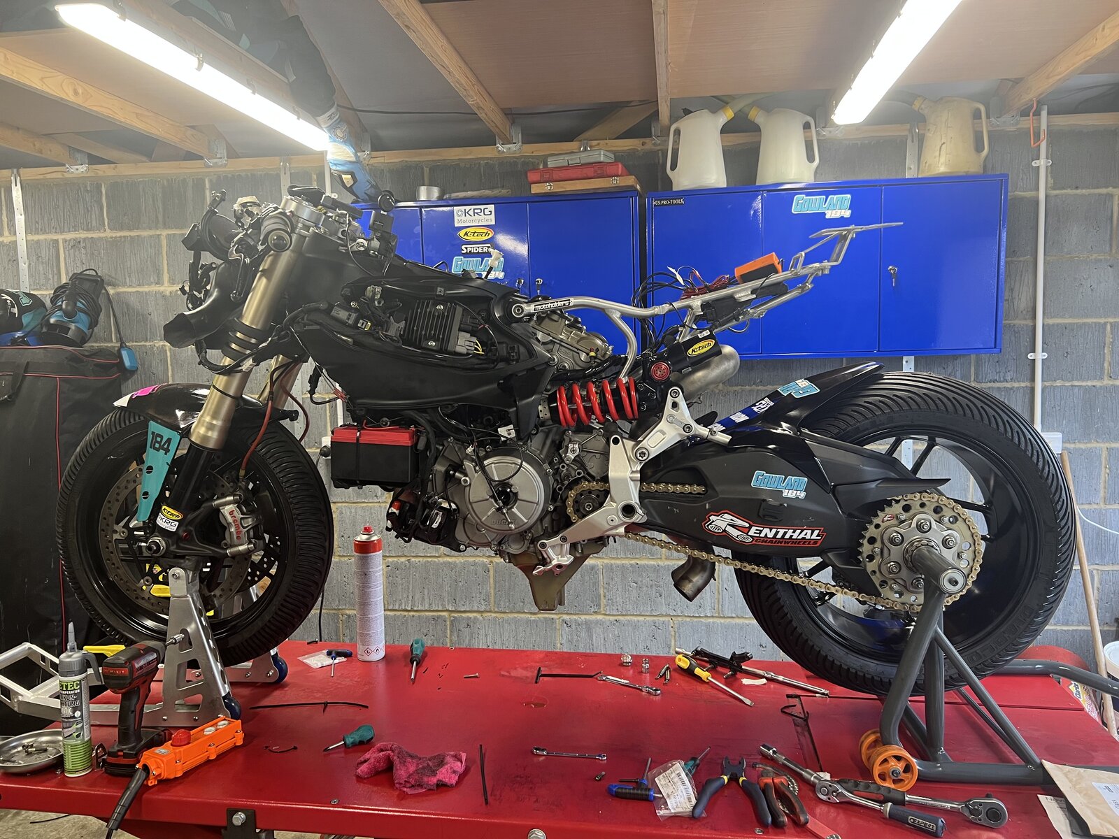

  11. We have something that now resembles a bike .
    That’s as far as I’ll be going today though as I want to clean the radiators and I need a sump plug before I can put the oil in it .
    Still need to tidy up the wiring and re torque everything but so far it’s looking good

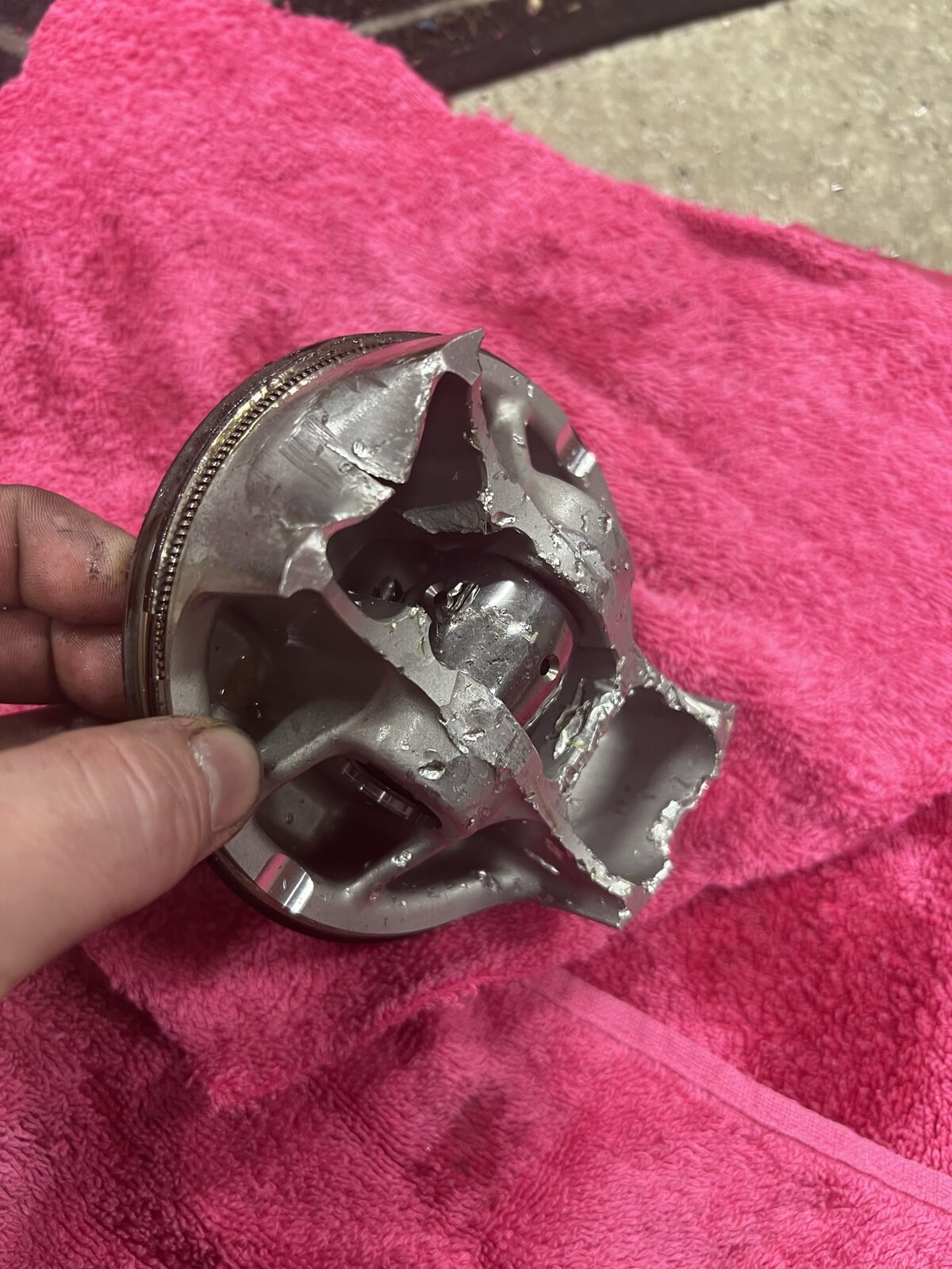

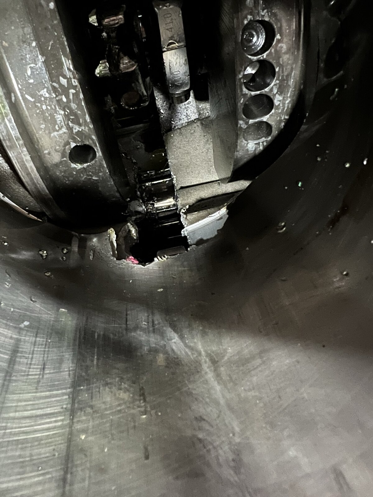

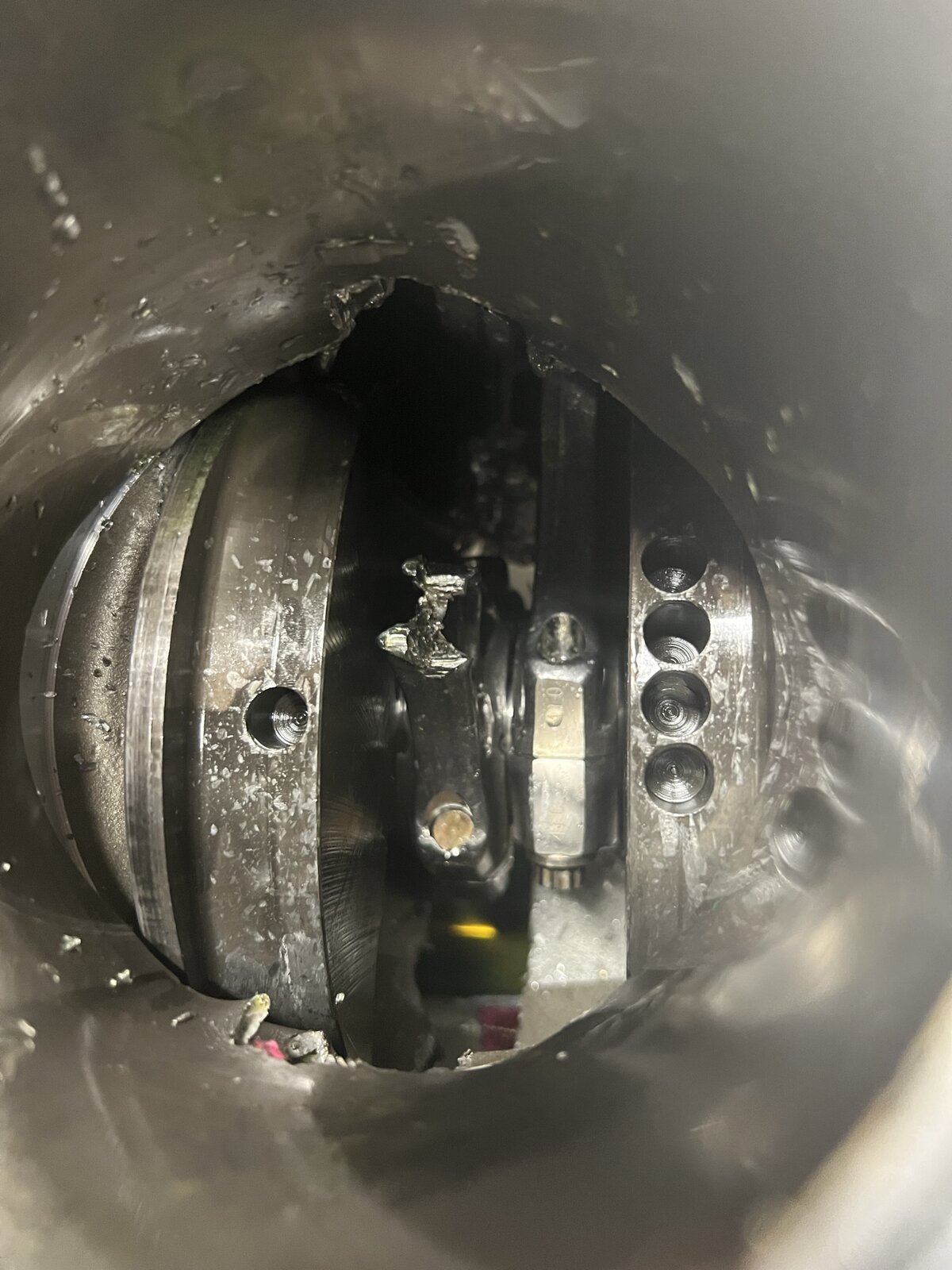

  13. So the bikes is back together and running sweet as a nut, just need to order an Oberon master cylinder then that’s it all done .
    my curiosity got the better of me tonight so decided to remove the vertical cylinder head from my old engine and as suspected it’s suffered from a snapped conrod. Well and truly obliterated, it’s punched 2 big holes in the crank case, wiped the oil pump out damaged the liner and piston.
    on the plus side though the cylinder heads are good and the gear box is good so I can salvage a few bits from it.

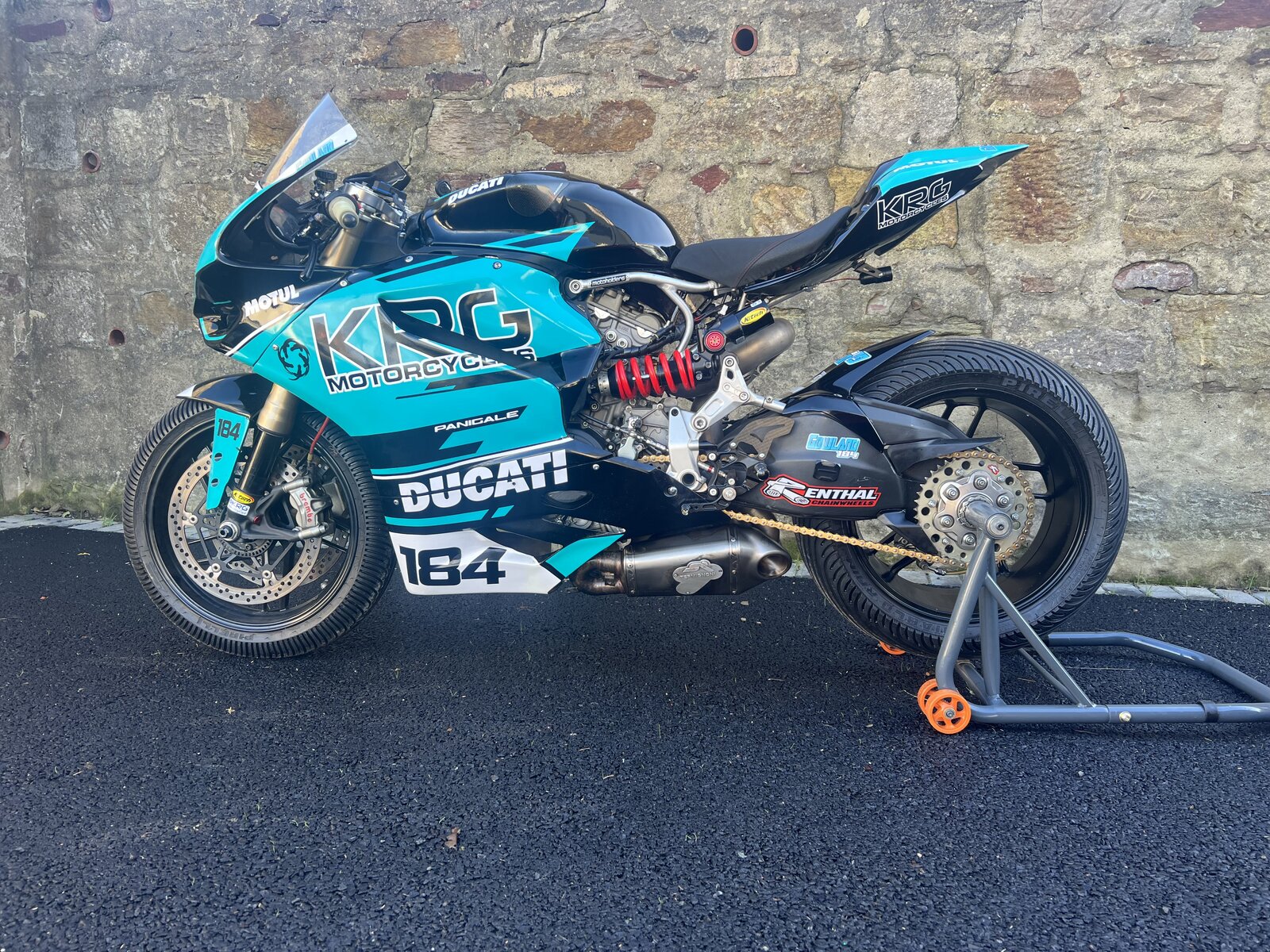

  14. We are back in business ….
    love this bike again
    • Like Like x 18
  15. you "clever old stick", and in such a short time. :upyeah:
  16. Thanks mate . It was built within a day really I was just he’d up by waiting on a few bits to be delivered
  17. well done mate
  18. bit easier to rebuild in track trim.
  19. Great job. I’m somewhat in awe.
